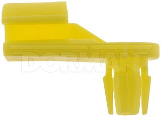

Not sure if '95's the same, but on the older Rangers there's a replacement plastic clip (# 75451) by Dorman in their "Help" series:
That part worked but didn't hold up too long before breaking (cheap plastic, I think).

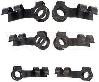

I looked around for an alternative, and decided to try using the old-school linkage clips, like these:
They worked fine and have held up for years now.
That's also a Dorman Help part, # 41016 (contains 3 sizes, LH and RH). Note that there's LH and RH versions; I used both versions to do the linkage rods on both sides.
Hope it helps, good luck!
