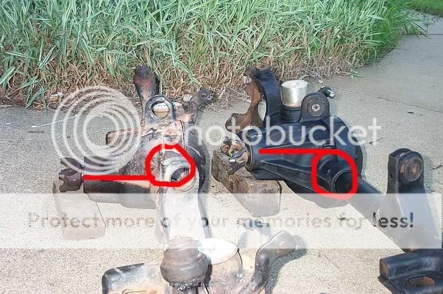

The '89 has the high-pinion non-CAD axle. That's the one to look for if you can find it.

CAD Problems:
The Dana 30 uses an axle disconnect system that is prone to failure. Often the vacuum hoses the activate the disconnect system will fall off or tear. Sometimes the vacuum motor won't have enough power to engage the sleeve when the gear lube in the disconnect housing gets gummed up. Another problem is that since only one axle is ever disconnected, an automatic locker or limited slip differential can cause problems with the axle and with handling. The drivers side axle is always spinning the differential.

whats the difference between low and high pinion?
i have a cad axle in rough shape.....pretty sure its 410 as its out of a 4cyl man cherokee.
