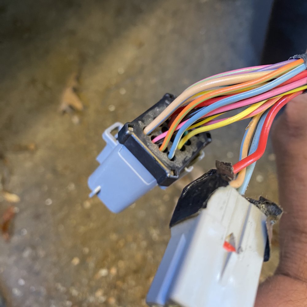

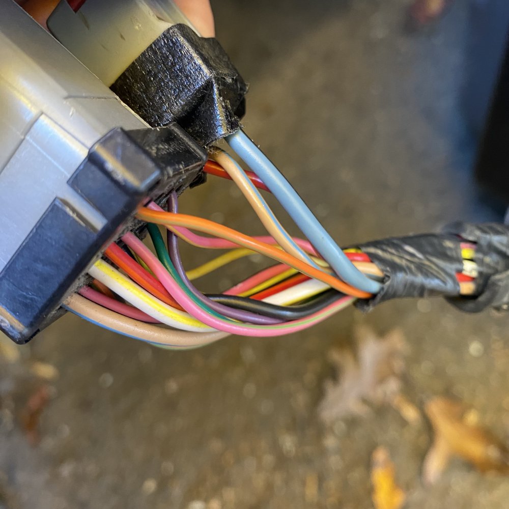

1999 3.0 4wd 5sp. Came upon a good deal for some power doors. Just need a little help. I found a few posts about this power swap with an especially detailed one on here. Unfortunately I don’t have the time to swap the whole harness. So, my ask is can some one direct me to a pin diagram for the door plugs? I’ve confirmed my base model only has the few-wire plugs and obviously the donor doors have a lot more wires. I also found some wiring info on some of the pins but not all. I suppose my goal is to repin my existing plug with just the minimum wires to work the power windows. I already have a pdl kit which I can wire inside the door. I don’t care about putting the windows up after I shut off the truck or even power mirrors. I’ve been hand cranking for too long and I need the power. Thanks in advance.

Are the power doors 1999 ranger? Here is the window wiring for a 1999 ranger.
Yes donor is 99 as well. Thank you. Much appreciated. If only I could read them. Wondering if there exists a pin diagram.
Can you go by wiring color? For example the power window diagram shows the window motor on the driver's side being fed with a white/black wire and a red wire. The pass side is fed with a yellow/red and a red/yellow. The first color is the main wire color and the second color is the stripe.
The power for both windows comes from a lightblue/black wire that feeds the window switch.
It seems the wire colors dont match the diagrams. Ex. The diagram starts with a lb/blk wire and the connector doesnt have a lb/blk wire.
Also no white wire. 🤷🏻‍♂️
