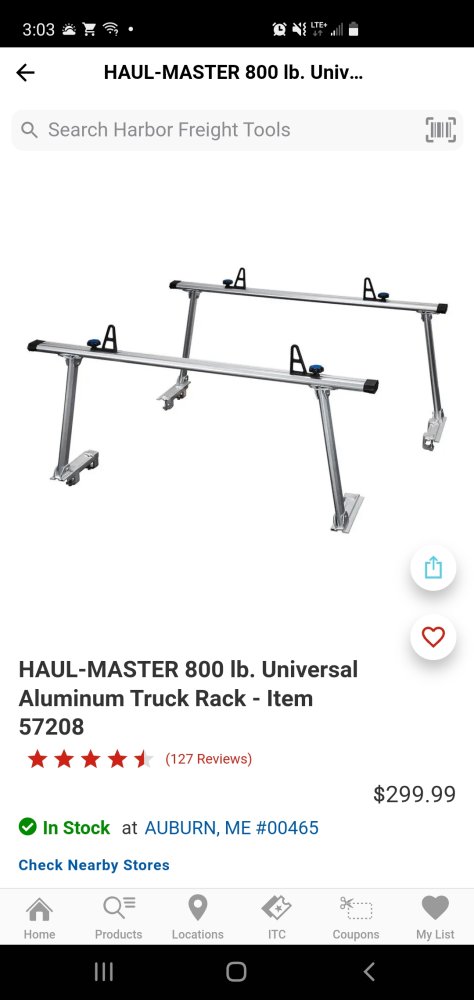

My uncle is giving me my grandfathers canoe, it's a bit of a big old bastard at 17 feet long.
I currently have no way of hauling it easily/reasonably. The cheapest most convenient option for new racks(I believe) would be to grab harbor freights 800lb aluminum universal units.
They're a little tall for the ranger, but can be cut down so the cross bars are at a reasonable height above the cab.
My issue is.. if I put the canoe up on the racks so it's somewhat even with the truck front-to-rear, only the back 3rd of the canoe would be supported.
My first thought was to just get one of those little foam pads to put on the roof, and the front of the canoe can just rest on that.. but the durability of the paint on these new trucks leaves a little to be desired.. I don't want to end up with a big raw spot after awhile. Mabey toss a microfiber towel under the foam pad?
I could also just load the thing more or less centered on the racks.. but then the canoe would stick 6-7 feet out behind the truck. It would be high enough to not really be a safety concern with tailgaters and stuff.. just a little awkward.
Thoughts?
When I build my headache rack for my truck I built it about an inch or two over the top of the cab. When I picked up the canoe, I put it on the top of that and the top of the tailgate. Hang a red flag off the back of the canoe. It's a 17' or 18' Grumman Aluminum job.

The higher the rack the better for carrying canoe. If you decide to cut, just cut the back so that the canoe is on an upward angle over the cab. My stock rack is low and I carry my canoe forward as much as possible to avoid hitting the cab. It's still very close. Use ratchet straps to hold the back and middle to the racks, and a rope at the front bumper to prevent the wind from pushing it sideways.
Another option is to put a 2x4 on the front rack to get the canoe lifted over the cab.
Anything 3' past the back bumper needs a red flag.

I'll leave them at a practical height above the cab for carrying the thing for sure, I just don't want them 8" above the roof lol which is about where they are on a new truck right out of the box

Short of the front bumper rack or RonD’s solution, I don’t think there is much of an option short of a bed rack with a cantilever over the cab.
If you do go the two rack in the bed route and put something up front. Strap the canoe on the bed racks on not up front or at the rear most rack and up front. You need to leave room for frame flex.
