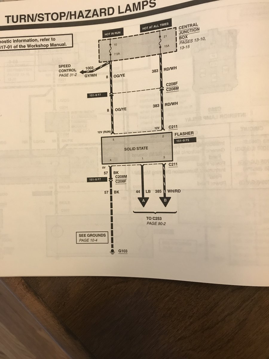

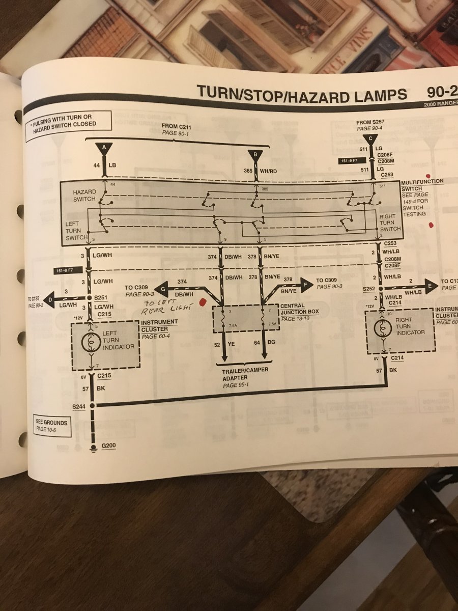

if if if your 2001 is the same as a 2000 the single flasher unit does all the flashing. then the multi function switch separates the turn signal and hazards.
from a 2000 manual.
2005 manuals show similar layout, flasher does all, switch separates them.
This is one of those times when the EVTM pays for itself.
