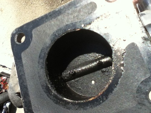

1) There is oil residue in the throttle body, the upper intake manifold and around the upper intake manifold gasket. Is this normal? Here's a pic of the throttle body:
Pretty grimy. I sprayed like a whole can of throttle body cleaner in it and the upper manifold and it looks much better. Not squeaky clean but better.

Oil residue in the TB is normal...it comes from the valve cover vent...not much you can do about it unless it becomes an oil burning issue...where too much is being blown up and sucked into the combustion...you can reroute the VC vent to a catch can with relative success, but it doesn't eliminate the main problem of blow-by. That is almost always a re-ring issue.

That TB is way past the normal amount of oil residue that reverts back to the TB. Check your PCV system carefully. Clean it off really well. Don't be afraid to use a rag with cleaner on it, more than just spraying it. Check the bore as well. It can effect how the engine runs by throwing the TPS off.
Well that's not good to hear. I brushed the intake manifold and throttle body and they're pretty clean. I don't know what all comprises the PCV system as yet but I'll look into it.

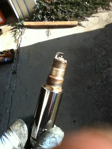

Regarding the plugs: apparently AWSTF32-F plugs that my manual calls for have been discontinued. I took back the Motorcraft AGSF32FEM because they thread all the way down where as mine look like this:
Research seems to suggest that the AG's replaced the AW'sand I should have just kept them. Will the fully threaded plugs thread in too far? I don't seem to have any other options.

Never seen a plug with such a short thread...
You might try measuring the depth of the plug hole...this can be a bit of a pita without the head off...but measure to the end of the threaded hole...the plug should stick out just past that for best spark...and go from there...but those may be the correct plugs for that engine...if that is what the part number indicates...just go with it and save yourself the headache...

The thing is I can't even find the AWSTF32F plugs anywhere. Motorcraft has a AWSF-32F listed on their website but without a picture I can't be sure if it's half threaded or not. I guess I could go to a Ford dealer to ask them but I really don't like dealerships.
The Advanced Auto near me had Autolite 764's but they are copper plugs and look pretty cheap. The Motorcraft SP432 seems to be fully threaded while the SP465 is only threaded halfway, but is again copper. Maybe it's not that big of a deal but I try not to downgrade when replacing parts.
...but then there's a dude in the comments section on Advanced stating he used the SP432 in his 2.5 Ranger so maybe the extra depth isn't that big of a deal or maybe Ford stopped using the half threaded ones because the full thread is a better design for this engine.

I think my truck is a 4th gen. I guess my concern with copper is longevity as I do not want to change the plugs in this thing more than I have to! I wish I knew what the OEM plugs looked like but the ones in there now are the 2nd set I believe. I haven't yet found a clear answer on the interwebs as to why the shorter design isn't made (as much) and whether the full thread versions are a suitable replacement.
