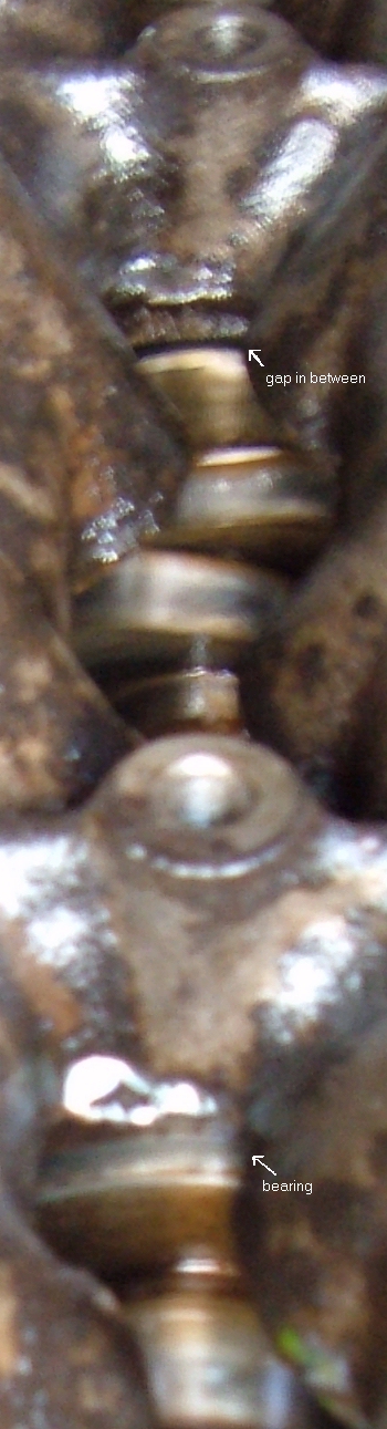

I have found where bearing has hailed from. In the pic you will see a darkened area pointed out, this is air between the cam and housing, where as on the lower portion of the pic it is white metal where indicated.

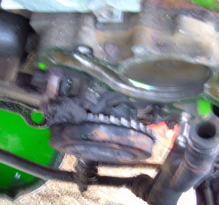

I have learned they don't build them like the old days any more. To pull this cam out it looks like you need to remove the front of the motor which is a casing instead of just the water pump / timing chain cover *&^%$^&)%$#.
This means removing the haronic balancer too. As I do not have the luxury of an impact gun this is proving to be a challange as there is no way to keep the motor from cranking while breaking the nut free. Of course it would help to know for certain if the balancer nut is left or right hand thread, anyone??? I attemped to run an allen key through one of the screw holes from the pully at the risk of messing with the thread within but found it butted against where the seal is located and so even if I threaded a long enough screw to accomidate this I was unable to bind against any where solid.

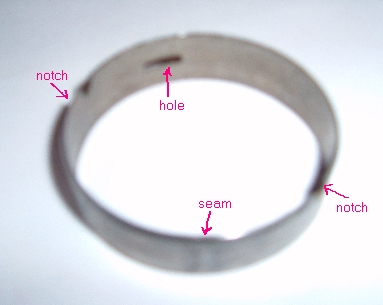

Here is what an intact 3.0 vulcan cam bearing looks like.
It fell off the end of the cam before i could see which way it was positioned. I read a post which if i remember said the hole goes at either 7 or 3 oclock but it was never confirmed nor was it confirmed if to look from the drivers seat or into the engine compartment standing in front of truck. There was no mention regarding the notches, would they go towards the front of the engine or the back I wonder? I suspect the back because I did not see the notches prior to removing cam.

To get the hormonic off, it was a right hand thread (thanks pal) and I put 2 pully bolts most the way back into thier threads side by each and used a 2 foot screw driver levered between the 2 screws while cranking center harmonic bolt with johnston bar.

deciphering bearing orientation...
I think in placing the so called oil feed hole at either 3 or 7 o’clock looking into the engine compartment from the front of the truck would have made the notches noticeable as per the pic prior to cam removal were the notches to have been positioned forward.
Rotating the bearing with the notches to the rear and the hole at 7 o’clock makes the notches horizontally parallel (seemingly logical) to each other and the hole slightly askew from the hole in the seat which is at 6 o’clock.
Now having said that, in scrutinizing the hole of the old bearings O.D. there is a circular washed looking area that is approximate in size to the holes in the seats which leads me to think that the post I read before but can't find again was erroneous, that the holes on both the seat and the bearing should be logically lined up, and so the notches too should be to the rear side or they would have been visible on first inspections. This orientation places the notches at one and seven o'clock which I conclude is purposeful to draw oil into the bearing on both the upward and downward motions of the cam as it rotates.
What say you fine folks to that train of thought?
Does the balancer have a pulley? If so, remove the bolts holding the pulley and run the bolts back into the balancer and use a prybar between two bolts to hold the balancer from moving.
