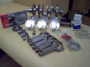

that looks like a rod bearing , you never know what they will look like when they come out , for example
mine:
did this meltdown damage the crankshaft?

Affirm to halves indeed, and the same for main bearings?? Not working this field every day i thought maybe things changed as they so often do, but this kit definatly shows dark metal halves.
