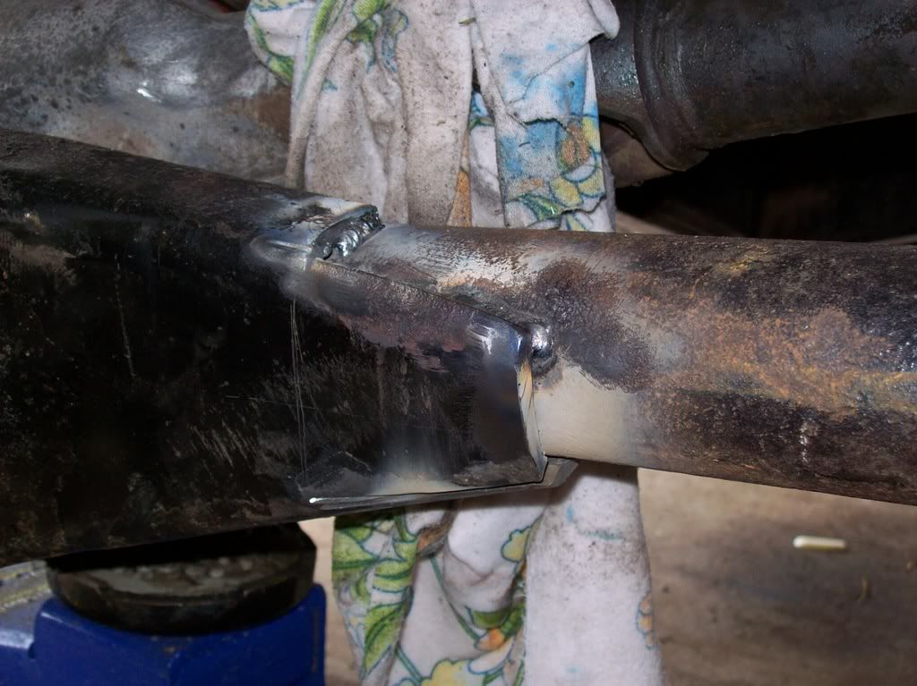

Ok, i never got back to this thread for a LONG time but if you follow this thread make sure you use bigger pipe then this i have some carnage pics of those bending a week after i built it, use at least a 2" diameter pipe heavy wall sched 80 i think i had sched 40 1.25" on that, also i redid how the pipe is connected to the stock radius arm WAY BETTER idea then what i put in the first place i didnt realize the stresses that actually go on the radius arm and now it is indestructable, if anyones interested i could post up what i had done

What I learned is to overlap onto the stock c-shape with your extending material lots. (eg todd + junkie) Especially more than I did.
my truck undergoing custom radius arm
this is where i socket welded my existing stock radius arm bolt into my 2 inch sched 80 pipe, i also if you look closley cut and squeezed a peice of the 2 in pipe and shoved it into the pipe for a tight fit for the radius arm bolt.

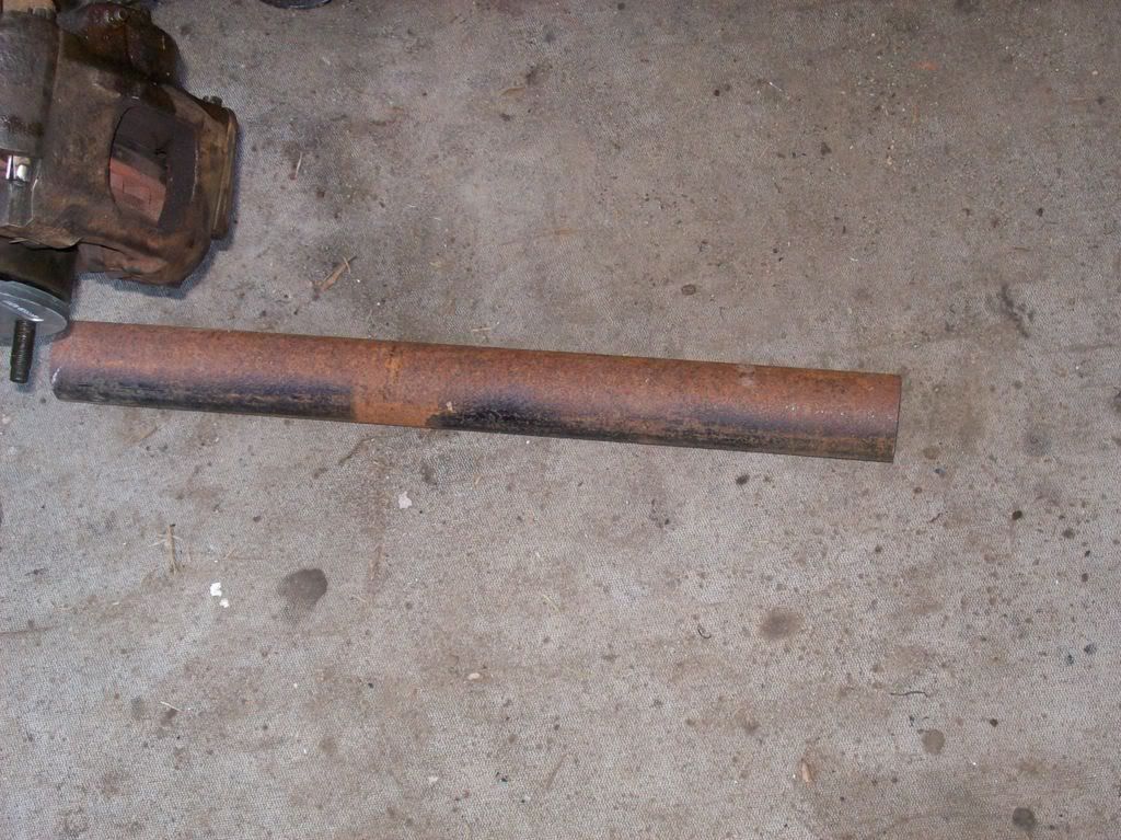

peice of pipe untouched
