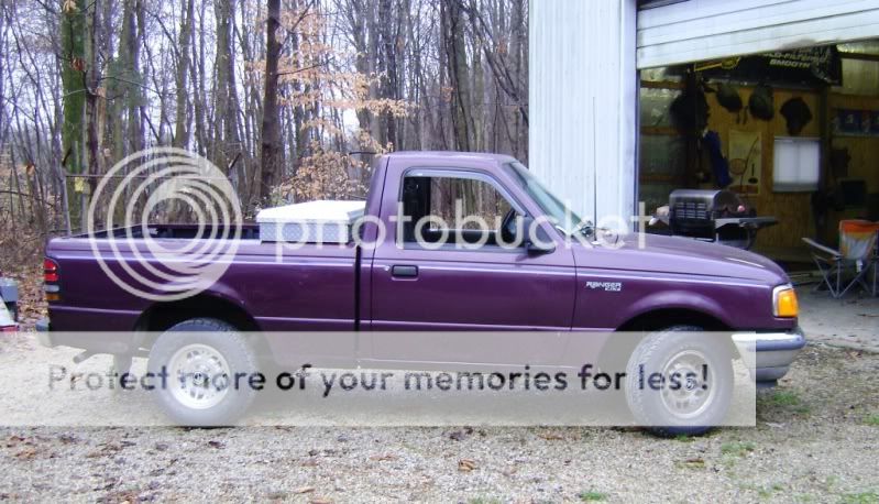

Here is a pic of his truck.

1. There is a member , i will search around to find him , he has a 1990 ranger that is all done up , it has a nice maroon color

EDIT : found the pics , third post down on this page http://www.therangerstation.com/forums/showthread.php?t=27193&page=9
Hey, thank you for all of the info. I don't know how I missed that parts page.
That one maroon truck you showed is one sharp truck. I would love to lift it at least 6" or so but he doesn't want to go that high, I think he's just wanting a little more aggressive look but nothing extreme which is why I figured the 2" lift and 30" tires would be about right.

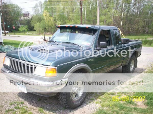

as for hood scoops
that was my 96 4x4 Off-Road with 31x11.50's
Awesome dude! That sounds like what I will do then. I have several junk yards around so I shouldn't have an issue finding one. Should I be looking for a certain year range for a direct bolt in?
I like the scoops, that pic makes the decision easy for me.
How much lift on that ranger in the pic?
look for a 93 and up ranger for your swap
that truck was never lifted , factory ride height
