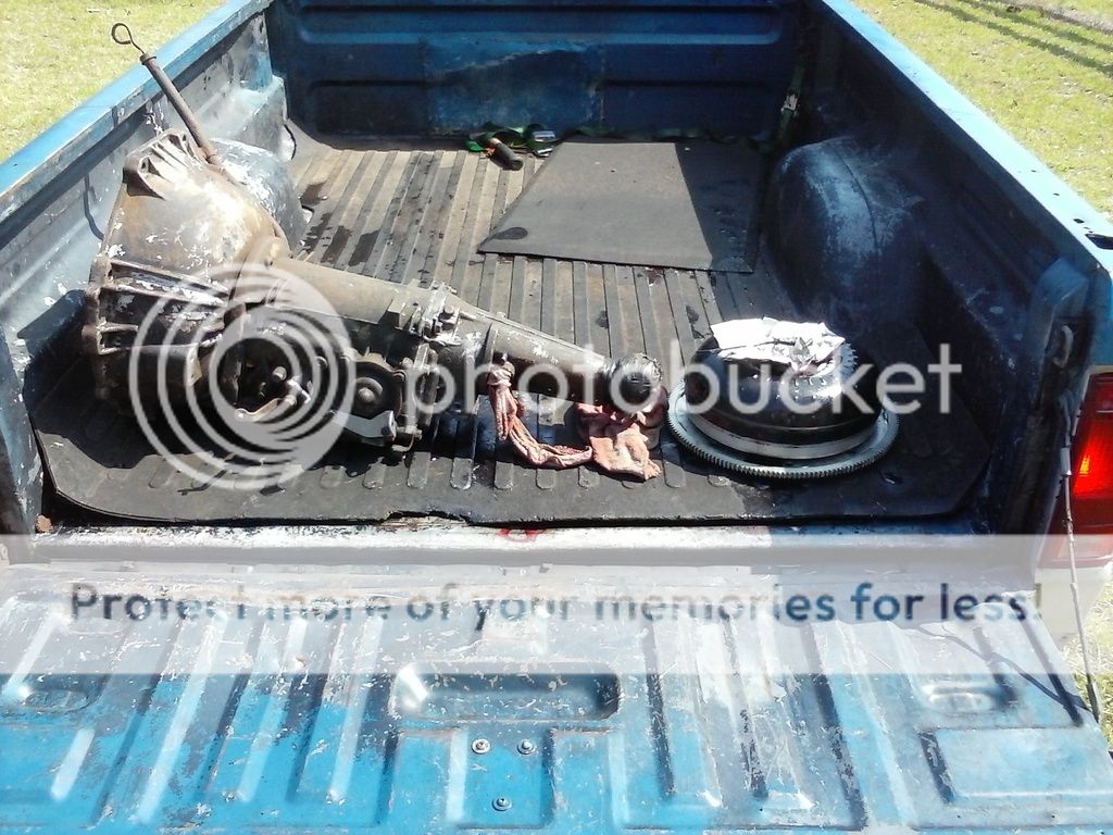

Finally got to work on putting the C4 with a 2500 stall torque converter today. the torsion bars crossmember was in my way of removing the fat pig FMX transmission
so we start cutting it out
now it is out of the way the tranny can be dropped
fat pig is out.
now I had a plate made out of 1/4 thick steel for the new brace for the crossmember and the C4 is installed
here is another view of the crossmember
OH YEAH I FORGOT THE STUPID YOKE FOR THE FMX IS TO FAT FOR THE C4 NOW HAVE TO HUNT A C4 YOKE
