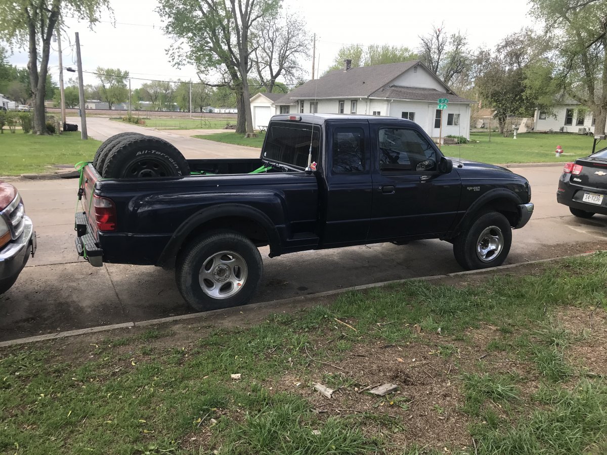

So I bought my truck with low miles for cheap I was replacing dash lights and I went to start it when I got don the lights would all come no turn over no click no nothing so I opened the hood and broke the starter relay top off to see if that would work and it did fired right up like it should it’s a 2000 but I can’t figure what wire broke I’m meaning color because I know the truck had a lot of wiring thrown together by the old owner and I’m wondering which wire that goes from the ignition to relay under the hood and this is in the fuse box under the hood anyone want to help a feller out
