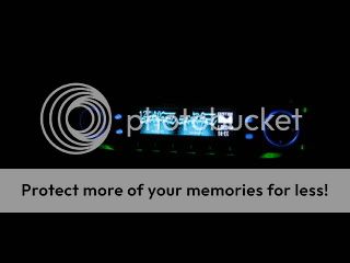

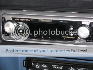

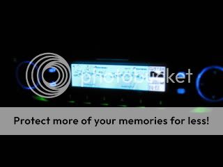

but anyways back to the problem the display at a regular interval of about 20secs will get alot brighter for 20 secs and then back to normal i can deal with it during the day but long drives at night are killer.
off

on bright

Do you have your Illumination wire connected? Seems to me like an internal problem, the contrast/display may be failing.
disconnect the illuminatio wire from the back all that controls is when your light go on the stereo dims if its hooked up, may just be that.
Common problem for the "EL" display to fail.....

every pioneer ive owned with the organic el display did that, (deh6600,7600,80) ive heard theres a setting to disable it but it never bothered me. but no theres nothing wrong with your head unit
Not sure if you resolved this yet or not, but I have a pioneer deck as well. When it is first hooked up, or in your case, when you put a new battery in and it resets to factory defaults, it has a demo mode and what they call a 'reverse mode.' The reverse mode is what you are looking for. Basically, the black space on the LCD turns to the green and the green turns to the black, and it does it every 15-20 seconds. Look at the link someone else posted for the manual and check the index for 'reverse mode.' On mine, it was a simple setting change in the menu to shut it off.
