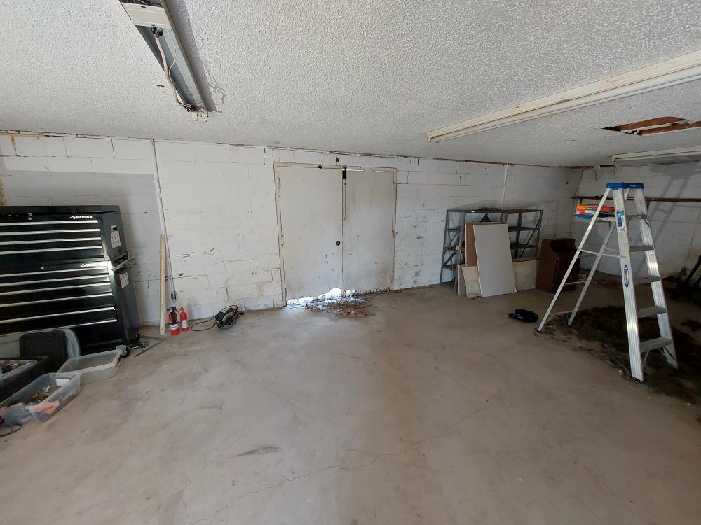

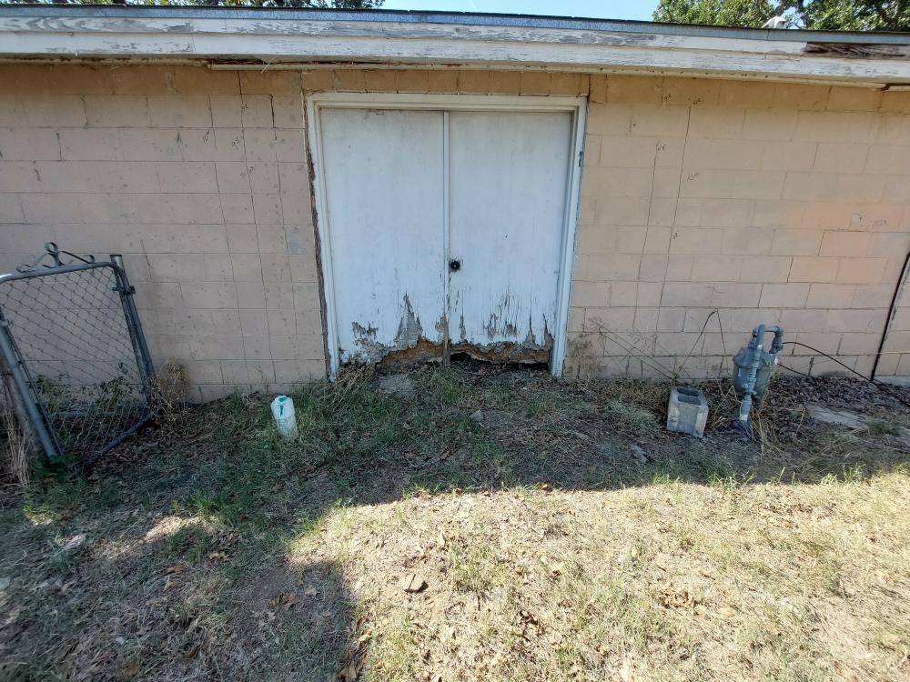

Remember a year ago when I was talking about cutting out this door opening and enlarging it so I could use the building as a garage?
I let life get in the way but I'm back at it.
I can't wait to get this done and get this area cleaned up.

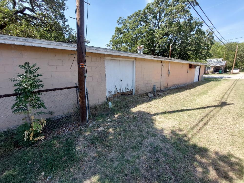

The alley isn't that wide and I found that pulling up to the door and swinging the truck in could be a challenge, but I found that backing in is going to make it easier to get in and out.

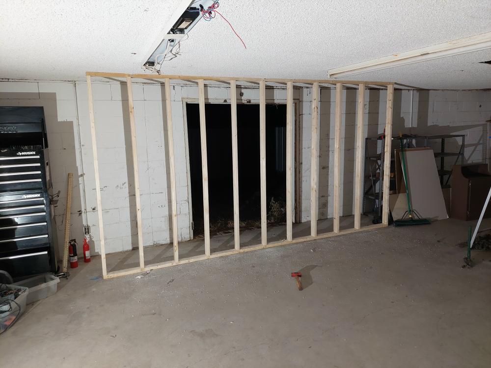

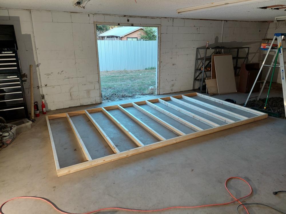

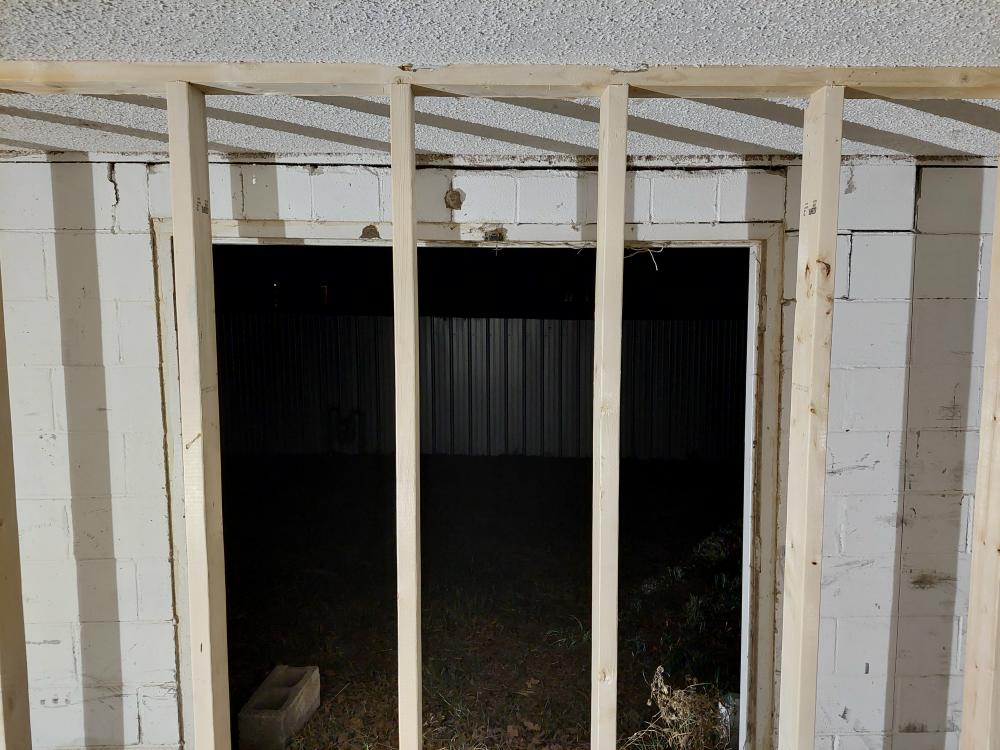

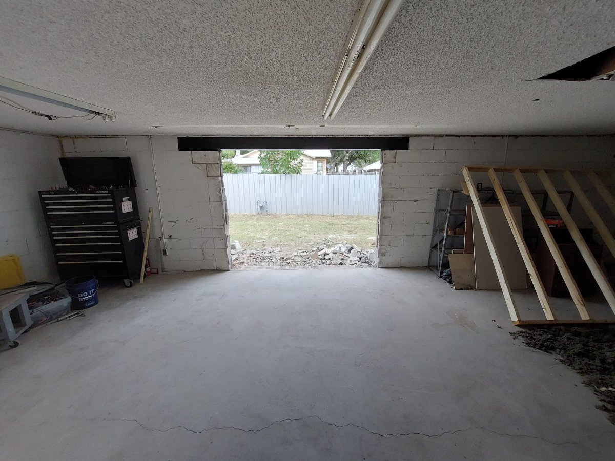

I created a wall to brace up the ceiling so I can start cutting out the cinderblock wall. The wall is 14-feet wide. I bought (2) 2x4x16's because they didn't have any 14's, and then cut them down to 14.
I made it a 1/2-inch taller than the floor to ceiling height. Getting this thing wedged in there by myself was not fun.
Tomorrow I cut out the wall and build and install a new header.

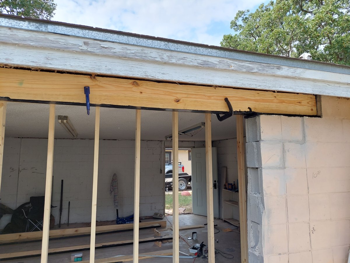

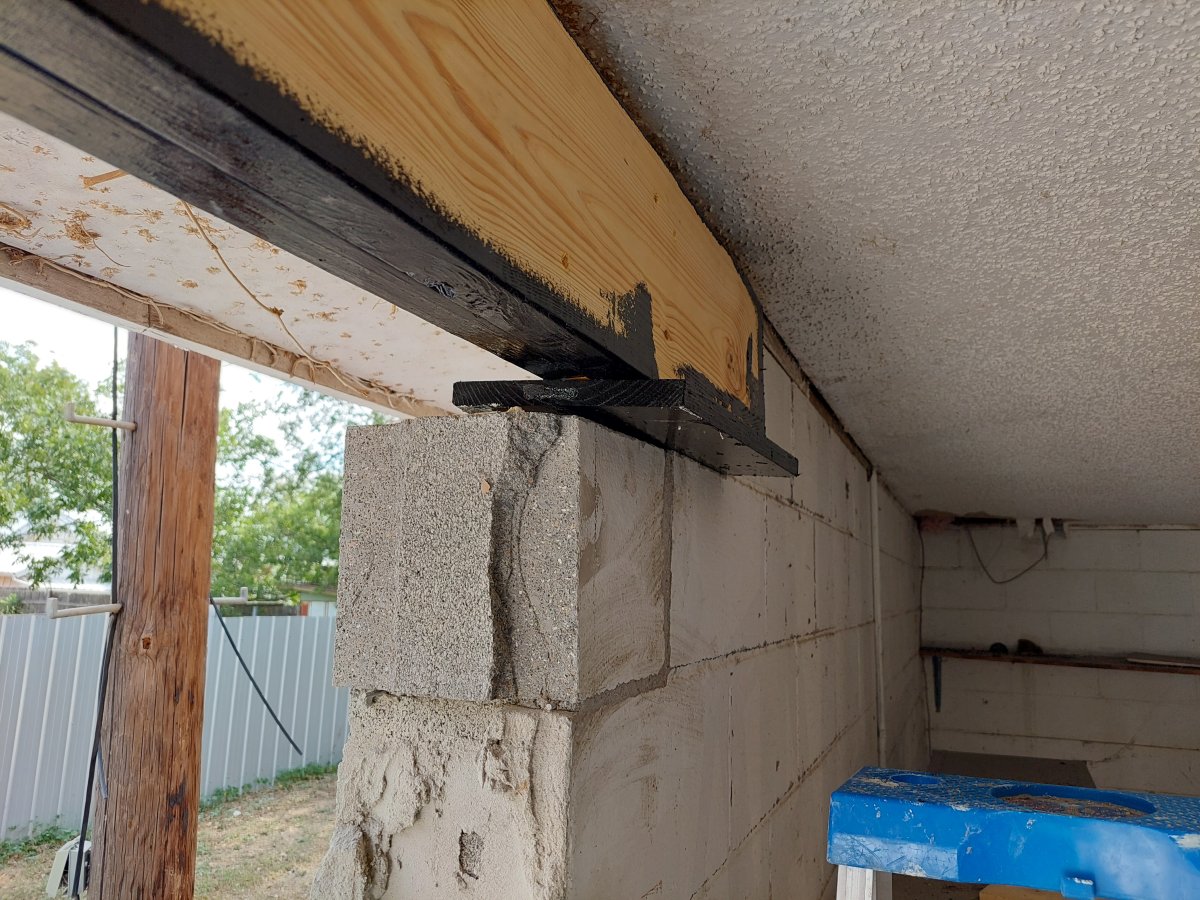

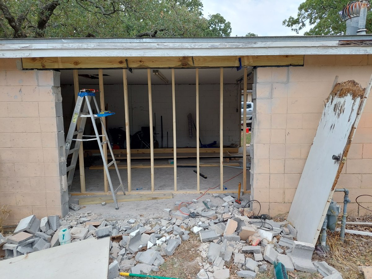

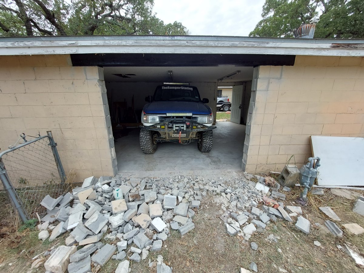

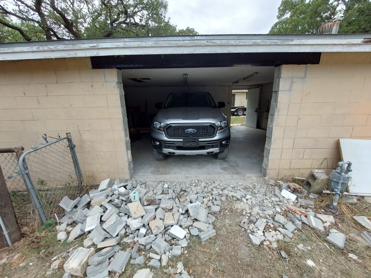

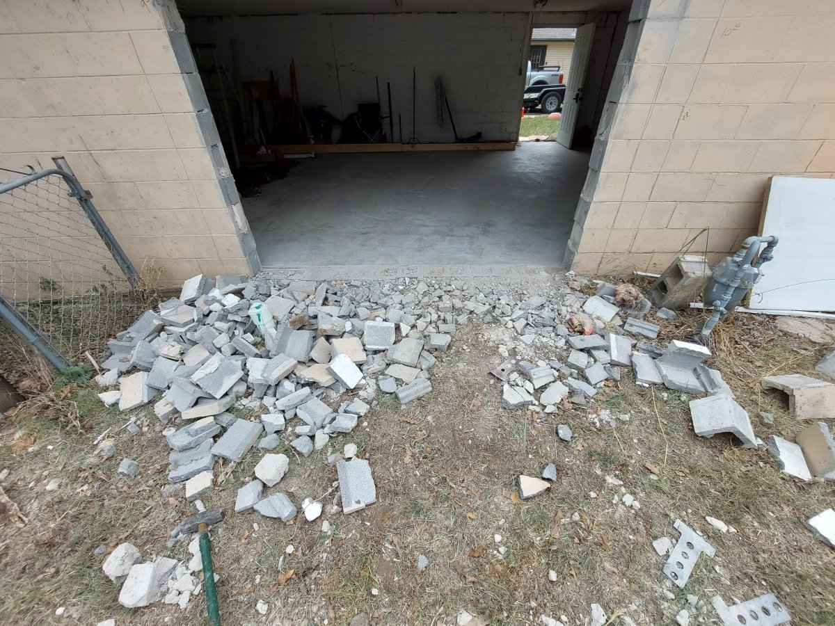

I got the wall cut out and the header in. I glued and screwed (2) 2x8x12's together and then attached a 1x on the bottom. Painted it with oil base paint, and put it up on the blocks. I had to reset (3) of the blocks with new mortar. Then I glued and screwed (3) more 2x8x12's to them. The one on the exterior is pressure treated.
I ended up with a 8'9" rough opening. I still need to clean up the edges of the block and trim it with wood. If I do 2x's it should leave me with a 8'6" opening and 1x's will give me a 8'7.5" opening.
Now I need an apron outside of the door, and I need to cut down the sewer cleanout so it's just below the apron so I dont hit it. Also need to do something with the busted block. I was wondering if I could use them as part of the apron and then fill in on top of it with something else.

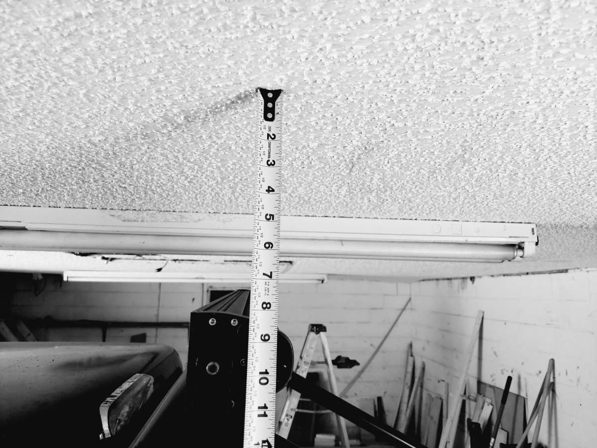

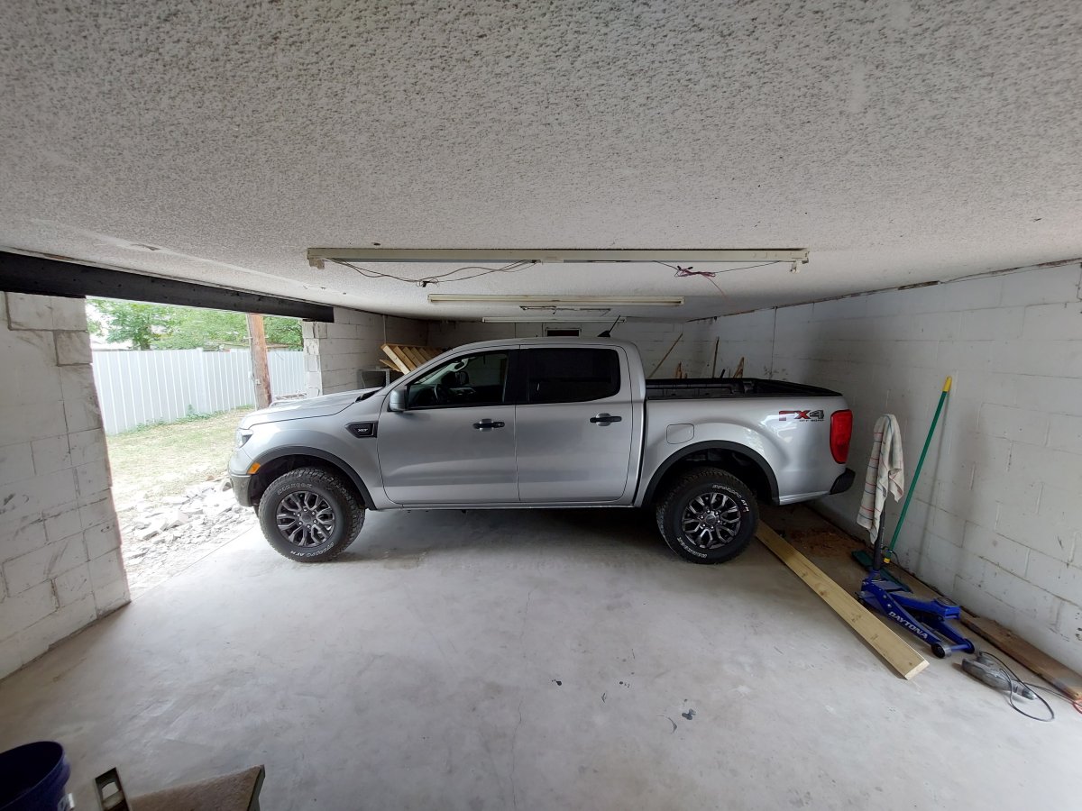

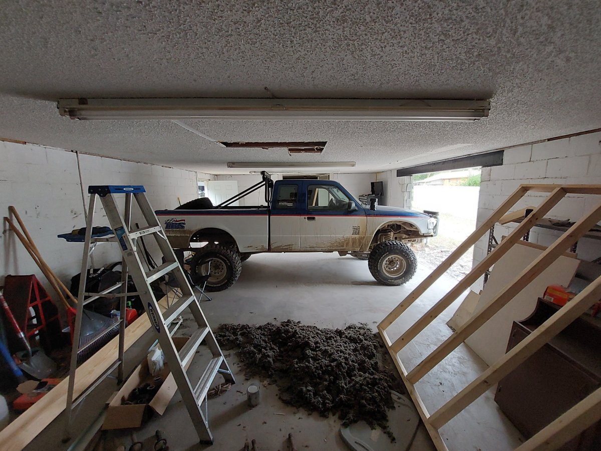

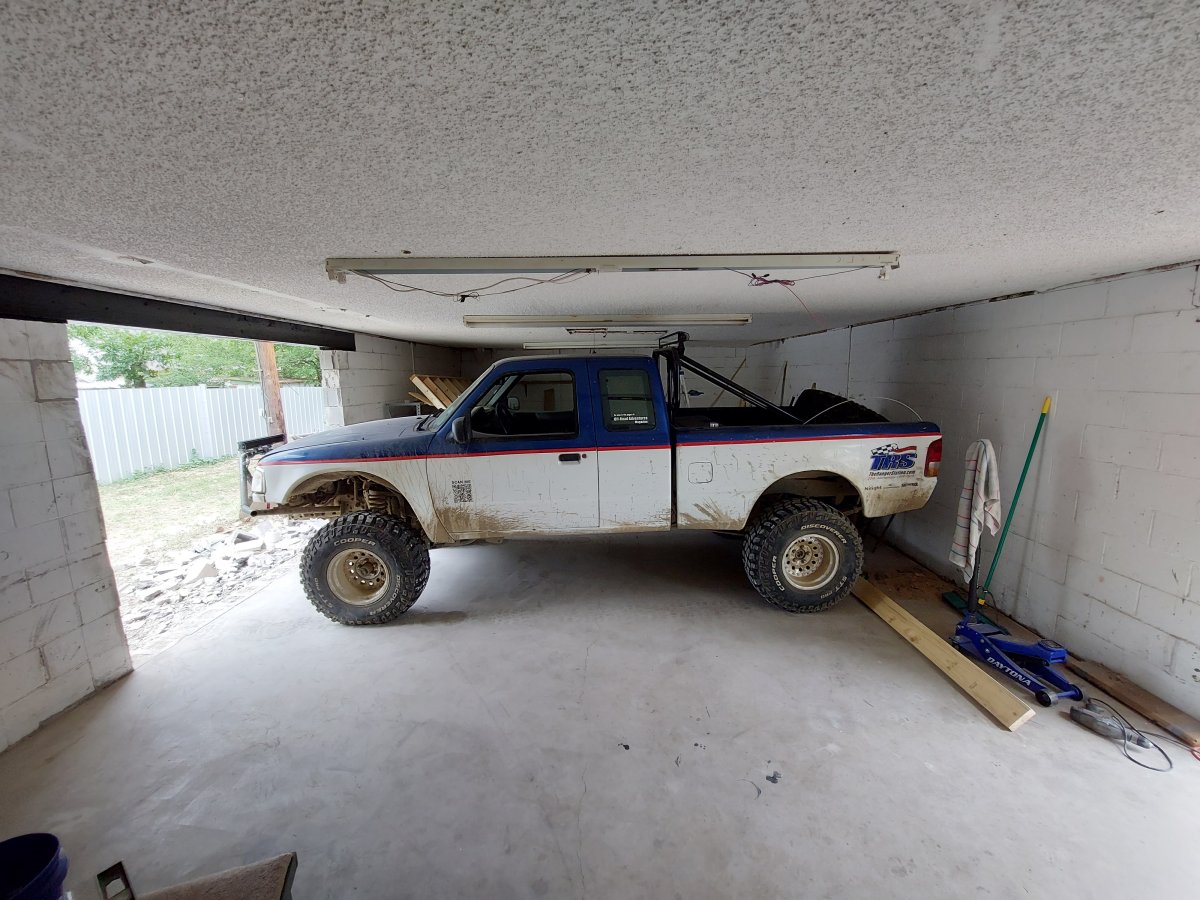

I also measured 8-inches of clearance between the lightbar of TRS-2 and the ceiling. If I set a new rafter on top of the old on and remove the old one, it should give me 13-inches of clearance to jack the truck up.
