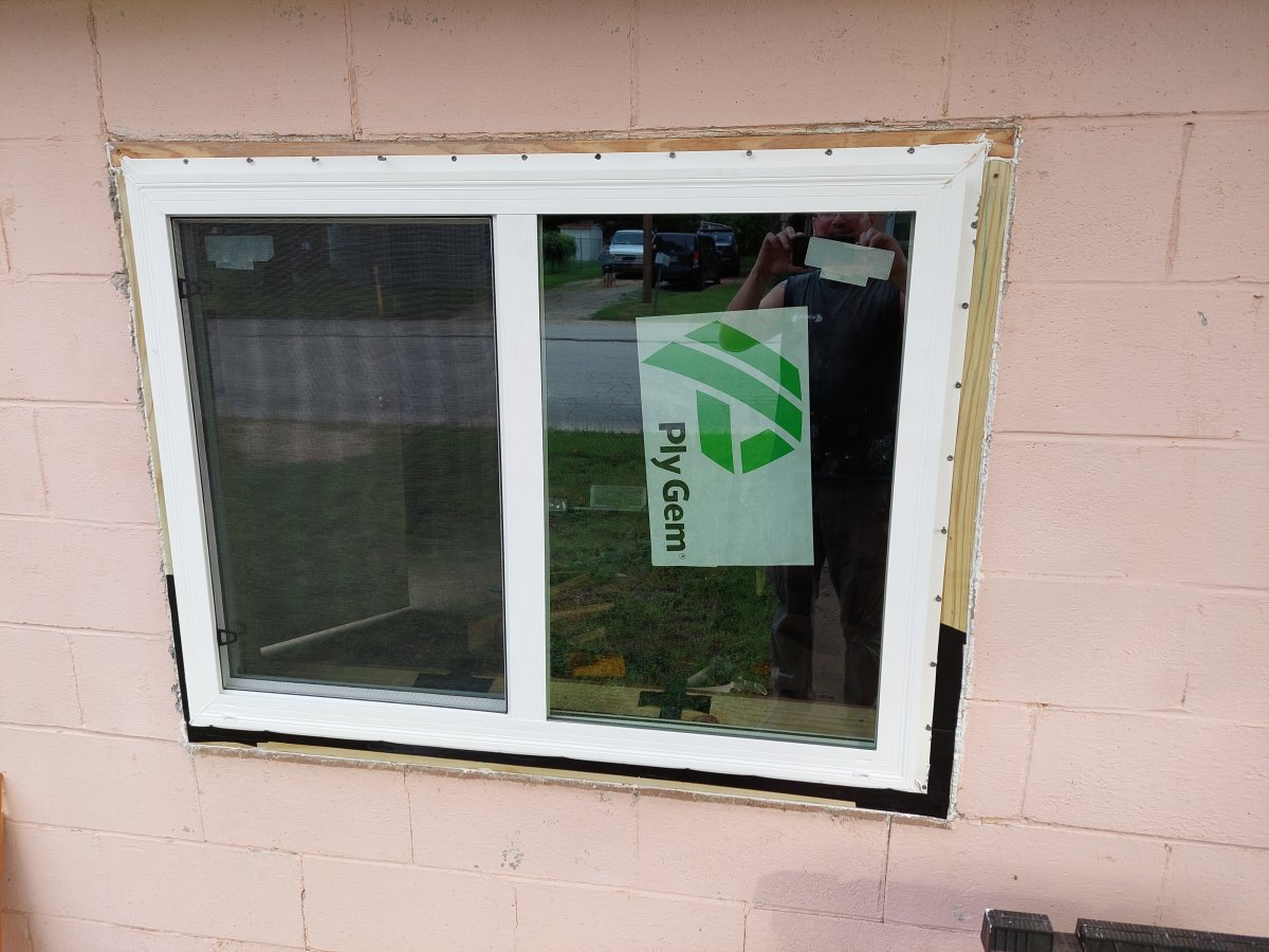

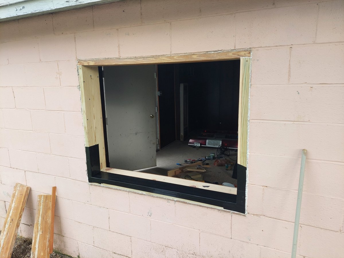

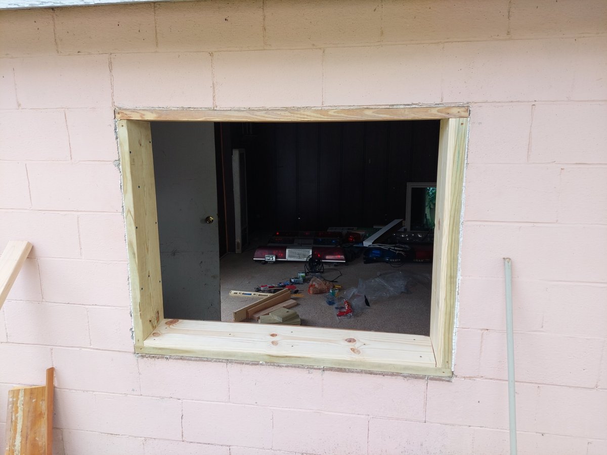

My Window Project:
I removed the old pane of glass, and then all of the wood except that 2x8 at the top. I used 2x4's running from the ground up to that 2x4 to support it when I removed the 2x8's on the side. I put in new treated 2x8's, and then added a 1x8 along the bottom and the right side to give me the opening I needed. The window is level and plum with at least 3/16" gap all the way around it. I haven't decided if I wanted to spray any window foam in that gap, or leave it open so there's no pressure on the window frame. The window slides open and closed nice and smoothly.
I didn't take a picture, but I covered the sides and top of the window fin with the black flashing tape. I didn't put the tape over the bottom fin, but I did add a strip to cover the exposed part of that 2x. I also applied window calk to the back of the fin before I mounted it.
One it was mounted and flashed I trimmed it with 2x4's. I painted the backside of the 2x4's to help protect them before I mounted them. I also used black window calk around the trim when I was done.

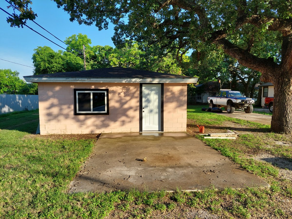

The whole building looks at least 10% better now.
My neighbor asked me if I was going to rent the building out. 🤷‍♂️:stop:

That really looks good. Nice job!

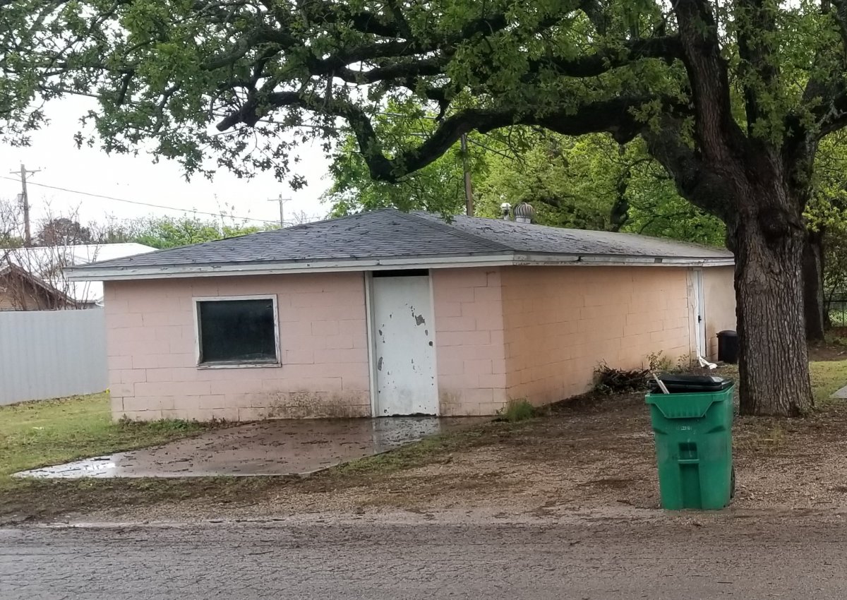

After reading through this thread and seeing what you're going through with your shop I can't help but think I'm going the right route with mine. I have a similar building as you, though not as big, all cinderblock on a concrete pad. I considered for a while rehabbing it, but between the roof needing to be replaced, not having electric and barely having enough room to work in (14' wide from outside walls.) I'm still in the planning phases, but plan on leveling it, keeping the existing slab to use as a driveway for the new shop a 24'x41' steel building slightly further back on the property.

Nice work, looks great. Looking forward to seeing how the new garage door project comes out.
There goes the neighborhood...:D
Looks way more than 10% better. Nice work.

Looks good. There is low pressure foam meant for windows. It will compress and expand. Use that or go old style with fiberglass. You taped the window correctly so shouldn't have problems either way.
I got a can of that foam, I just haven't used it on the window. I put some around the new door though.
