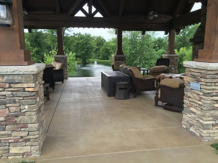

But with just a little bit more effort, you could transform it from that to this. And that's where we could have the cookout after the roof raising.
