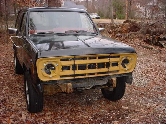

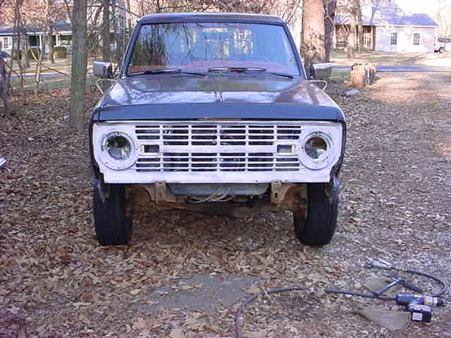

so here is a pic of my '84 wih the '66 grille. I first used the Bronco to size a '61 F100 grille, which is going on my Ranger. But now its full steam ahead on the '66 grille. This is just at te beginning stages. It will look perfect and a clean install when I'm done. It will have finished edges where it meets the fenders. Here also is the '61 grille.

How much of the yellow grill is custom and how much of it just fit? It really looks pretty sharp.
The yellow grille is the '61 F100. I sectioned 7 inches from both sides for a total of 14 inches. You see how it fits after that. I also took a cut in the middle top area, to flatten the profile some. Its going in my '89 Ranger. The
'66 Bronco grille is working out well. I've done a bit more work, buts its not finished yet . . too many projects.
