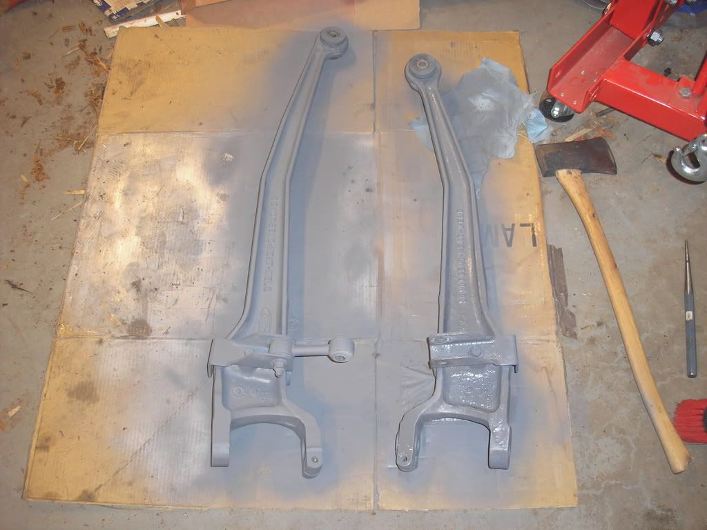

I just got the I-beams painted red today, they need to dry for a day before I put on the clear. I'll take pics of it when they are done.
Here's the painted I-beams. I know that the paint won't last, but I figured that it will look good at least once.............

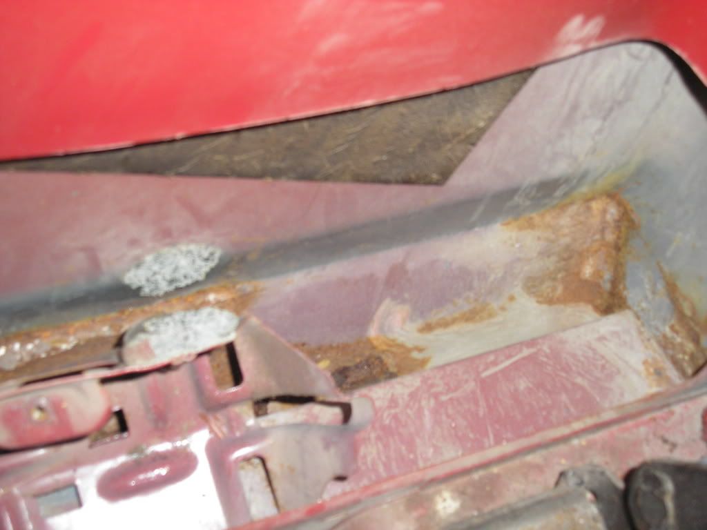

I got the front put together with 4.0 springs and all new poly's. Man, the front is super stiff! Next is tackling a rust hole on the passenger-side kick panel. I used the air body saw(GET ONE, THESE WORK FANTASTIC!!!) and hacked a good sized hole in the panel.
It's been -30 degrees up here for a while now, so work is slow. When the patch is complete, then it's time to install the motor..................

i have to say though half ass detail is worse then no detail in my opine. beams just dont look right. the por 15 has not panned out too well for me either with what i have tested with it, but it does work for most stuff if it is dry. i think there was water and salt still trapped inbetween the members i used it on and they kept rotting till they failed....wouldnt have known from the outside it was still rotting.

I am not a fan of lift kits on 2wd's, but the body lift is for clearance issues and it makes the truck look "normal". It looked squatted before, but it looks a lot better now.
I don't expect the paint on the beams to last too long, just wanted to see how it would look.
