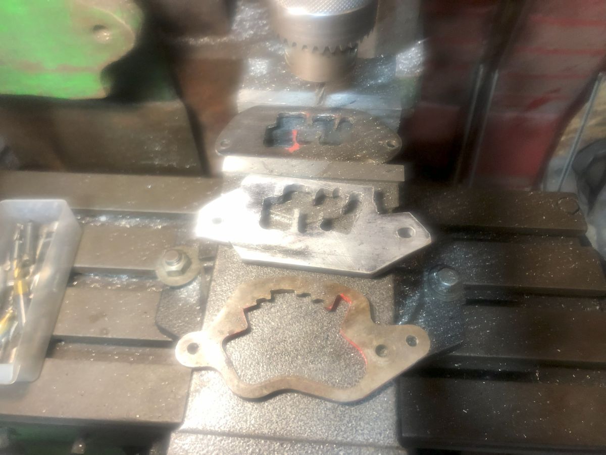

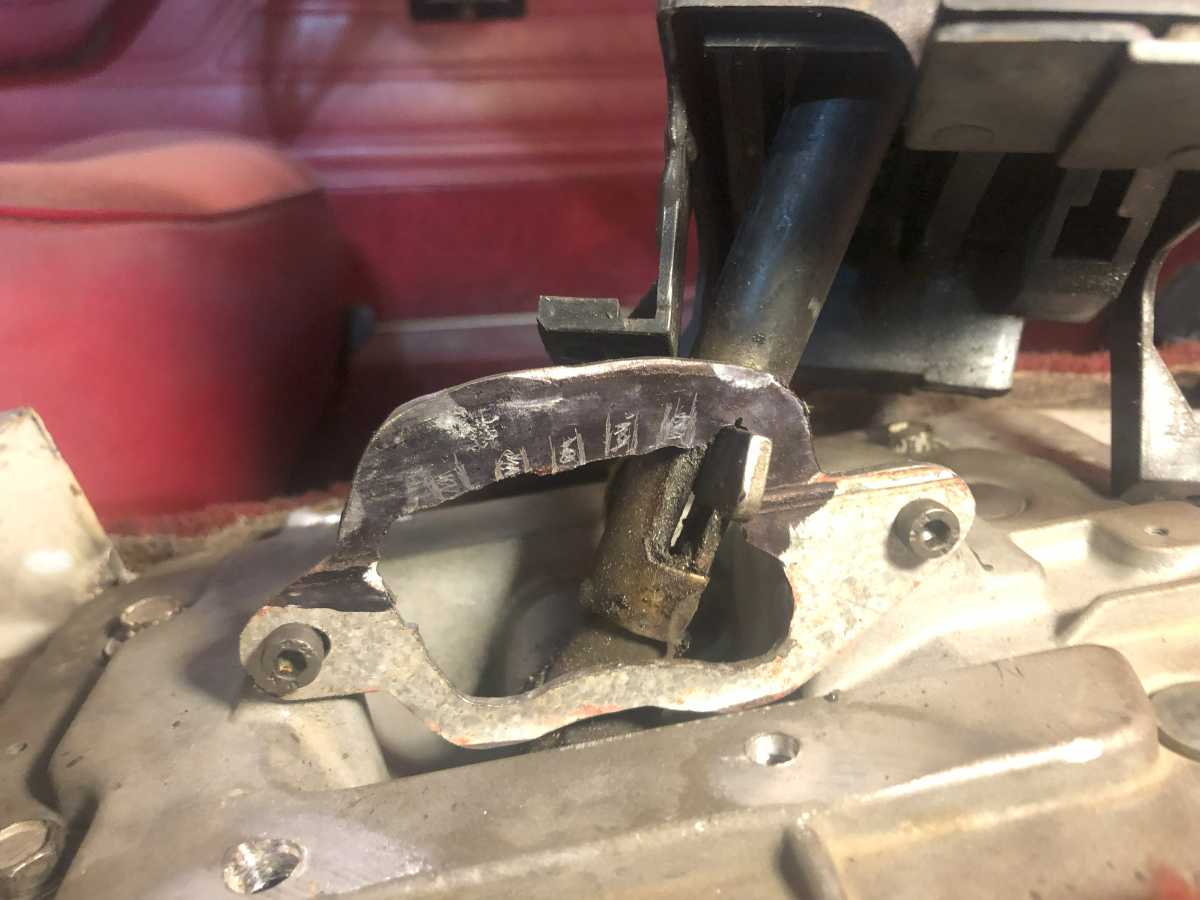

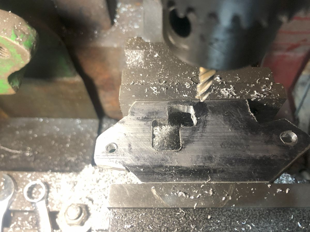

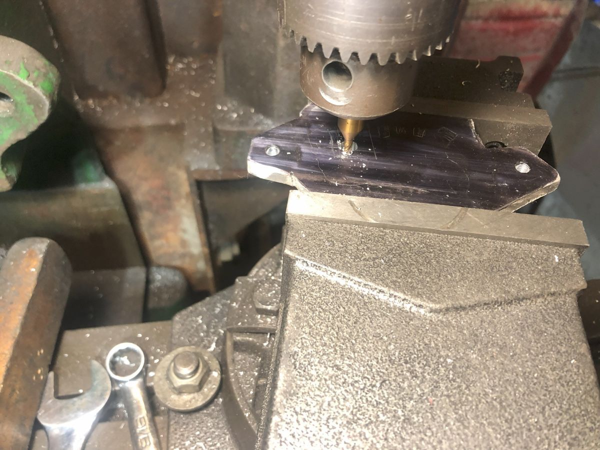

Working on the race car now, used the milling machine to make a new shift gate so I can only go 1-2 then 2-3 etc. Button in 1-2 then let go of the shifter button for 2-3, button back in to get neutral, etc
