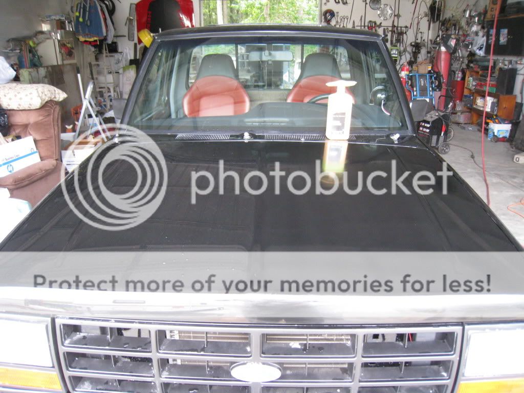

Wash area to be sanded and buffed.

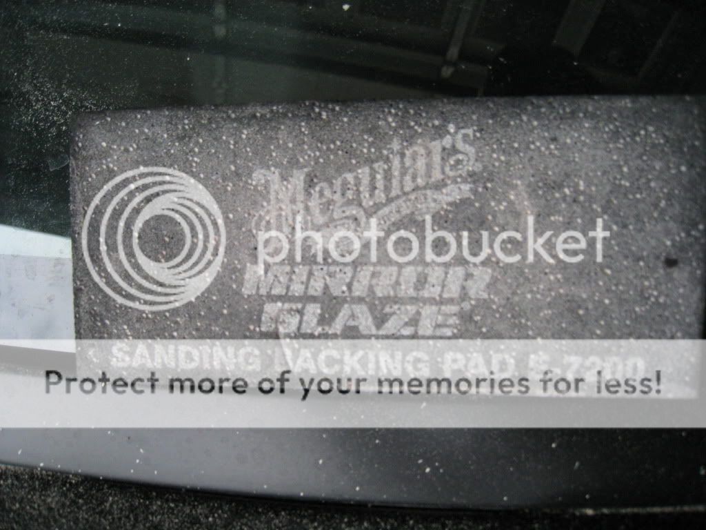

Here is an example of the sanding pad.
Wrap the paper around the pad. Spray the paper with water to rinse off any dirt or grit..
keep the area you are sanding wet and hold the sanding pad flat while sanding.

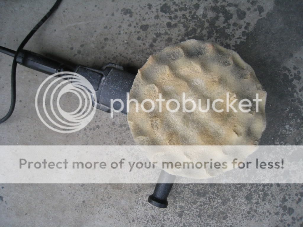

Take your time and practice. Keep the buffer flat and move slow.

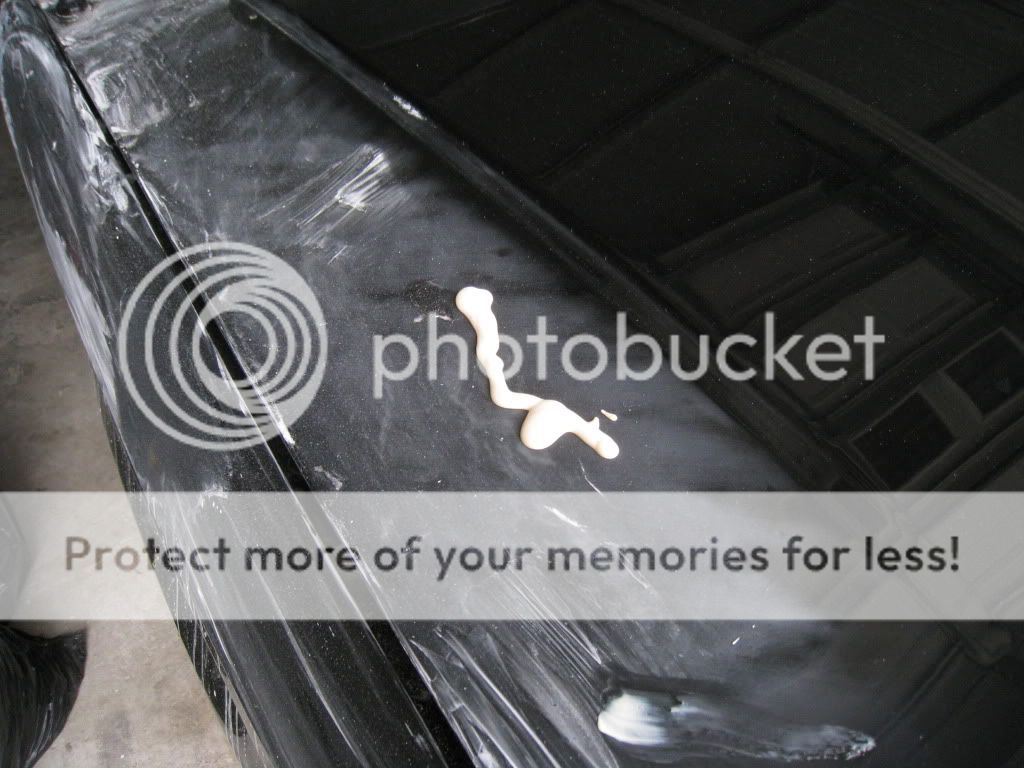

Use the compound. Keep the buffer flat!

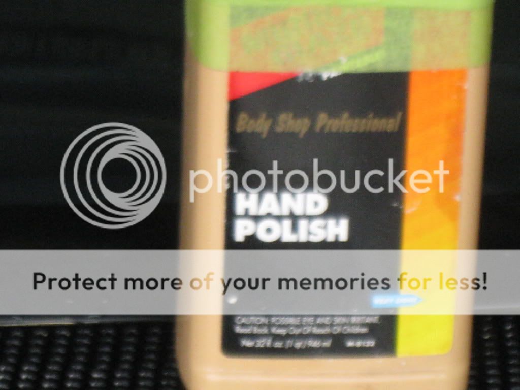

After the polish Use the #7. Apply with a application pad in small circular motion.. If you are unsure on this one go watch the origional Karate Kid..
Wax on Wax off Danial son!
buffer with compounding pad on

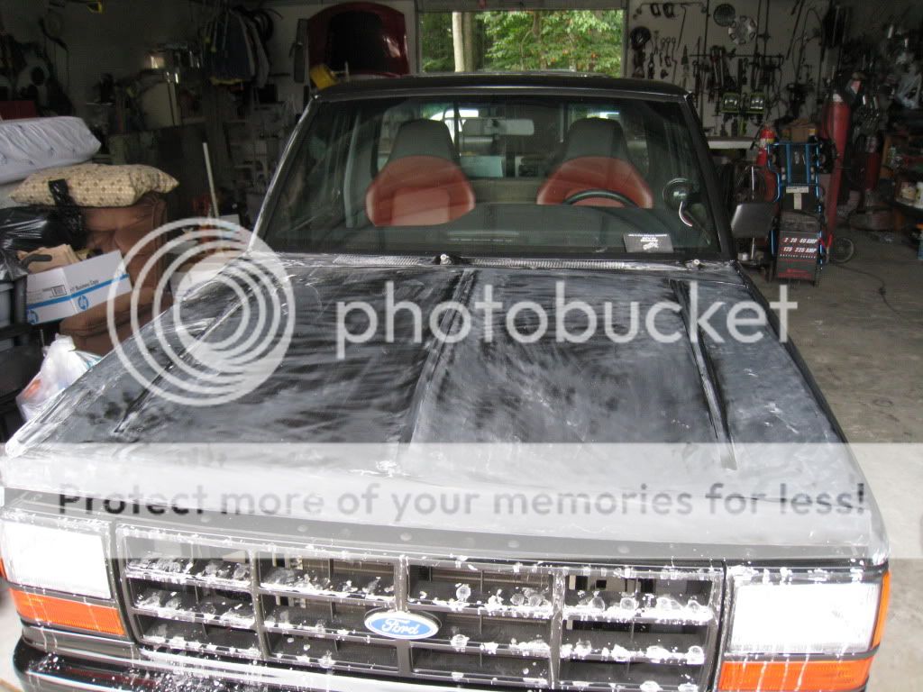

In the process of compounding
The #7 hand polish

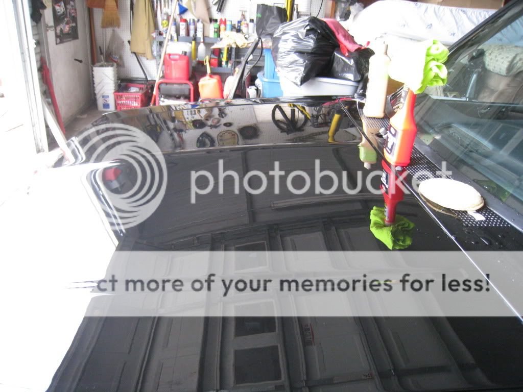

And here Should be the out come.
After cleaning the truck I found somehow red overspray got on the truck so that led to wetsanding and buffing... It takes a lot of time and practce to master buffing. I haven't seen many people that know how to do it.. If you think you know how and you turn the buffer up and not flat and move fast... You don't know how to buff simple as that... Do use comon sense stay off sharp body lines.. Maybe one day I will do a video on buffing...
