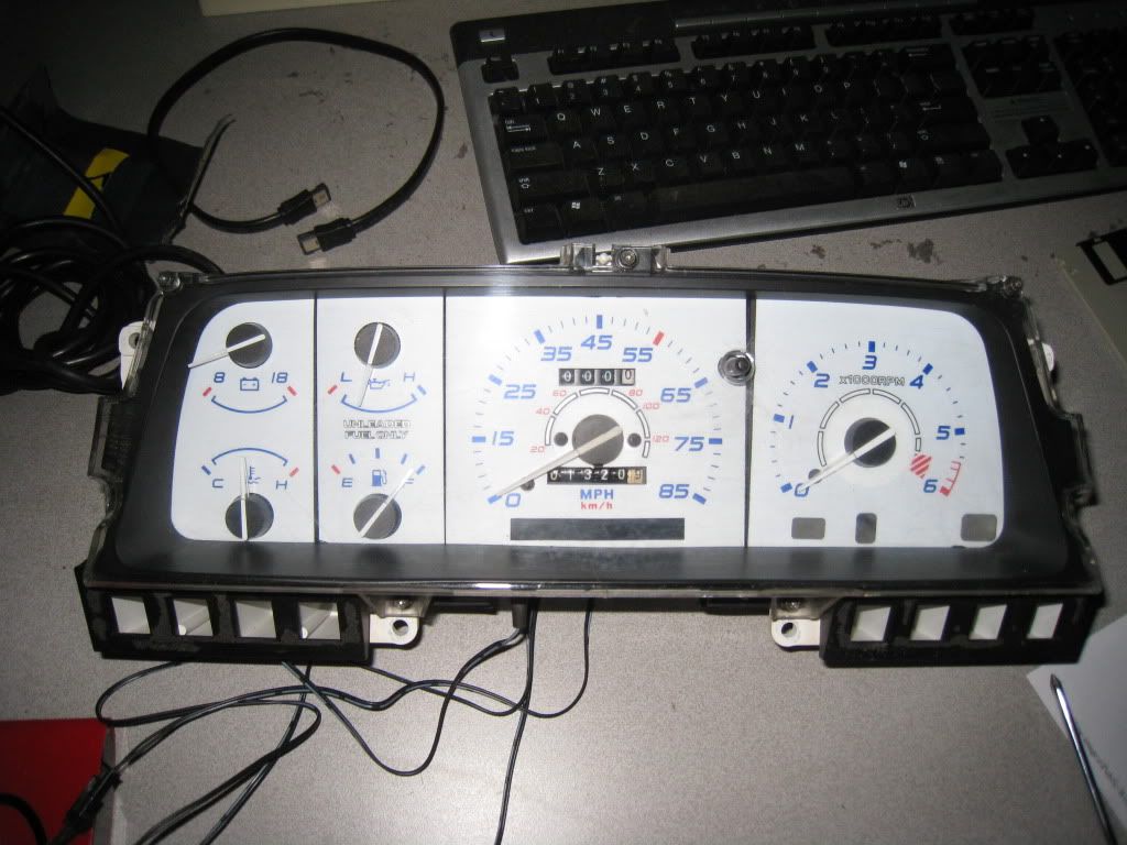

White faces came in.. Got them installed.. Used the 12V connection on a computer to test. They are too bright for my taste so I am going to tint the clear cover and black it out. If my idea works the dash lights will have to be on to see the gages..
