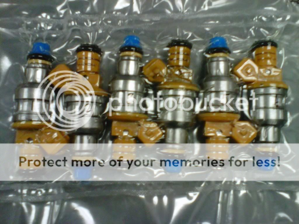

:yahoo: :yahoo::yahoo::yahoo: Updated injectors!!!!!!
Installed the injectors right quick... The results of the test drive is this.. The rough idle is gone. I could sit a glass on the intake with it running and it would stay in place. As far as power It has way more now... This is money on parts well spent... The updated injectors for those that don't know have 4 small holes instead of one... Would I recommend updating injectors absoloutly!!! Here is the flow sheet that came with.. I have no idea what it all means but I know what it does!!!

I'm prolly gonna get hate replies but IMO the Screamin Demon is nothing speacial... If anyone got anything out of it i'd say they needed it or the new wires and or plugs they also installed with it... Go with a stock one if you replace it if you can get it for less than a SD or get a SD if it is cheaper... It made a slight difference but a new stock coil prolly would have too... The biggest power adder so far has been the injectors...
