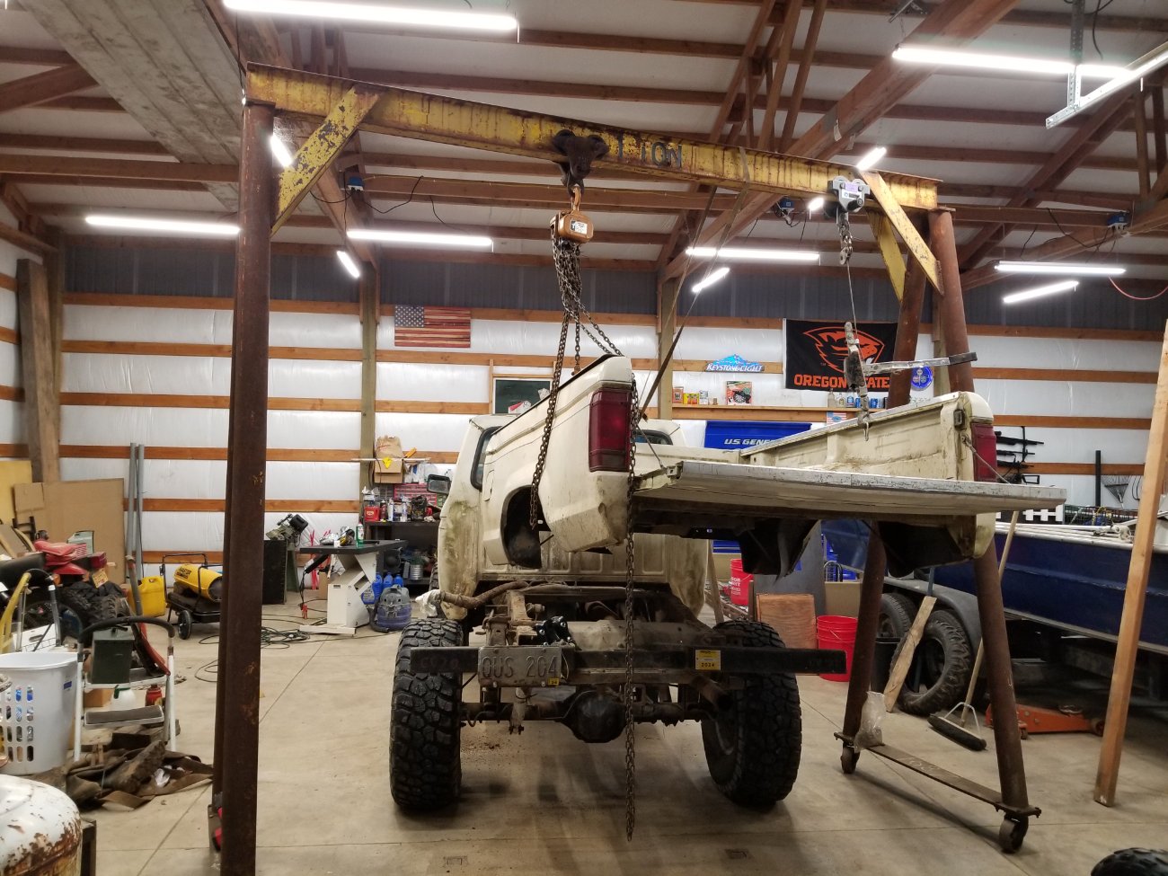

My fuel pump passed away.
Now that I'm home I can attach pictures... the one of the '97 is two 2x4's screwed together to get the right length (didn't have a long one to cut down...) with the engine hoist... the one in my shop with the '90 that one got kinda dumb... I "thought" I would get away without getting the whole bed out of the way then things kept escalating... Now I have two chain hoists on the A frame to keep the jackassery to a minimum... that ratchet strap was kinda janky... oh how I wish I had that much room in the shop right now...

In tank pumps cause some problems but there's no vapor lock... there's give and take for everything...
Right now I have a crew cab long bed F350 in the shop plugging everything up waiting for me to make one transmission out of two and do front brakes and it's still a mess from building a loft last winter, still haven't finished fixing the air compressor I got apart in December that I've had the parts for since then...

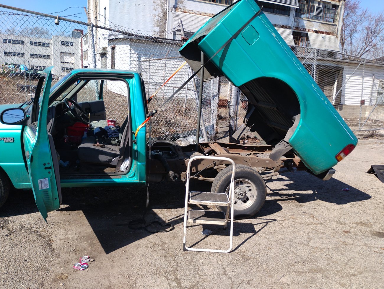

When I was working on my float to get my gas gauge to work I got my brother to help me lift the bed one time another time I had a friend help me.
It's really not that hard.
I used an old fence post to hold the bed up once it was lifted.
I put ratchet straps onto the corners of the front part of the bed, to my door latches to make sure the bed didn't blow over or anything like that.
Plenty of room to work under there.
Hopefully the picture will help you understand.
You don't have to unhook your tail lights or anything like that.
The hardest part about it it's breaking the bolts to the bed loose.
P.S.
Don't forget to undo the fill neck to the gas tank.
It's 3 little screws inside the gas door, on my truck.

I had two bolts that didn't want to budge so I used a half inch drive ratchet with my floor jack handle attached as a cheater bar.
What I did was really easy, once the bolts were broke lose.
You just need a little help lifting the bed.
I'm sure it's not out of your pay scale.
It the 6 bed bolts and the 3 little filler neck screws.
Then push the filler neck down and out of the way.
Make sure you have something to hold the bed up handy.
And if you feel you need more safety "like always do" make sure you have something " like ratchet straps " to hold the bed onto whatever you're using to hold it up.
First time you loosen the bedbolts they're going to be really tight. Most likely.
That's going to be the hardest part of the whole job.
Once your bed bolts are loose and your filler neck is out of the way. Lift the bed up.
Then put your brace in place.
Then attach whatever you are using for safety.
If you are using something for safety that is.
Then you can do whatever you need to do with the bed out of your way.
