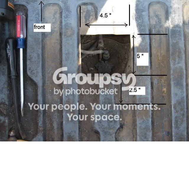

Initial incision.
My BroncoII died
Complete with patch piece.
That's what I have up at the moment, I'll have to see about getting some other pictures of it. These pictures are from my choptop, which is missing the one bracket on the floor behind the back seats. But when you pull up the carpet, you'll want to stay about 3/4" to 1" away from that bracket. The hole is centered in the back, I'll have to get dimensions because I forget 'em.
Update cutout pic with my measurements
Thank you for posting the pic. Just wanted to add some measurements when I did this to my B2. I broke two saber or jig saw blades since they were too course but that's what I had. Also I should have slid some thin plywood or something on top of the tank to protect the wires etc. since I nicked them a little. I don't know why more vehicles don't have an access hole from the factory. First ones I saw were on my daughter's 98 Land Rover and my son's 92 Eagle Talon. Every pump or sending unit will fail sooner or later. The reason I removed the sending was that besides the fuel gauge not working due to a hole in the float, (which we soldered) and my fuel pressure would drop from the necessary 40lbs to almost nothing when under a hard load especially on a hill. Apparently that is when the rear pump is needed. I replaced the rear pump with a 60 psi Walbro pump and was going to bypass the front pump. I tried it with both high pressure pumps running and the pressure stays at 40 psi under a load and drops to 35 psi at an idle so I don't see any reason to remove the front pump.

Nice job, thanks for the pics! This is gonna save lots of time and knuckle busting from dropping those fuel tanks!
