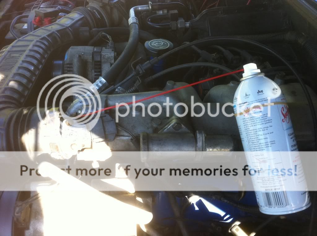

got some of this, i've never used a seafoam product before in my life but its highly recommended by a ton of people so... we'll see. the tube goes in the throttle body to almost touch butterfly, then you put the air tube (from the filter box) back on to hold the straw in place. spray it for 2-3 mins with rpm's 500-1000 above idle. then return to idle, shut off motor. remove straw. let sit for 5 mins then restart. then it says road test and drive aggressively to remove any remaining carbon

Seafoam is good, I use the other seafoam, where you pull a vacuum line off and let it pull about 1/4 of the can into the intake, and when it starts fogging, turn the engine off and let it sit for awhile, pour the rest in to the tank, always works good for me.

i thought about the other stuff. but was told by several to try this stuff first. so i'm gonna try it. i'll see what happens. i gotta find out why theres so much oil in my intake. its not BAD, its just coating my air charge temp sensor and getting in my IAC, making it do weird things
so far, i've cleaned my intake. let me say the seafoam stuff works great. my truck idles A LOT better now. i like it. only downfall is, you can't spray it steady like they say you can at 500-1000 rpms above idle. b/c the truck doesn't drink it all. it backs up into your air tube, and leaks on you belt.... making the belt sqeak. so i cleaned my belt and pulleys. when i had my air tube off, i noticed my battery has rubbed a hole in my tube, so i put some silicone on that. also i changed my pcv valve and my air charge temp sensor. now to get it all back together to see what it does..

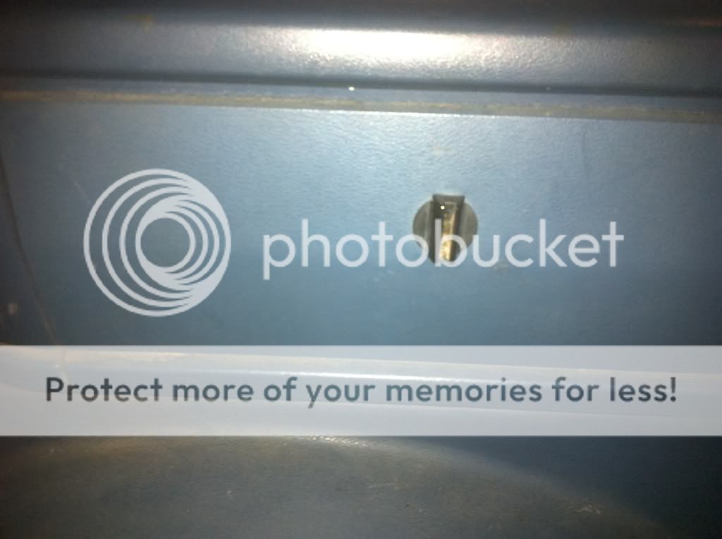

i've had my truck for 8 years and never knew those dang things lock. but since i have the original door locks still, i tried it. sure enough, THEY LOCK! not that it really matters but..... its freaking cool! lol
unlocked, only turns clockwise w/out the key in it
locked, put key in turn counter clockwise and its locked, won't turn either way w/out the key

the intake cleaner says 500-1000 rpms above idle, how does one person do this and spray the cleaner???
trucker trick!
the cleaner set up
I just hold the throttle open with one hand and spray with the other.
If the straw would have staying in the bottle-- that would have worked. But everytime I sprayed- it blew the straw out.
And it takes almost 4-5 mins to do that. So why hold the throttle steady with my left hand that long? WORK SMART NOT HARD!
My brain would have said "get the duct tape". Ya I keep a roll of it in the truck at all times.
