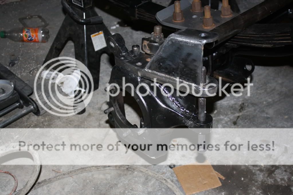

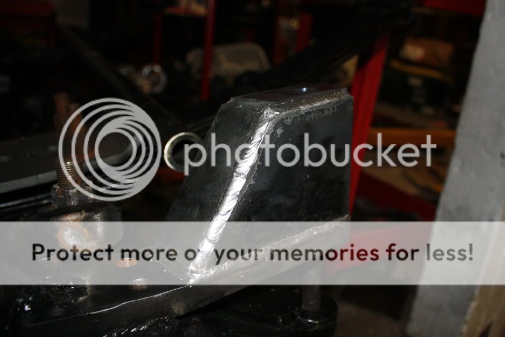

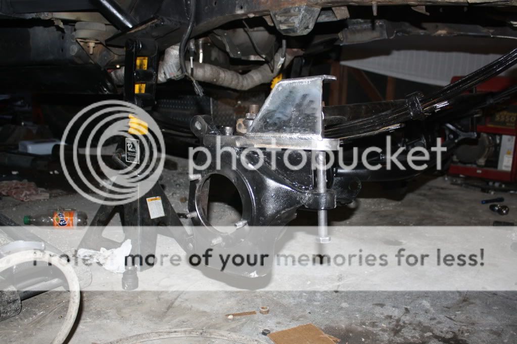

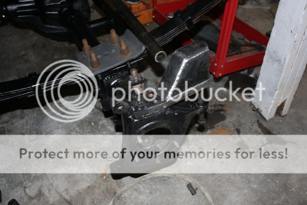

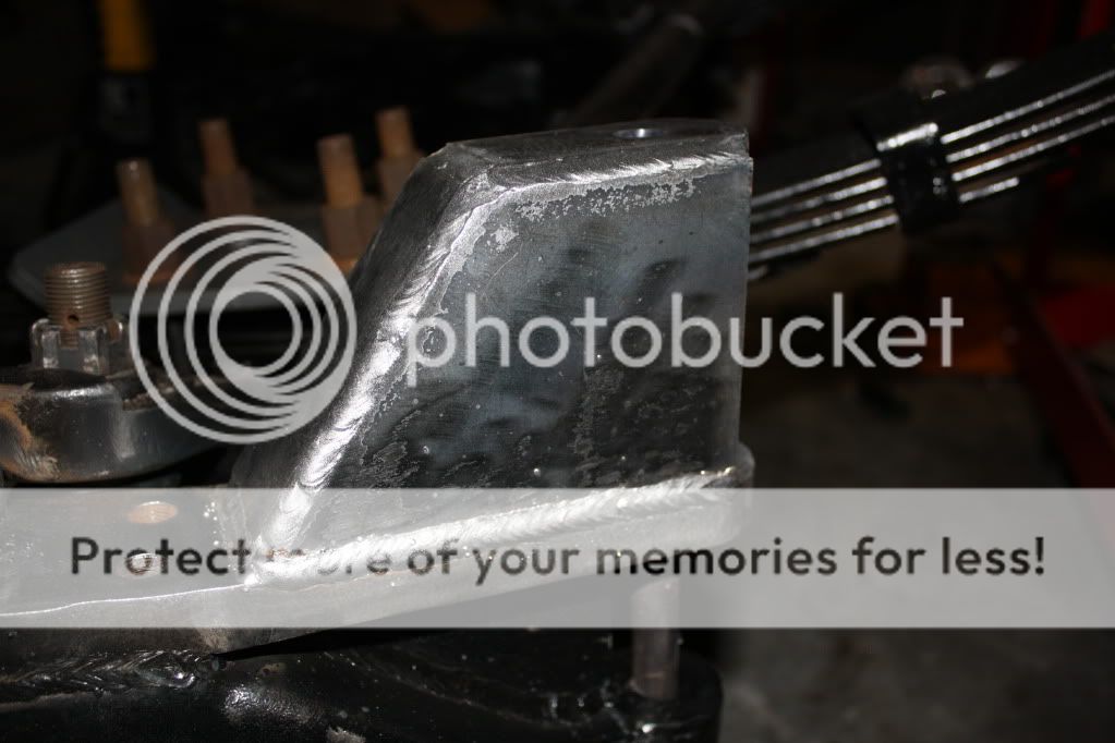

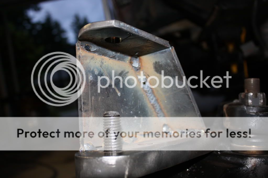

I assume youre going to be running your steering in double sheer? or are those just gussets? Just doesnt look like theres much room there for a heim to articulate (looks like it will bind on the gusset). ??
Those are just gussets....

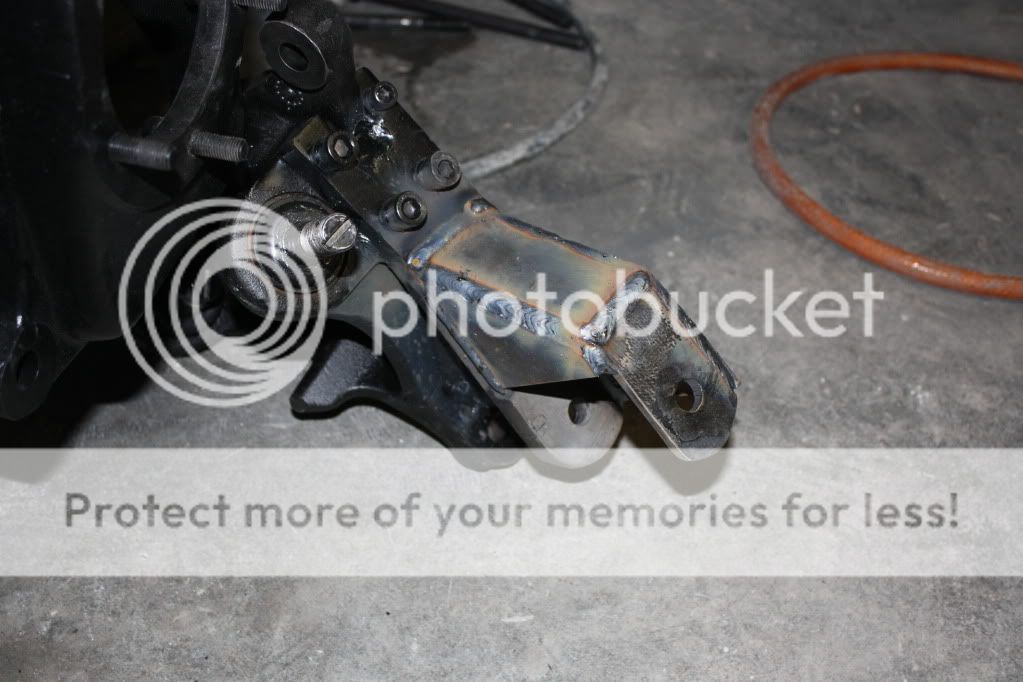

I made my own hi-steer back in the day, and the BJ knuckles dont get them up very high. I will be building onto the hi-steer arm itself, you will see. I added the gussets just for extra strength... I never had issues before, but I intend on doing some higher speed stuff this go around, so I wanted the extra assurance.

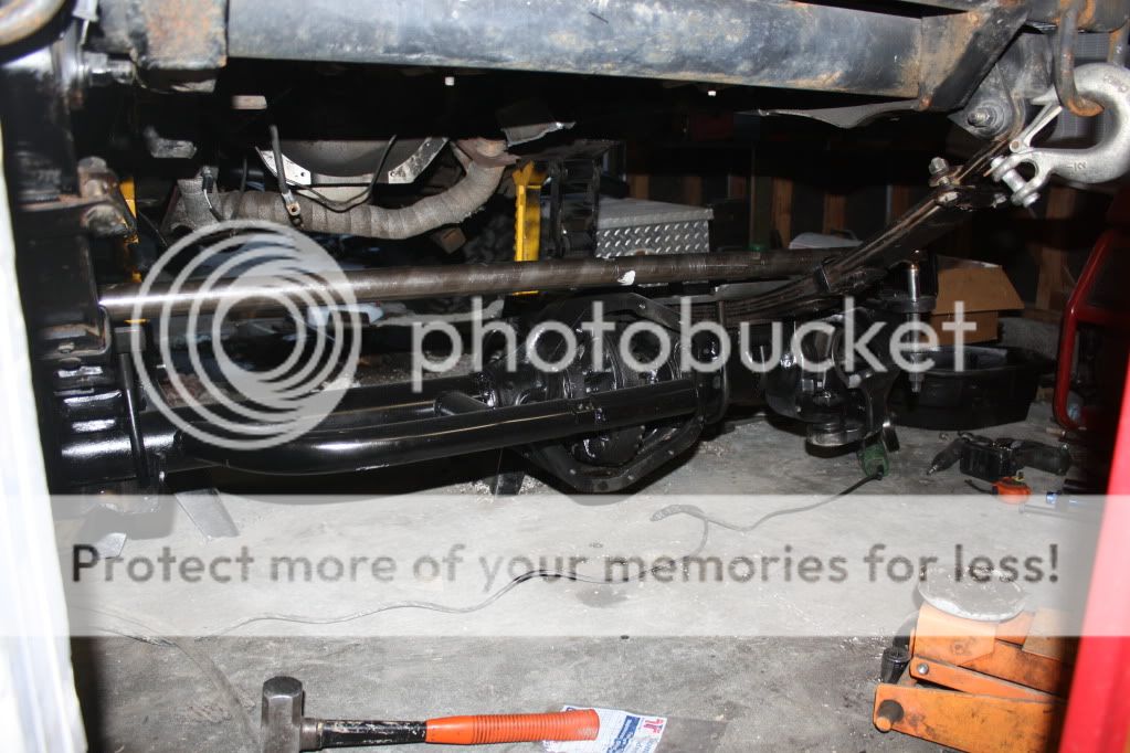

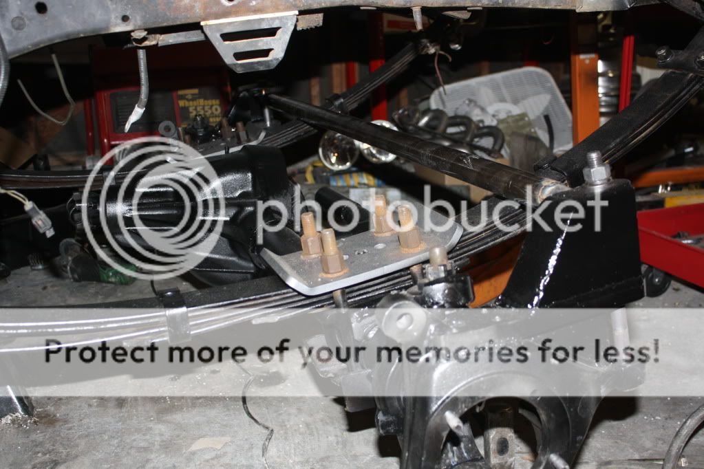

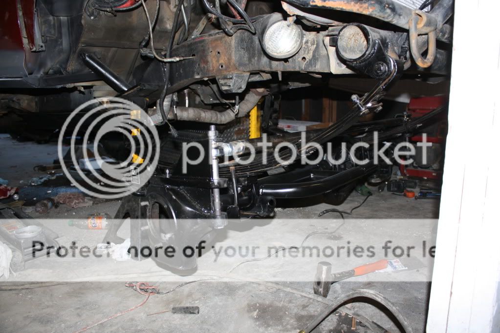

Looks good buddy. Does your tierod hit the leaf springs?
No.
I have a 1.75" tube spacer that goes between the top of the hi-steer arm and the Heim joint.
