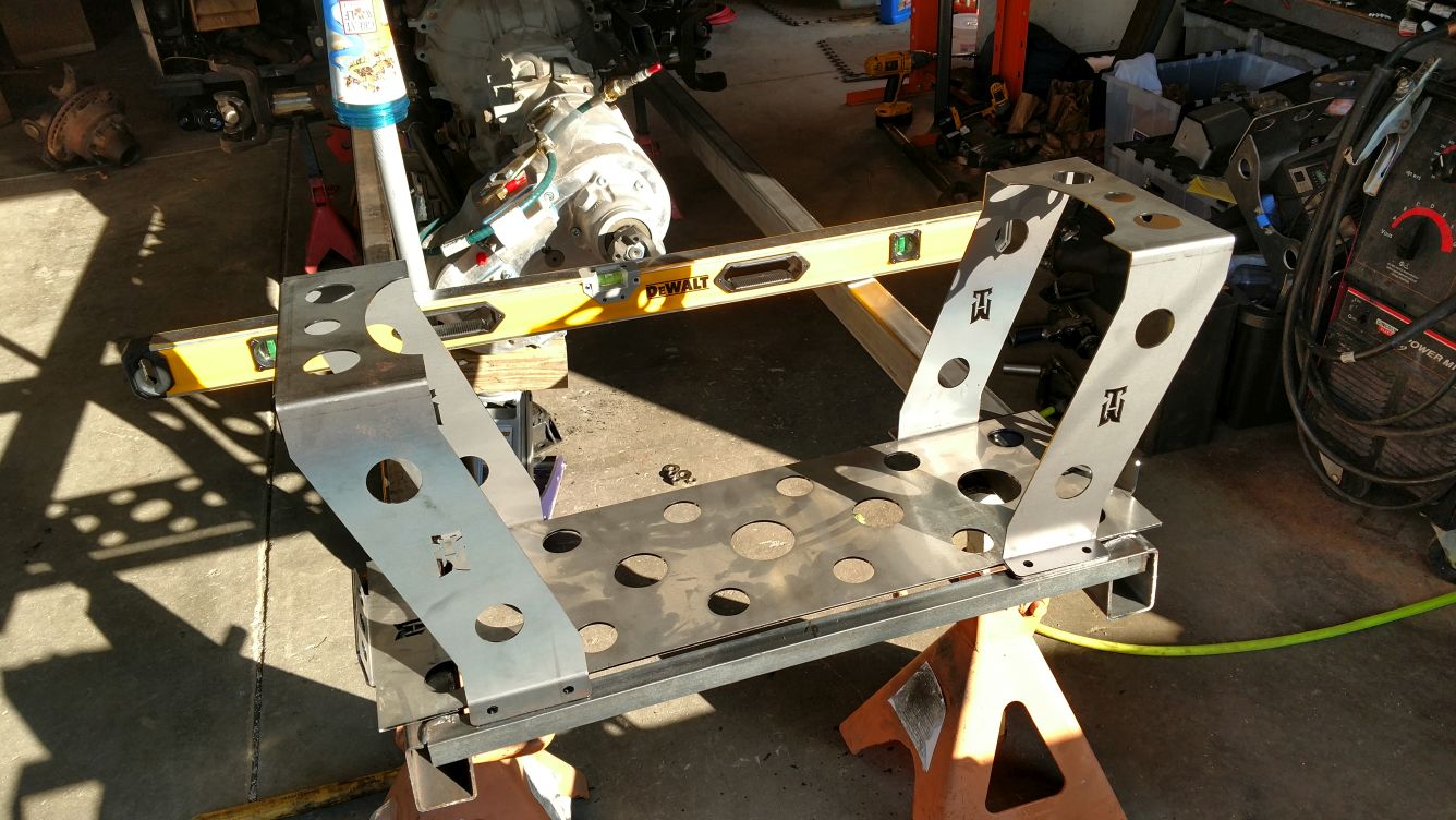

I got a nice piece of 1/4" plate cut for the trans cross-member. It's all bent up, but no pic right now...:

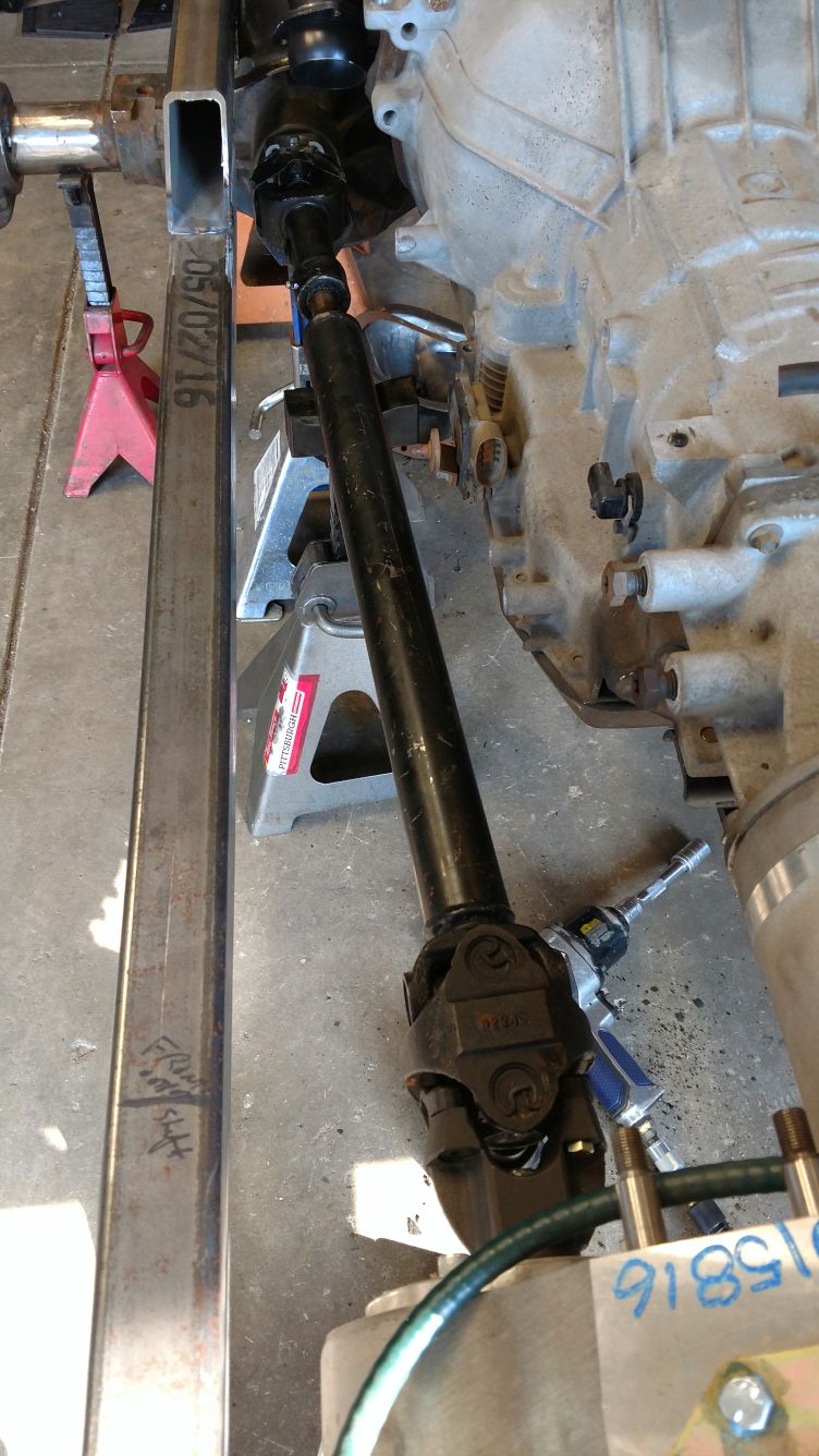

My thoughts to this point have been to build at max bump (aka up-travel). This way, if everything clears, it'll be fine at ride height.
For the first pic, I have the front axle set so the front driveshaft is about 36" at full compression. The axle sits in between the front/rear sumps.
For this, my thoughts are to have both driveshafts roughly equal length. On the short side, the WB would be @109" (at full bump). On the long side, @120". Lose a couple at ride height, so maybe 118"?? I'm thinking I'll end up @115"

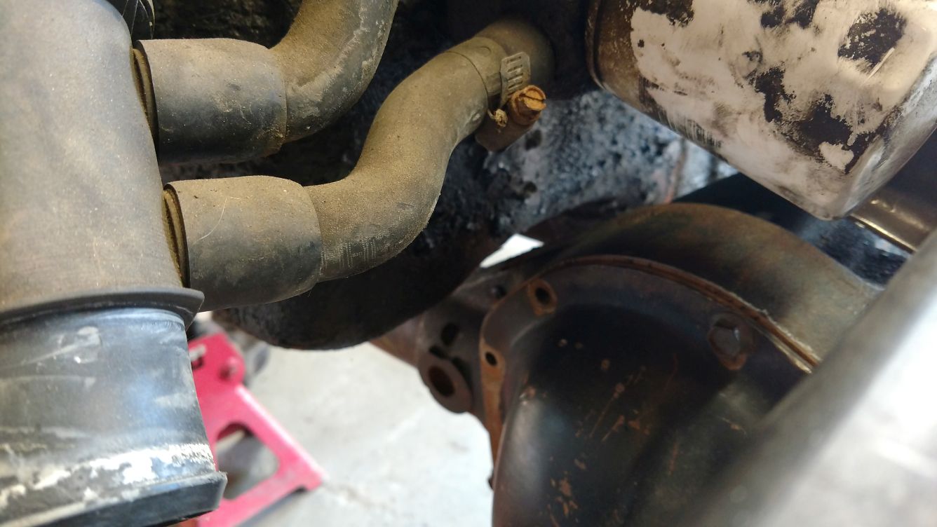

In any case, I've got clearance between the driveshaft and trans/shifter:
Mocked up the front axle, checked inner shaft length and got the inner 'C's tacked on where **I THINK** they should be.

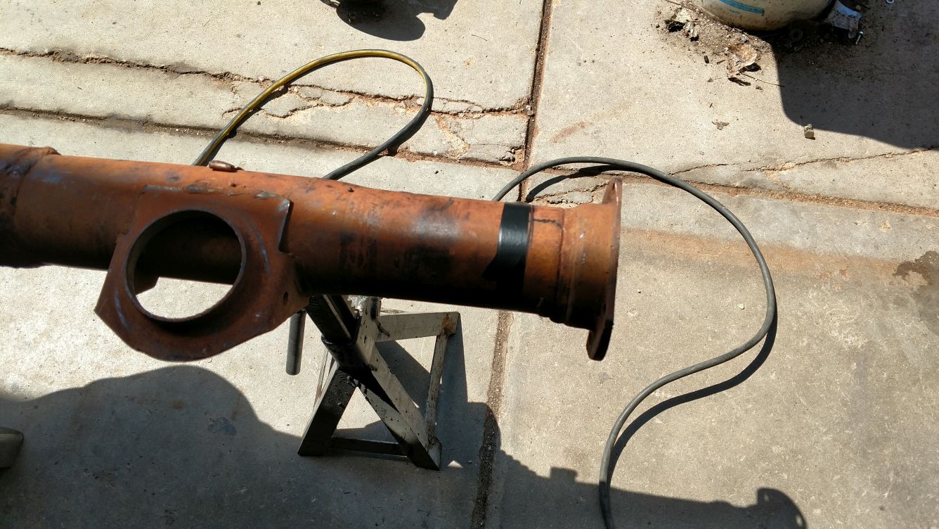

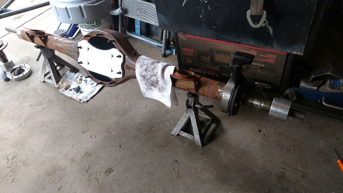

Got started on the rear axle. Mocked up and ready to cut the ends off for the full-floater conversion.

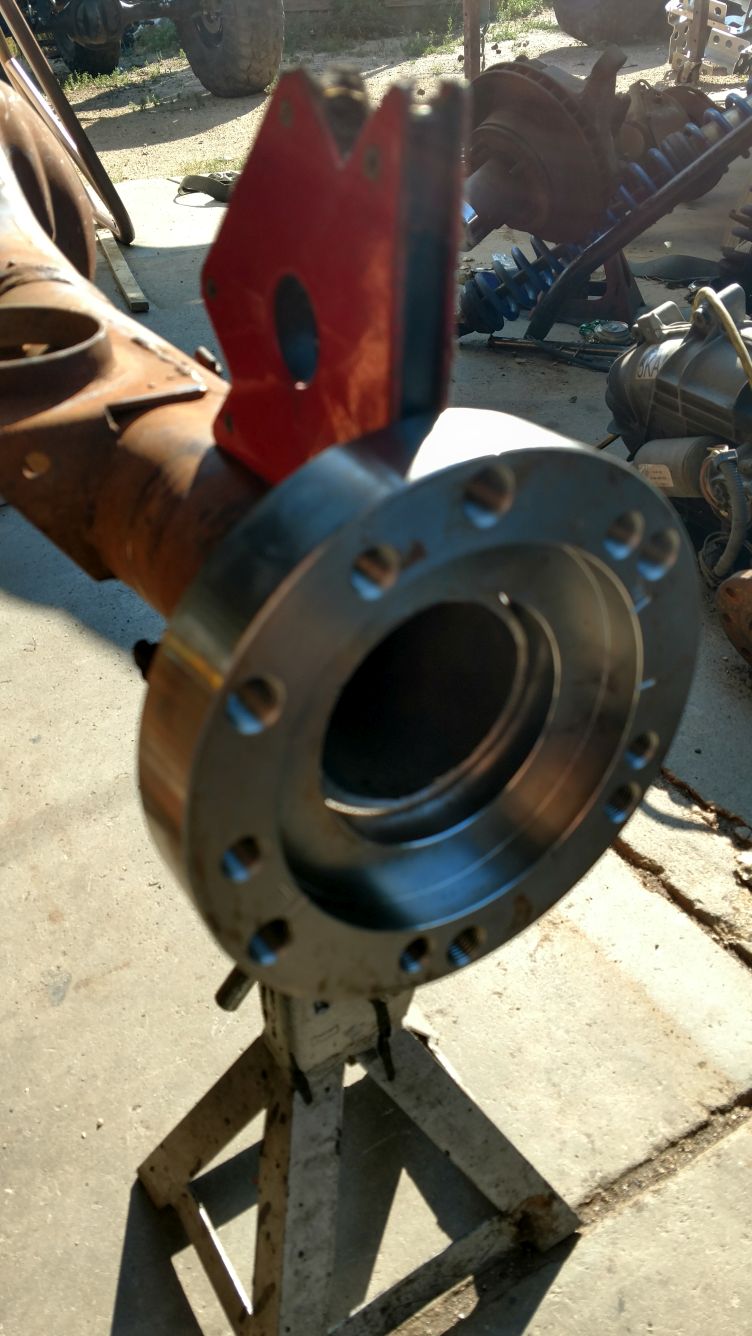

Got the ends cut off and the inner flanges mocked up. Unfortunately, the flanges do not fit over the end of the axle tubes. Seems these axle tubes are @3.085" outer diameter and the flanges are 3.040" inner diameter. So I'm going to have to turn the inner out to about 3.1" to give a little wiggle room to make sure they're centered when we weld them on.

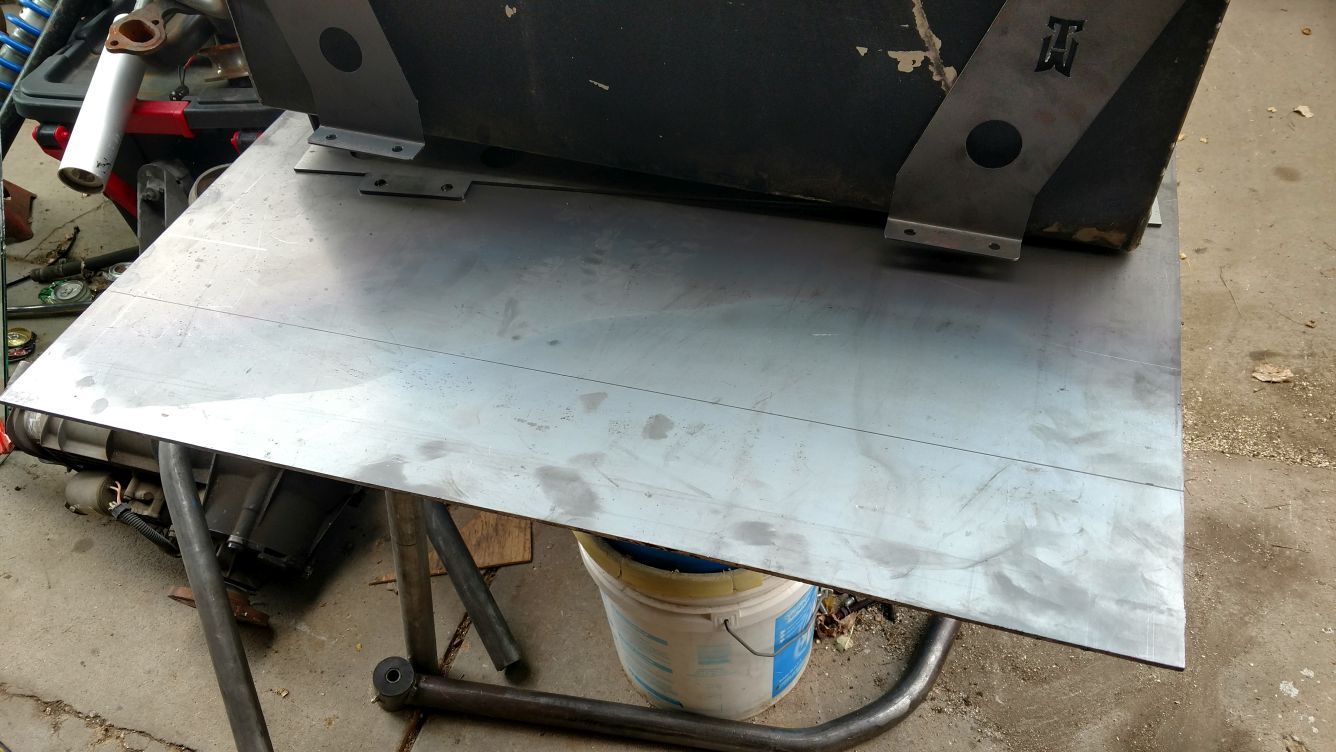

And last, but not least, the Trail-worthy Fab RCI 2161 fuel cell bracket arrived.
And the brackets/mounts for mounting the cab to the chassis one of these days... I'll use the short ones in the front for the cage/radiator area and the longer ones with the rubber bushings for the mi/rear of the cab.

Got the trans X-member built/installed today. I'm not 100% this is the way forward, but I need it held in place to bring the frame up to ride height (which was todays goal!).

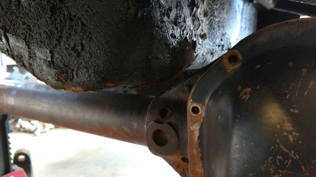

Axle center-line is sitting at 18" above the ground, about right for a 37" tire, @6" of up-travel before interference at the low spot of the oil-pan. Should allow @8" of droop with a 14" travel shock. Top shock eye is 25" above the top of the axle. So a 14" travel shock should fit fine, I just have to offset front or back to get it to @28" at rest.

Don got the inner dimension of the flanges lathed out for me and now they fit nicely over the axle tube ends, with a little wiggle room, PERFECT! Here it's mocked up with the axle centering jig:
