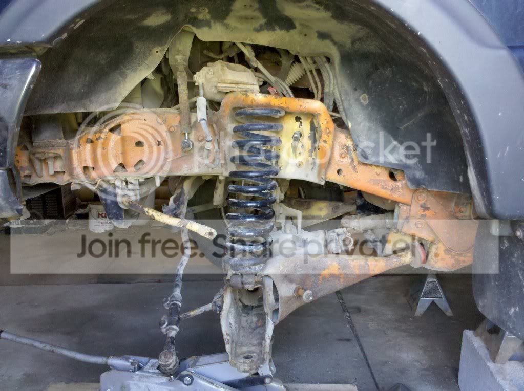

started taking it apart here:
here is the "new" front diferencial:
this is the start of the parts i will need
did some work to it the last few days
