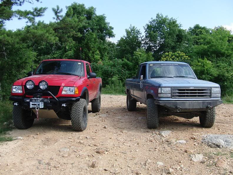

Well I ventured down to superlift orv park again and met up with ScottyJ. He has a pretty cool ranger
After wheeling with him on 2's for a few hours he took off and I met up with some guys from Arkansas crawlers 4x4 club. They were all really nice and we went and did some lvl 3's and lvl 4's (rubicon ridge and gulch). I didn't think my truck would be capable of doing some of they stuff we did lol. I unfortunately only got one picture.
