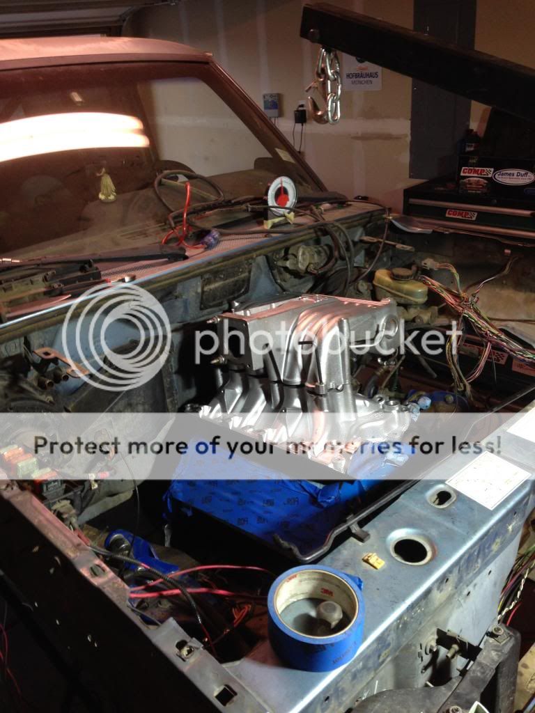

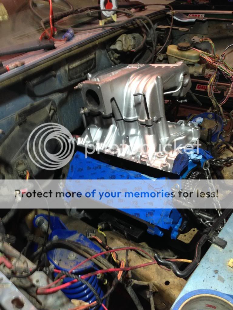

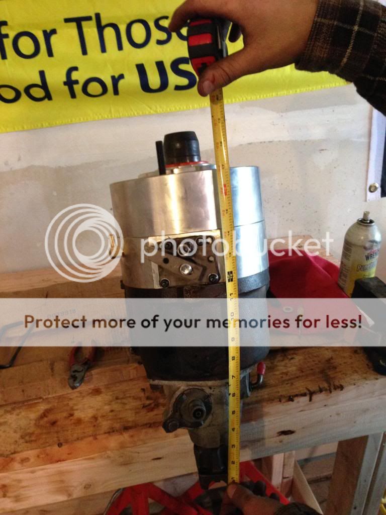

Well I bolted the tranny up to the block and set it in the truck again to finalize my motor mounts. I also started digging through the wiring and taking all the crap out I wont need. About 75% done with that. Bolted up the doubler and tcase also to start making cross members tomorrow. The new drivetrain is really short. Just the dana 300 and behemoths shorty doubler is 17 inches together. Going to have lengthen my rear and shorten the front driveshafts.
The motor is sunk down nice and low. There is plenty of clearance for 3'' header collectors around the firewall and block. Still going to be tight making the driver side header but it looks doable.
This week after I get the cross member made I need to pull engine, put it 100% together, mod the heater box, paint engine bay and finish up wire weeding, then build headers and exhaust.

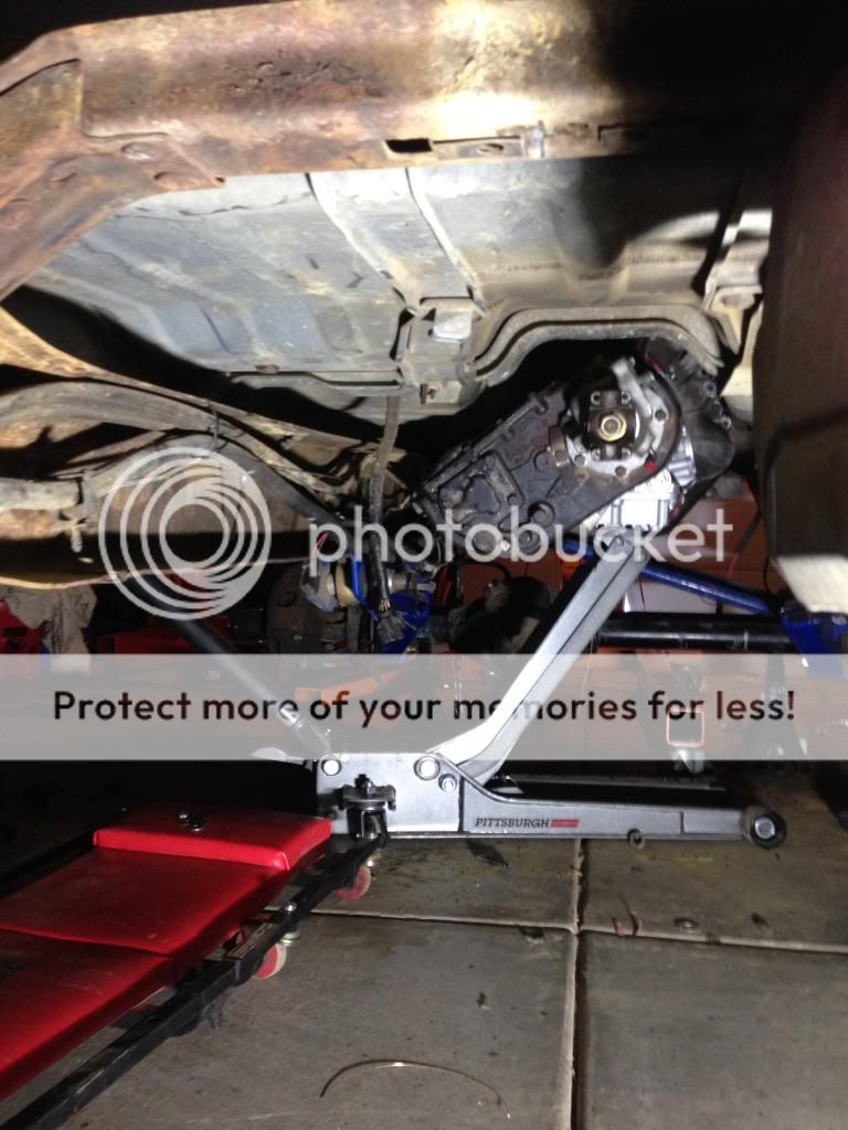

I gotta say that jack is pretty awsome! What is it?
Sent from my DROIDX using Tapatalk 2
Dude you dont even know! I got it at harbor freight for like $120. It was the highest lifting floor jack they had. Heavy duty, nice handle, foot pedal, and a nice big knob on the handle to open/close the pressure valve. Definitely happy with it, it is holding up the tranny in that pic but has more it can go up.
Link
Haha nice ! I put my xfer case in with a floor jack,2 wood blocks a strap,both feet and had the jack sitting on 2x4s to just barely get it high enough and I dont even have a solid axle swap!
I had wrestle mine in SVT, I could almost use a transmission jack designed for a shop lift, without putting my truck in the air. I can almost sit upright under the frame without hitting my head...
