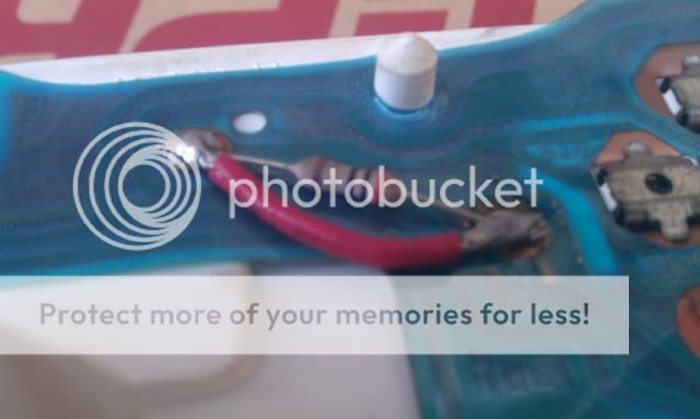

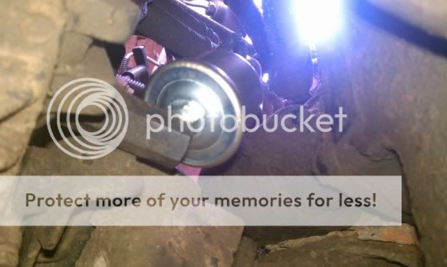

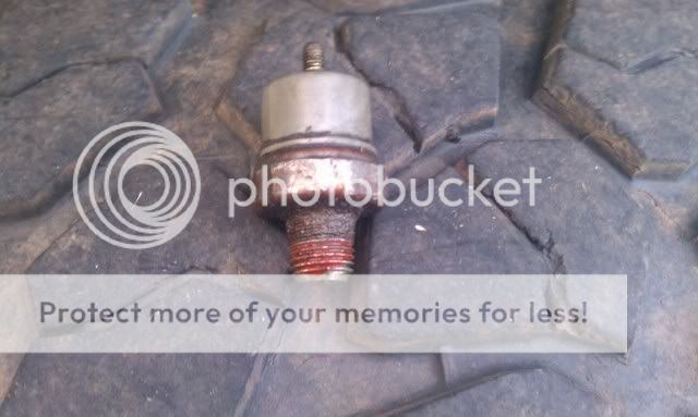

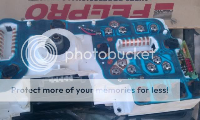

One of the exhuast manifold gaskets blew out and its was driving me crazy so I finally went and got some gaskets and changed it. Also picked up a new oil sender to do the oil pressure gauge mod to actually have a working gauge instead of just a dummy light.
Old sender
My 91 Exploder
New sender
My 91 Exploder
Resistor you need to jump
My 91 Exploder
My 91 Exploder

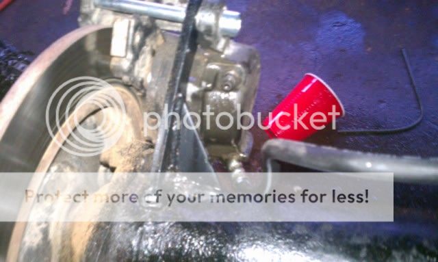

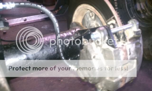

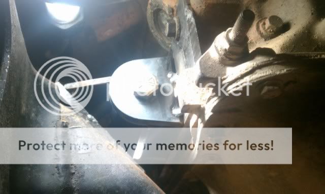

Also got my new rear brake brackets put on and made some guessets for them. Hopefully they wont break off this time.

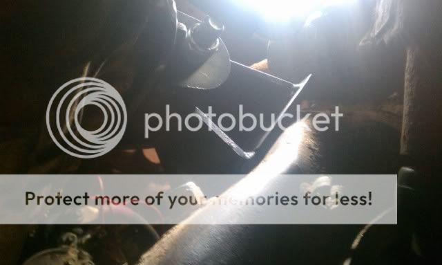

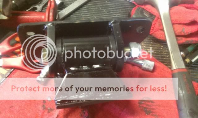

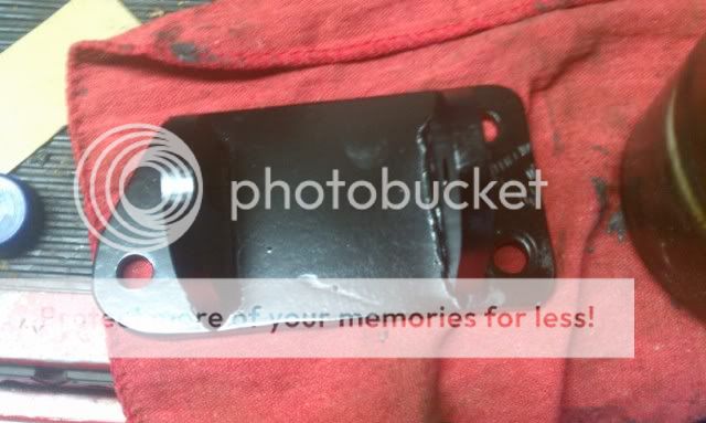

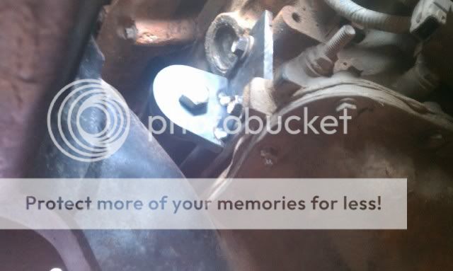

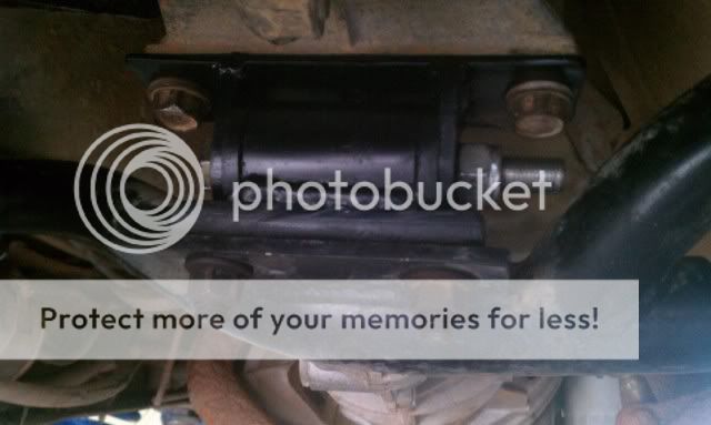

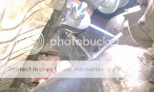

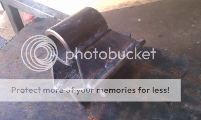

Then made some new motor mounts and trans mount.
Trans mount.
My 91 Exploder

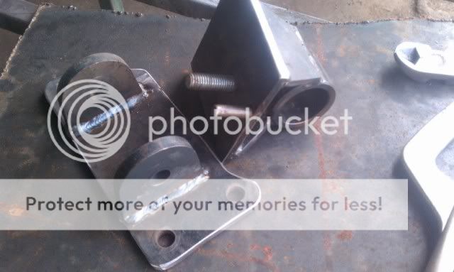

Motor mounts. There bolt on incase I ever want to change something. Lots if pics if anybody wants to try making some.
Passenger side.

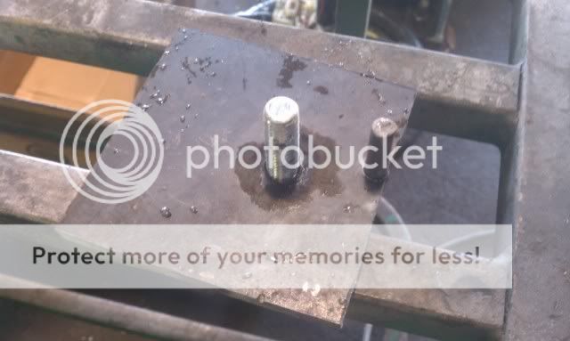

Motor plate.
My 91 Exploder
Frame plate
My 91 Exploder
My 91 Exploder
All tacked together.
My 91 Exploder
Welded
My 91 Exploder
My 91 Exploder
Painted and finished ready to go on.
My 91 Exploder
Pic comparing it to stock one that was falling apart.
My 91 Exploder
In place.
My 91 Exploder

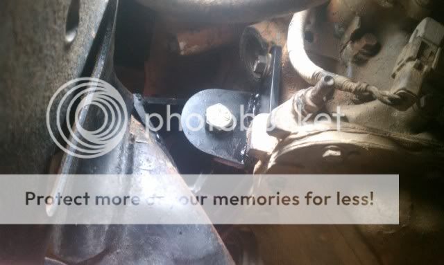

Now the drives side.

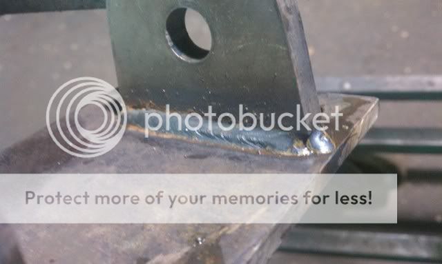

My 91 Exploder

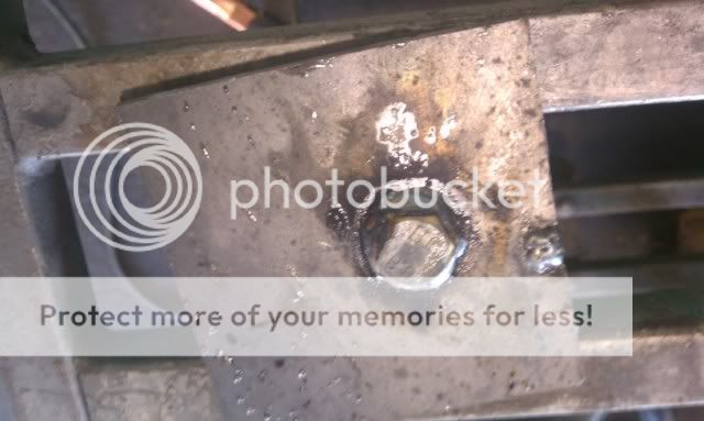

Getting a little better at welding. Still learning. lol
My 91 Exploder
Motor plate.
My 91 Exploder
All done.
My 91 Exploder

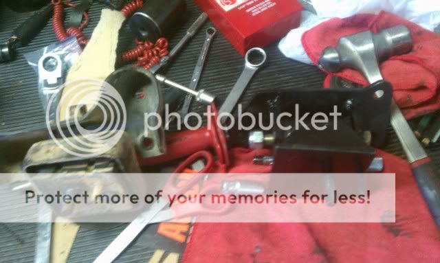

Tearing the 9" apart.
My 91 Exploder
