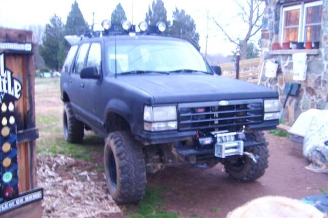

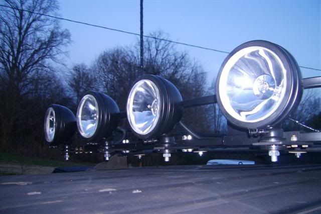

Got a Surco rack, some new lights put on, and a new Firestik CB antenna. Now I just need some new coax cable to hook the antenna up. Also have 2 more smaller square lights to go on the back of the rack for reverse lights.

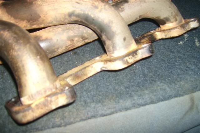

Scored a set of headers from the junkyard today. Got them for $16 and some change. I believe they are Borla. The Explorer had a Borla Exhaust sticker and thats what they look like to me looking at pics on the net but Im not 100% sure.

Got some questions on the headers. What brand do they look like to everybody and will they work with a stock y pipe or will I have to get one/make one? The y pipe that was with them was all tore up and cracked but it looked like a stock one to me but Im not 100% sure.
Got the reverse lights mounted on the rack and did some wiring and little stuff like that.

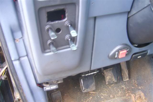

Switches. One is fore the 4 lights on top, one is for the reverse lights, one for the air compressor, and one to turn on the switch for the winch switch. The light switches are SPDT so I have them wired up with a on all the time position, off, and automatic on. The reverse will come on when it in reverse and the 4 lights on top will come on with the high beams. Dont mind the extra holes they were already there. Ill grab a new piece from the junkyard next time and re drill it.

Reverse lights on rack.

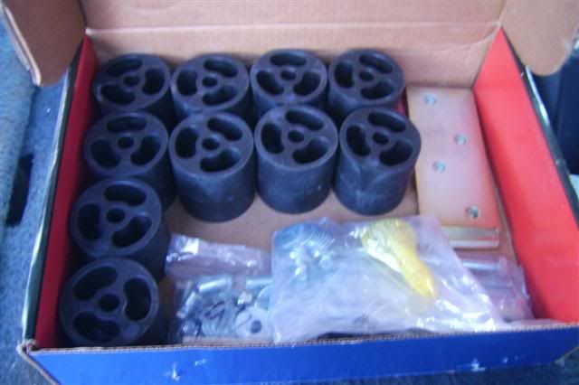

Got a body lift from the UPS man today. Ill probably get it put on this weekend.

Finished up the body lift today for the most part since I had the day off.

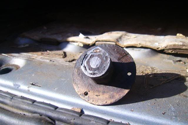

Only broke off one of the stock body bolts and the bushing would not come apart to save it life so I could get the broke bolt out. So I had to cut it in half to get it out. Managed to save it and reuse it with a little fix. I cut a piece off a 4/2 deep well socket to go on the underside to keep the lower bushing from being crushed when you tighten it down since the stock pieces were all rusted together.

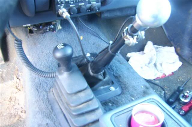

Got the shifters extended.

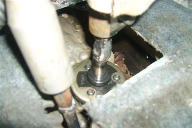

Didnt want to pay the $40 for the shifter extension and I had a few spare shifter pivot ball deals that go into the tranny so I cut the inches off one of the and welded to the top of the stock one. I had to grind the big ball off of it though. It may not be pretty but you cant see it and it works great and was free.
For the t-case shifter I just cut it in half and welded in a 3 inch piece between it.
Tranny shifter
My 91 Exploder
T-case shifter
My 91 Exploder
Now the shifters are back in the stock locations. Cant tell a difference from the inside.

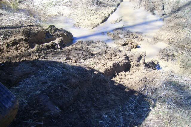

First time I got stuck i made it about half way across and it high centerd and I got it backed out and figured what the hell ill give it another try. Made it just about out and the front and rear diffs were bulldozing mud the whole way. Little tug with the winch got it right out. Something with with decent size tires has been playing in that hole.

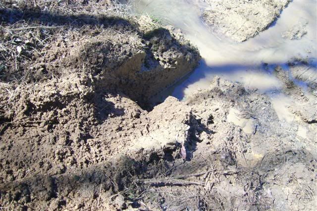

Then later on I was following a trail then the stopped before little creek no more tracks. Got out and looked and it wasnt real deep or anything and felt pretty solid so I figured what the hell Ill give it a try. Figured I needed to try the winch out anyway. So I made sure there was a tree to hook it up to and gave it a try. Made it just about into the edge of the creek and it sunk to the diffs. Ground was super soft. Hooked the winch up and pulled it right on through with no problems.
