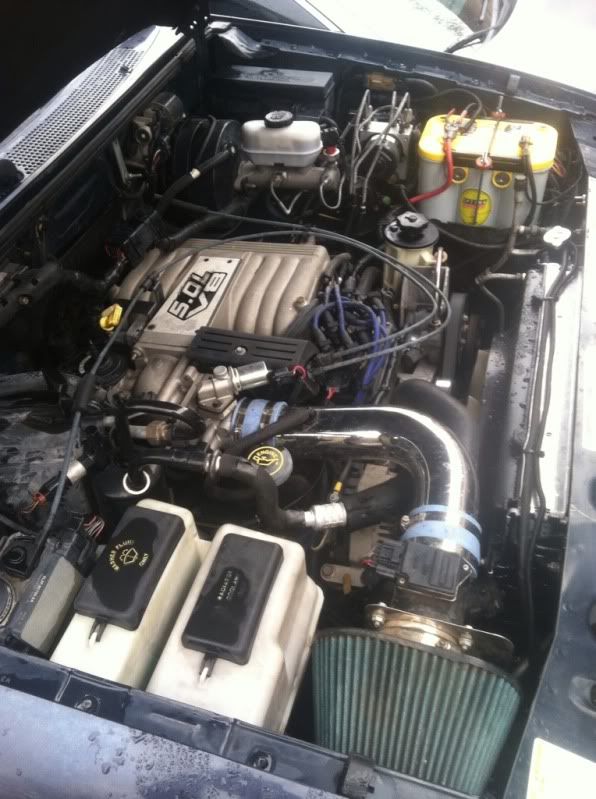

Heres an Updated pic of my conversion....Got rid of the ranger radiator and taurus e-fan when I blew a bypass radiator hose and opted to buy an explorer radiator and mechanical fan. There is some drag to the motor but Im running cooler and my AC blows ice cold(makes up for the power loss). Enjoy:
