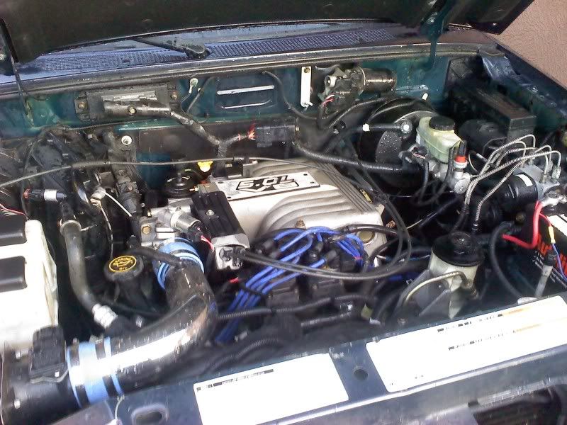

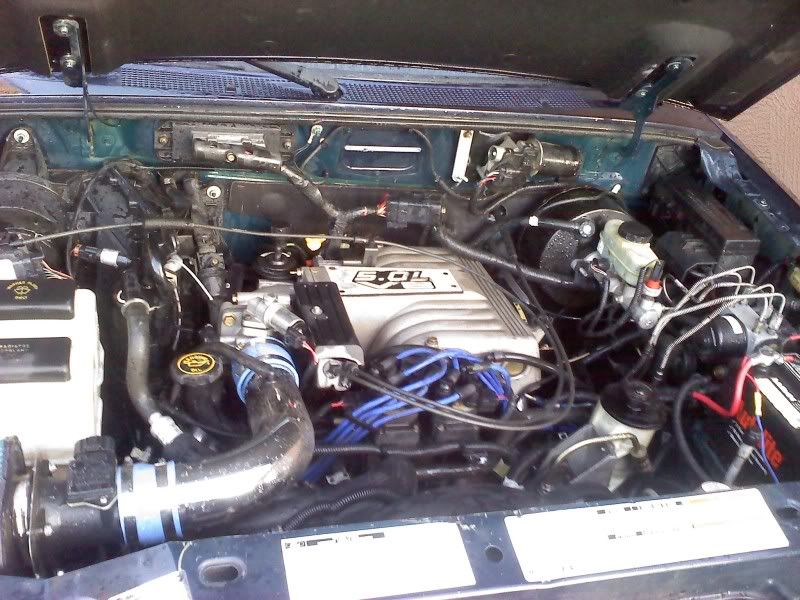

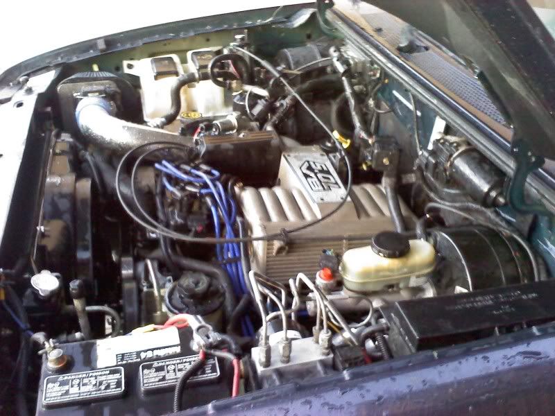

You gotta show us a picture of the engine bay all cleaned up!
Here ya go!!!

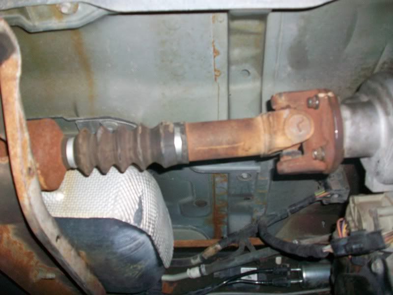

I never shared this with you guys but while putting everything back together, I ran into a bit of a problem. My rear driveshaft was an 1 1/2in too short AND the front drive shaft was the same too long. I was unaware of this and I thought this kit would have kept my driveshafts from having to be lengthened. Well this is not the case, Wish they would have made a 6 inch adapter instead of the 5in. Oh well :( here is a pic of it installed. It has since been taken off and lengthened.

no clearance issues... close but no issues and drive shaft i had to lengthen my rear an 1 inch & 1/2. and front one had to shorten 1in & 1/2.... i had to lengthen/shorten cuz the advance adapter kit sits about maybe an inch too short.
