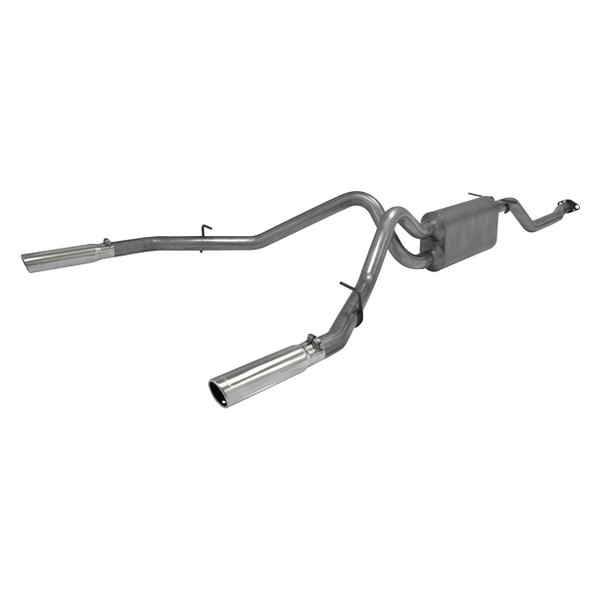

Ordered my Flowmaster exhaust today.
It's the stainless cat-back single in/dual out system. I would have preferred aluminized steel over stainless (for cost) but they don't offer this system with that material. Oh well.
Until it gets here, and I install it, you'll just have to live with a stock picture.

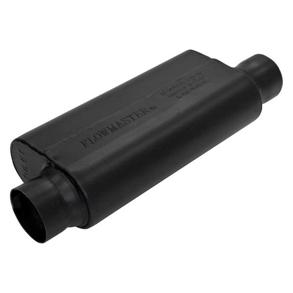

No pics yet, I'm waiting on a resonator to splice in ahead of the muffler. It's a tad loud (for my tastes) between about 2500 and 2750 RPM, drones a little too much for my liking, But the rest of the RPM range seems to sound fine, so I have one of these coming:
After I get that installed, I'll toss up a pic or two.

Super 50 series muffler.
