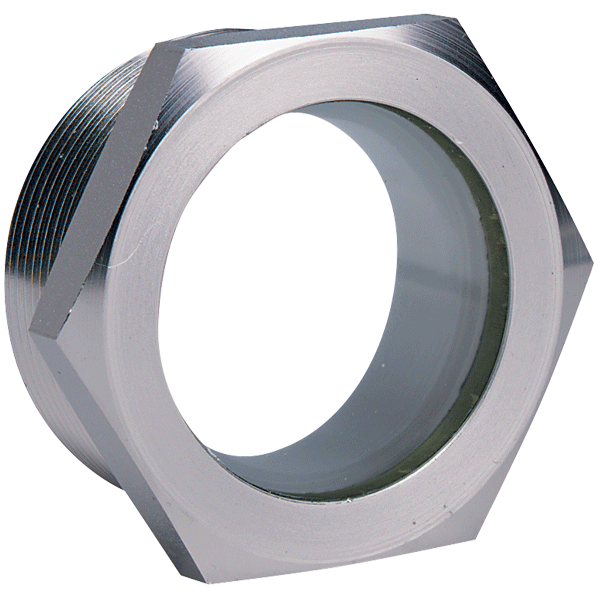

So I've decided to take the front snout off, since I have to do the seal anyhow, and weld in a 1/2" NPT threaded collar which will allow me to install an oil sight glass, so I can easily see the oil level at any time.

Yes I know, the picture is HUGE.
It'll be a 1/2" NPT male thread and the hex flats are about 7/8"
For reference sake.
