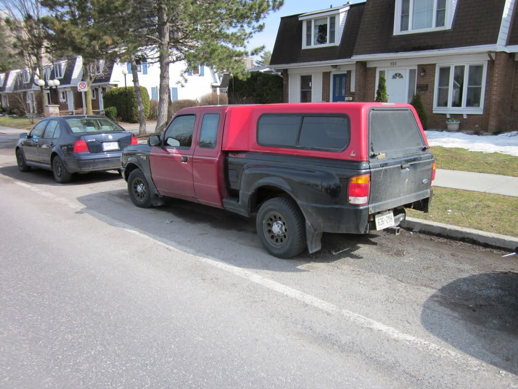

Update time , With the nice weather we are having I have started to work on the truck once again. Today I replace the latches on the cap I got a couple of weeks ago , it now locks . I also installed the headliner I covered with faux suede 2 weeks ago . This is the first headliner I have done so excuse the wrinkles .
This is the cap I got , yes it needs paint but then so does the truck
there will be more added in the coming weeks .
