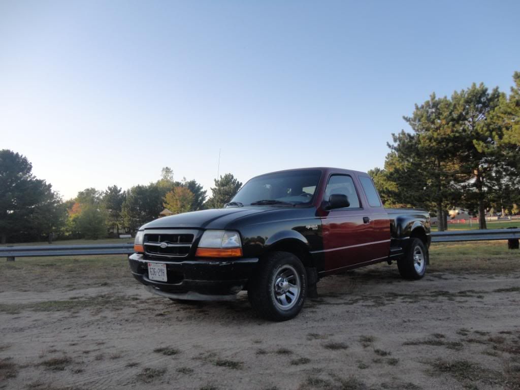

It has been a busy 3 days , I now have a hybrid , The cab and frame are the 96 Mazda, the box and front clip are from a 99 ranger XLT . I was a very interesting swap , two different generations of truck , had to do lots of modifications to get the front to swap over .
Pictures will be coming so don't ask for them , check back next Tuesday .
I will say one thing , Ford has way better head lights compared to Mazda .
With everything I have done , the truck is a FORZDA

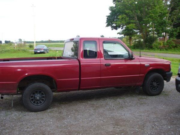

This is what the truck looked like when I first bought it ,
My 1996 Mazda B3000
Changes I have done to the Mazda since I first bought it

From the 99 Ranger I added these items to the Mazda
Dome light
High level cargo /brake light
Front clip
Box
Reese Class III hitch
Ashtray/airbag panel
One piece drive shaft
Other items added or changed include
15" rims from a Ranger with BF Goodrich T/A's
Explorer center console
Mustang Recaro Seats
Auto Loc power door locks
and finally power mirrors
