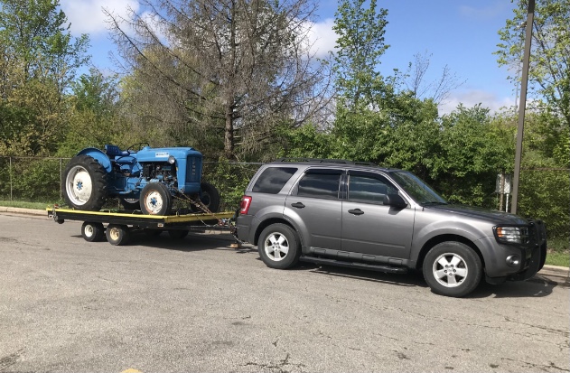

my little 4-lug tandem needs replaced, the box-beam frame is badly rusted inside. Brought home a 3,000# tractor 75 miles but seeing afterwards the shape of it I wouldnt do it again. Love the size of it for my useage though.

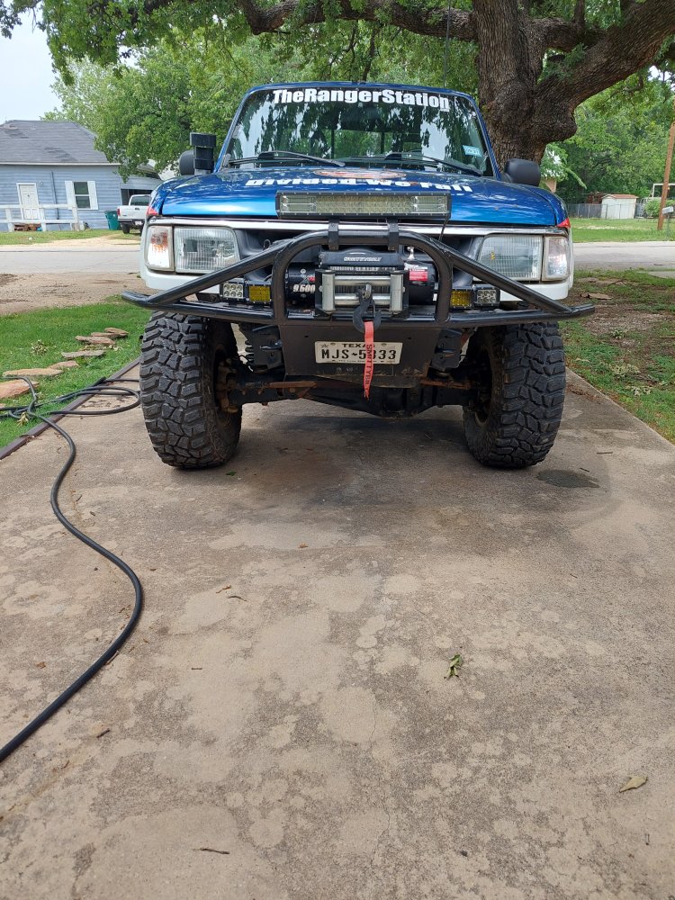

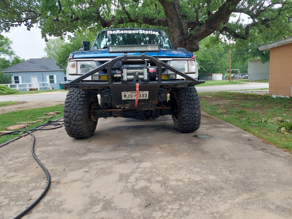

The Ranger has some issues. I jacked up the front and the drivers side front wheel has a little play that makes me think it's loose bearings. The passenger side has a little ply but it's in the upper ballpoint.
This is how it sits after I let it off the jack.

If I roll it back and forth it's going to bow out again. I need to fix it. If I try to drive it in pavement it sounds like I'm skidding going down the road.
If it sounds like you're skidding the toe is probably way out of alignment.
With a TTB other things being off can effect the toe too.
Sure looks like you bent something... in fact I thought I remember you saying you did at the last trail ride.
Possibly a tie rod... beam... drop bracket... all of the above?
