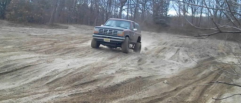

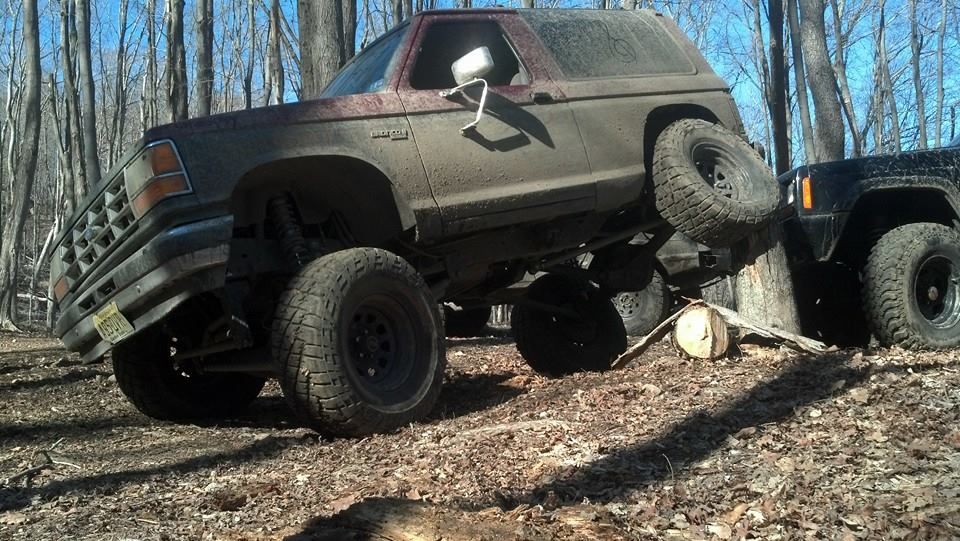

My 1990 BII Bomber 4 linked with coilovers on all 4 Corners
Thanks for the compliments!!
The new wheelbase is about 105". I just swapped out the rear springs from 150 over 225 to 125 over 200 and it is so much shoother and better in the fast stuff.
I blew out my hubs and caused some body damage already, ordered a set of warn jeep ones.
Upcoming will be front locker, winch, bumpers and exo cage to prevent further damage.
Had a Great weeked, blew out 2nd gear in the whoops but she still goes! Need a new M5OD... Here is a video of it jumping! Need to lower rear bump pressure, get more weight toward the back and i think its guna need more rear rebound dampning. I ordered Hydro Assist and got a 8k winch to mount, updates soon!
