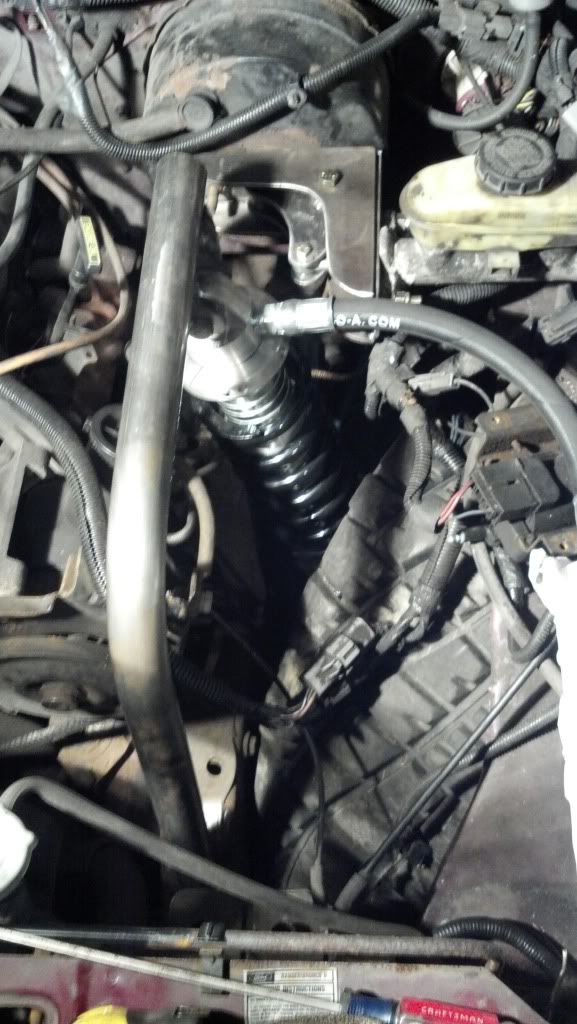

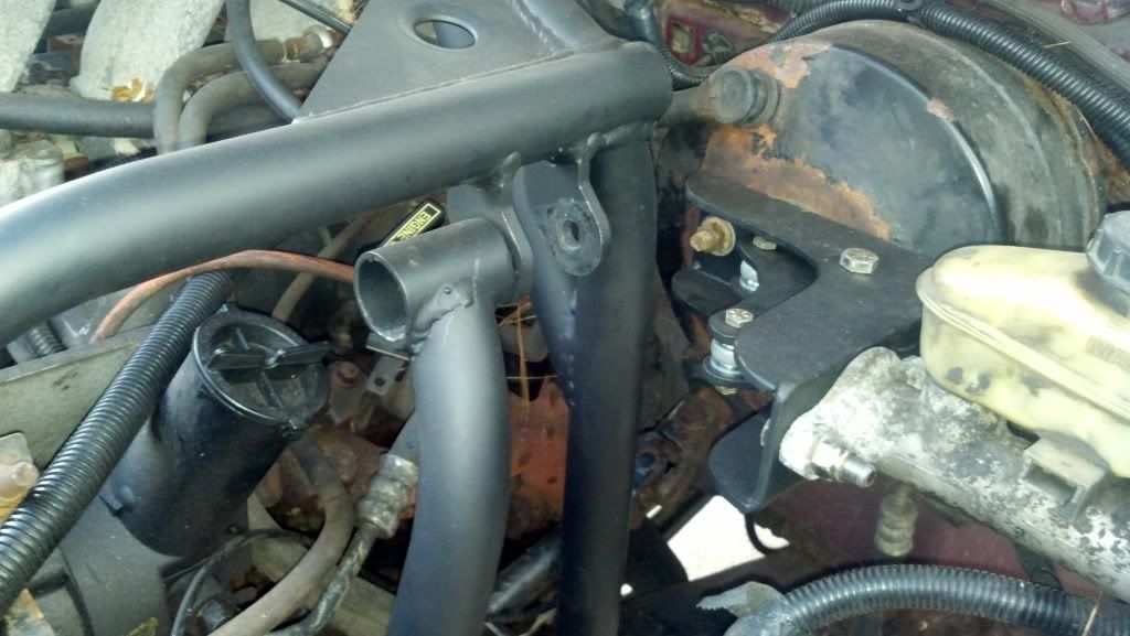

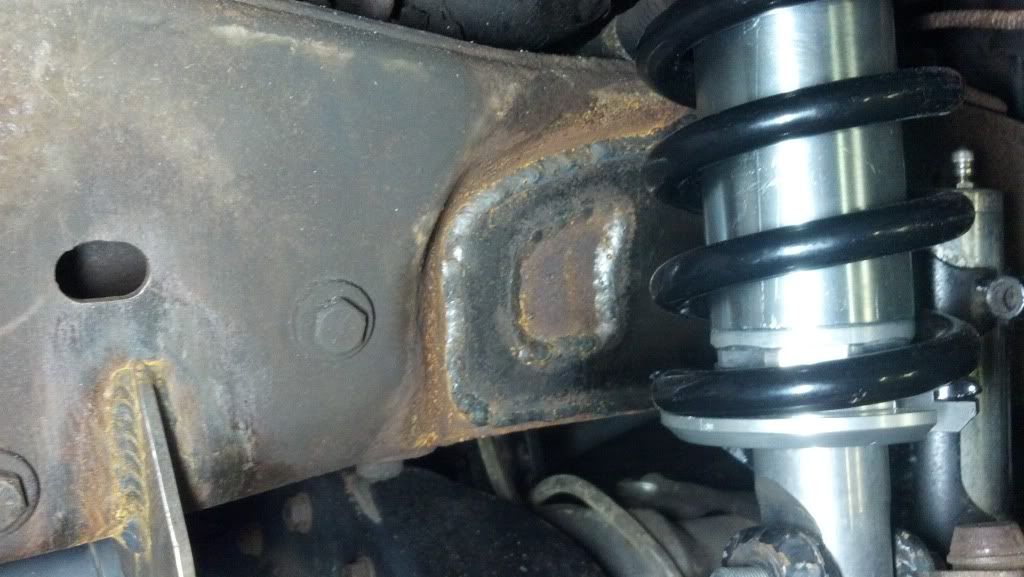

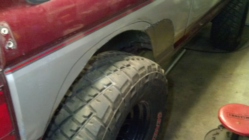

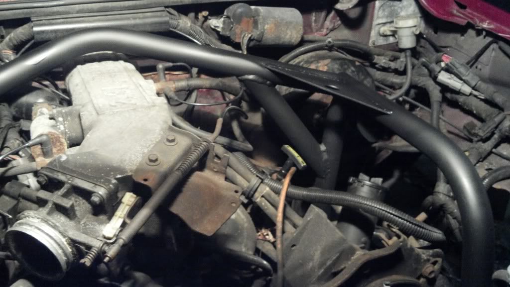

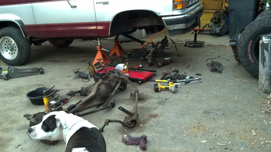

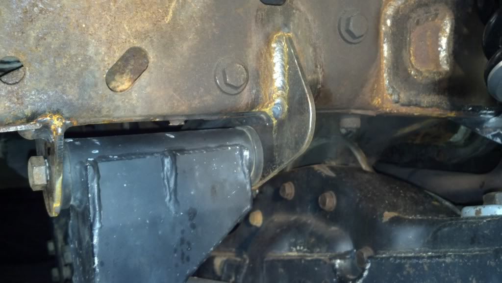

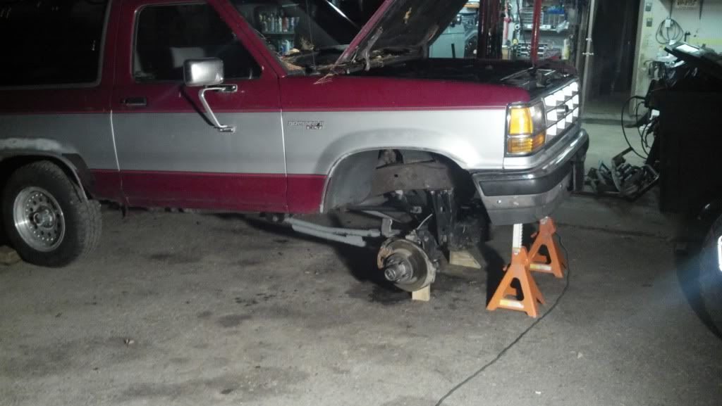

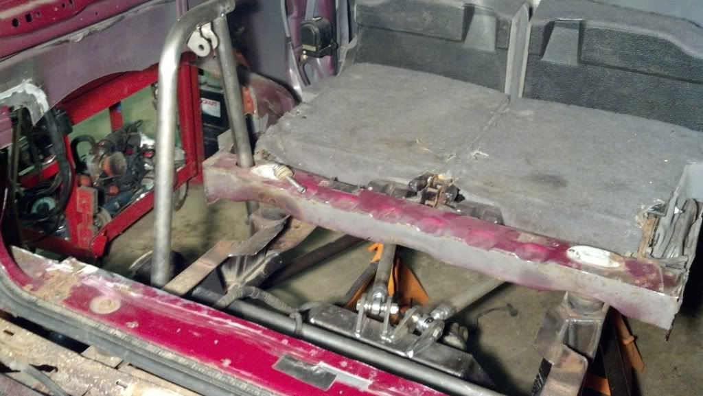

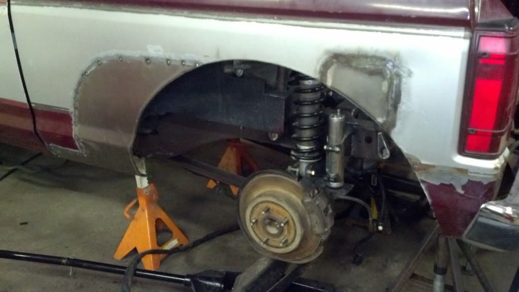

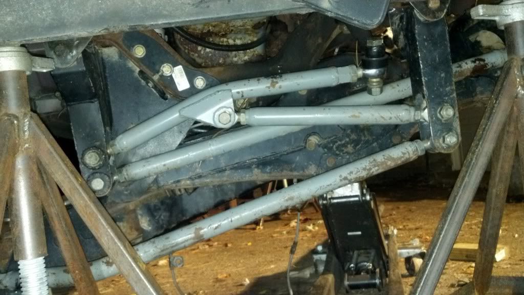

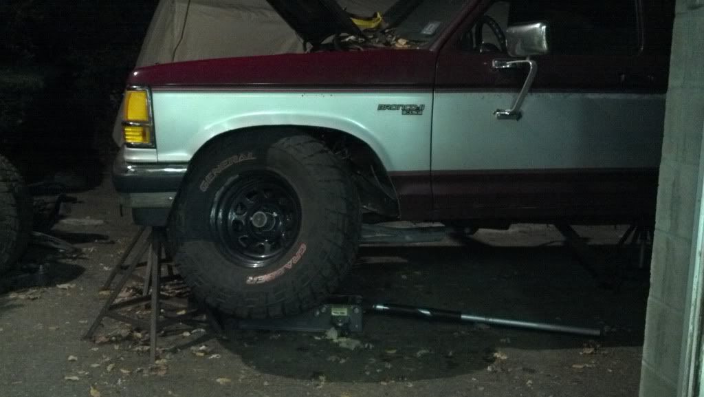

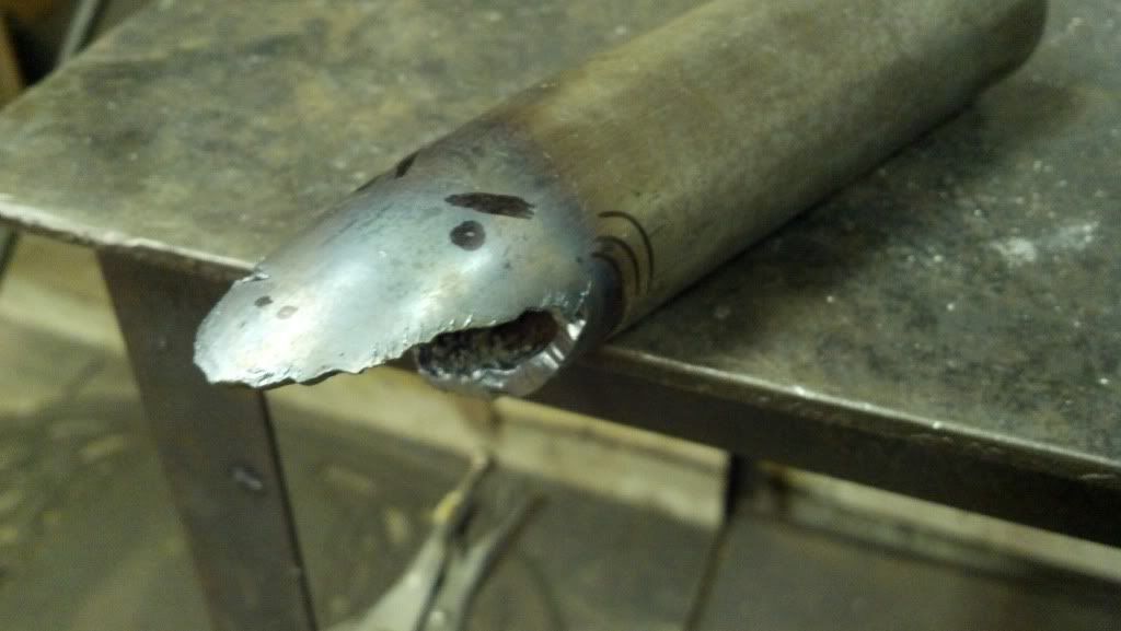

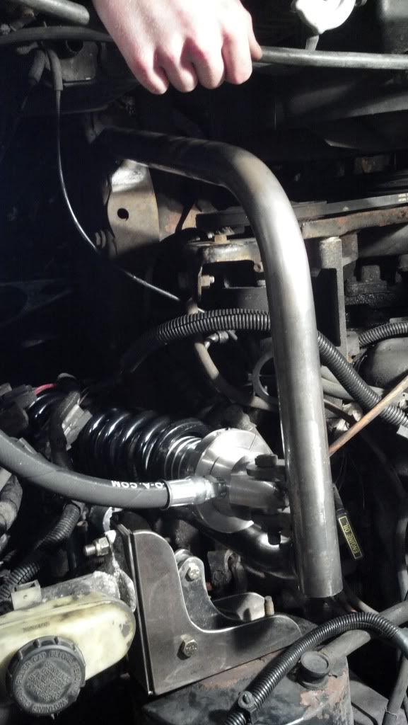

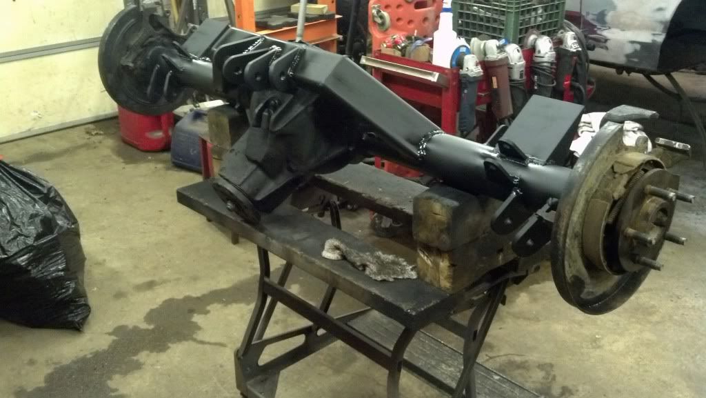

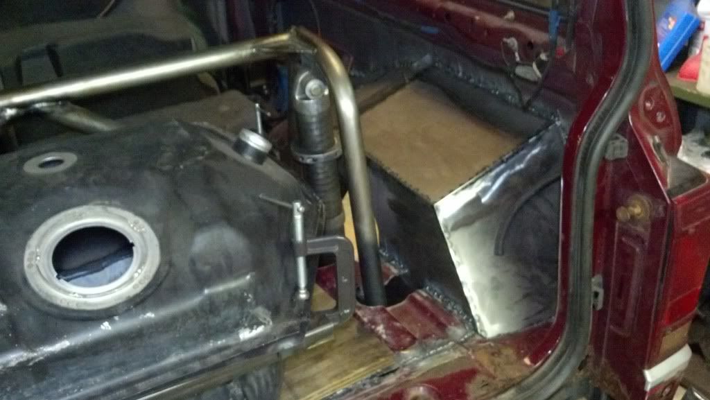

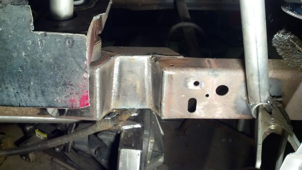

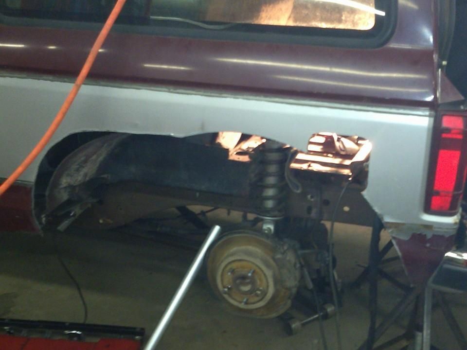

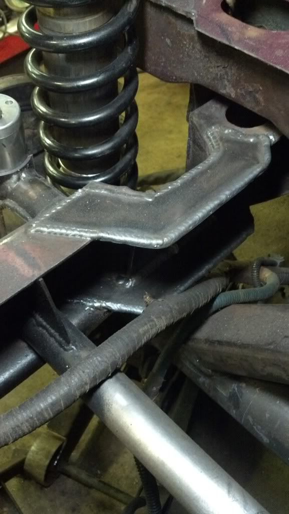

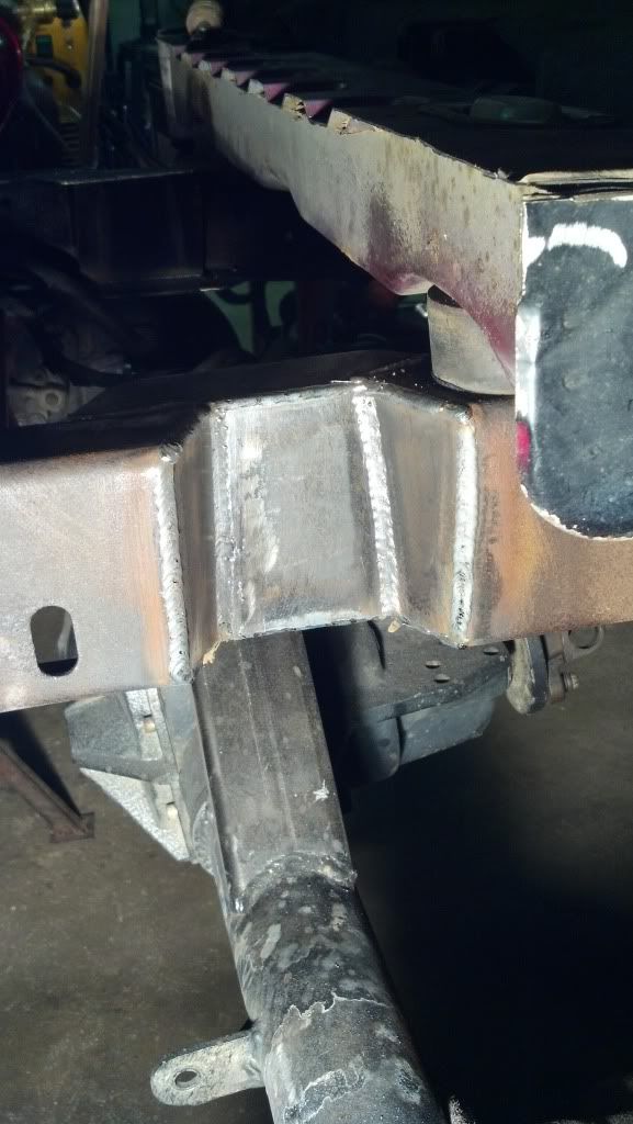

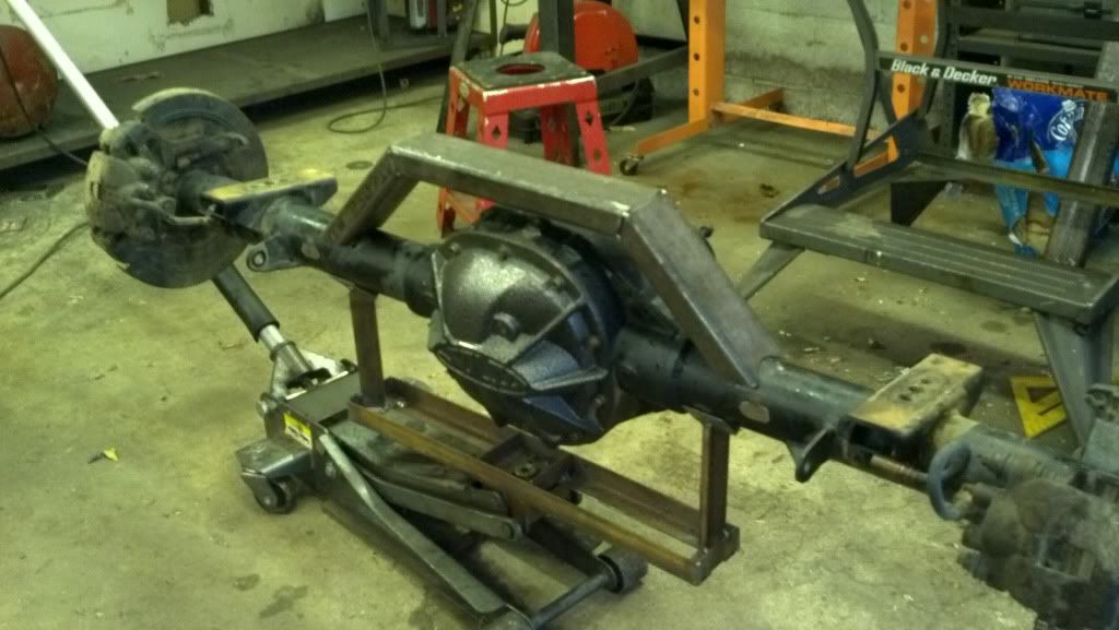

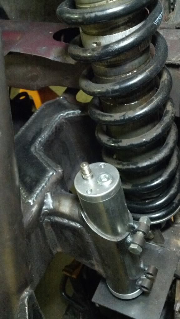

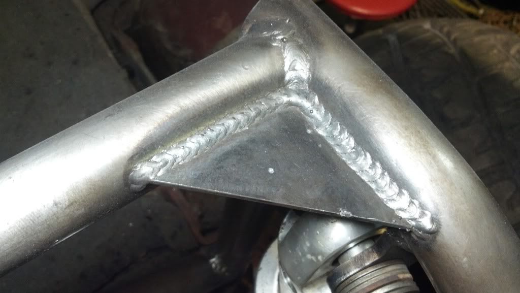

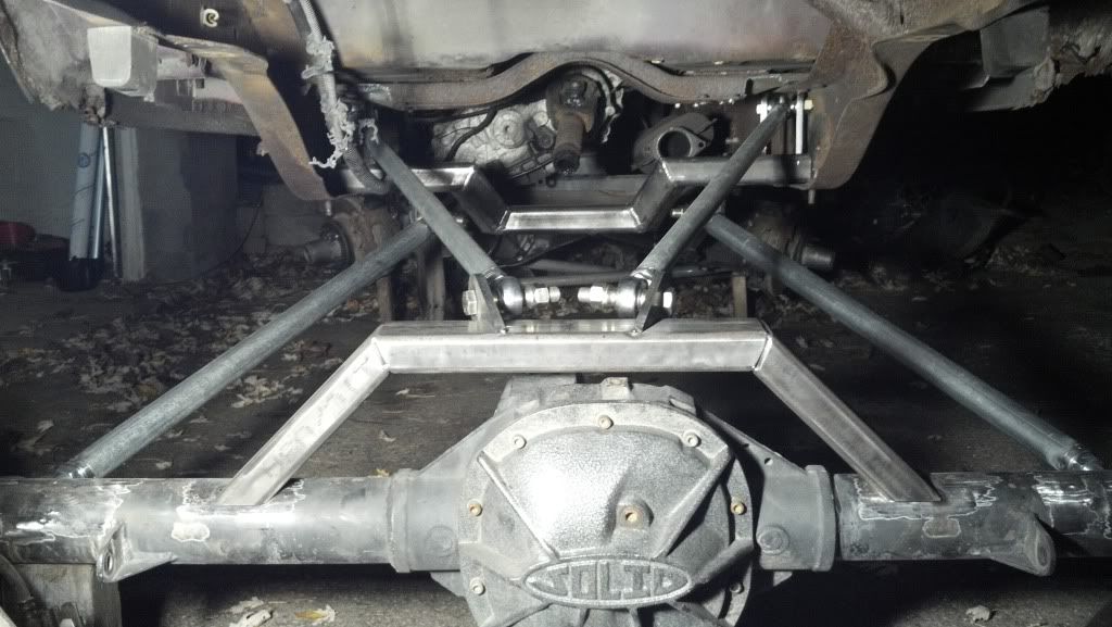

OK so I should have started a build thread here long ago and I dont know why I didnt.
1990 Bronco II with 2.9L V6
Front:
Trussed D35 TTB swap with 4.88 Nitro Gears and Limted Slip
Custom extended radius arms
Swinger Heim Steering
12" 2.5 FOA Coilovers and 2.0 2" FOA Bumps
Rear:
Double Triangulated 4 linkd 8.8 31 spline explorer axle with 4.88 Nitro Gears, spool to be added
14" 2.5 FOA Coilovers and 2.0 4" FOA Bumps
Streatched 9" from stock rear axle location
Full rear tub
Gas tank in trunk area (guna be fun)
Sure I missed some but here is a photo dump!
