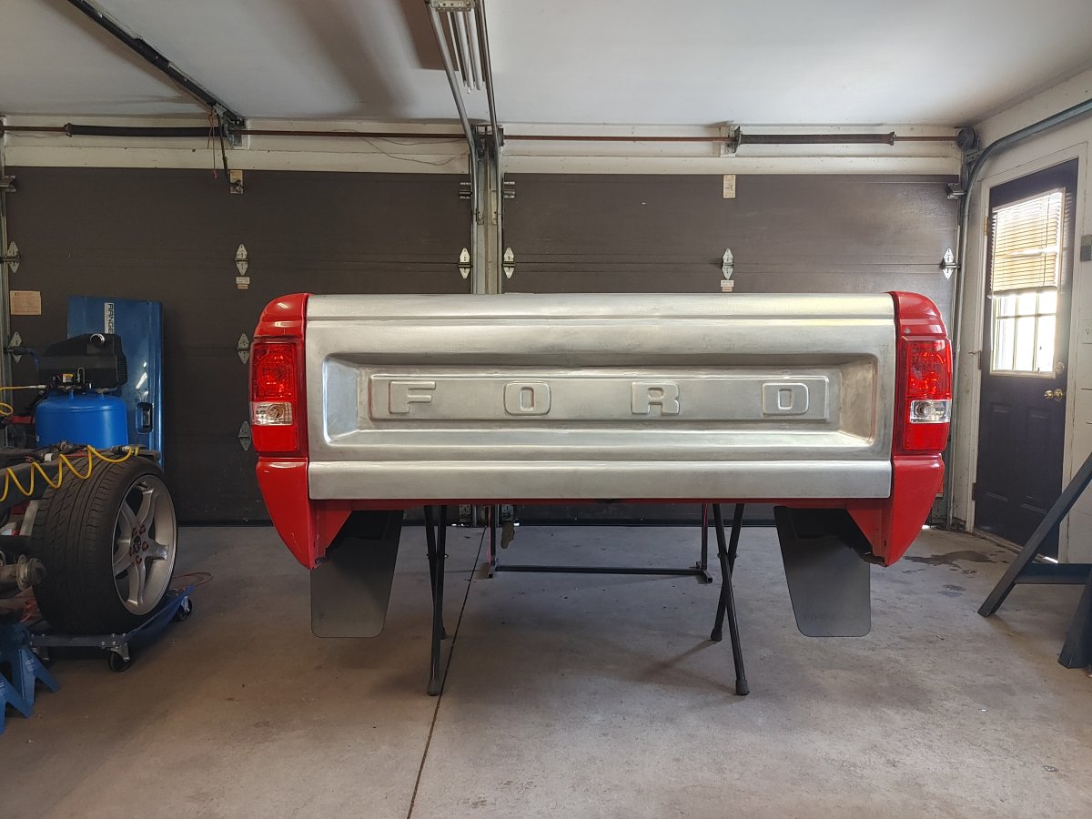

Got some more work done on the ranger, made a Roll Pan for it, also made a video showing a good chunk of how it was made to anyone interested
