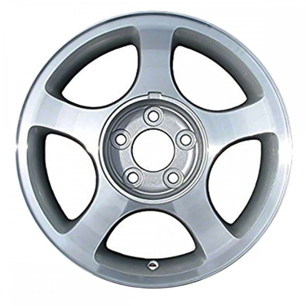

...these Mustang wheels have a 30mm offset and the stock offset for a 1999 Ranger is 55mm.
55mm = 2.165" 30mm=1.18"
...that would indicate to me that I need a 1" spacer.
Is that correct?
The wheels are available for $30. for the 4

Your math is correct...
I know mustang wheels have been discussed many times before... do a search and you should find a few threads that discuss what others have done.
stock offset on '99 Ranger alloy wheels is 12mm.
the 1" spacer is correct.

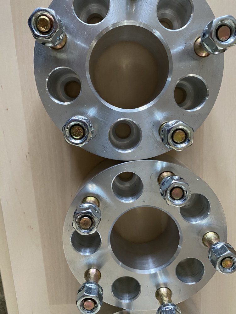

And this is what I used from the tire shop, custom made to adapt 5x108-5x4.75 51mm thick and 65.5 hubcentric. Use quality adapters. I know it’s not a ranger but something to refer to.

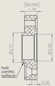

@cbxer55's adapters are in theory better than @Zmans as they are machined with lip to ensure the rim is mounted concentric to the spacer.

The theoretical minimum thickness for an adapter is 1" assuming 1/2" studs - that allows for 1 stud diameter of material inside the lug nut + 1 stud diameter of thread engagement. In practice 30mm is minimum to ensure for manufacturing tolerances and the hub studs will be below the surface of the adapter.
Ranger rims vary between 6 and 12mm offset depending on wheel width and year. The OPs Mustang rims have a 30mm offset. 30-6=24mm, so if using 1" adapters, the tire center would be within 1.4mm of where the Ford engineer designed for....close enough for practical purposes. 30-12=18, if using 30mm adapters, the tire center will be 1/2" wider than ideal, but only 1/4" outside of outer OEM limits. The axle limit would be reduced a little, so you would need to compare the reduction as a result of spacer versus the ultimate limit.
