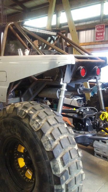

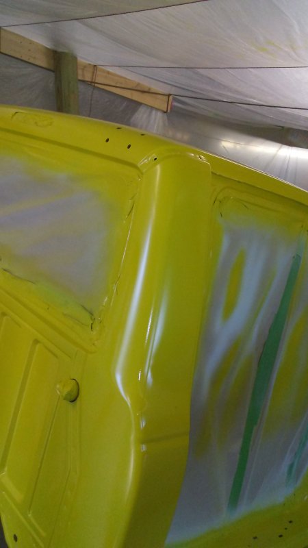

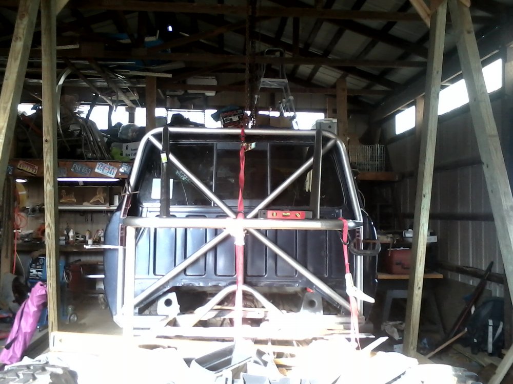

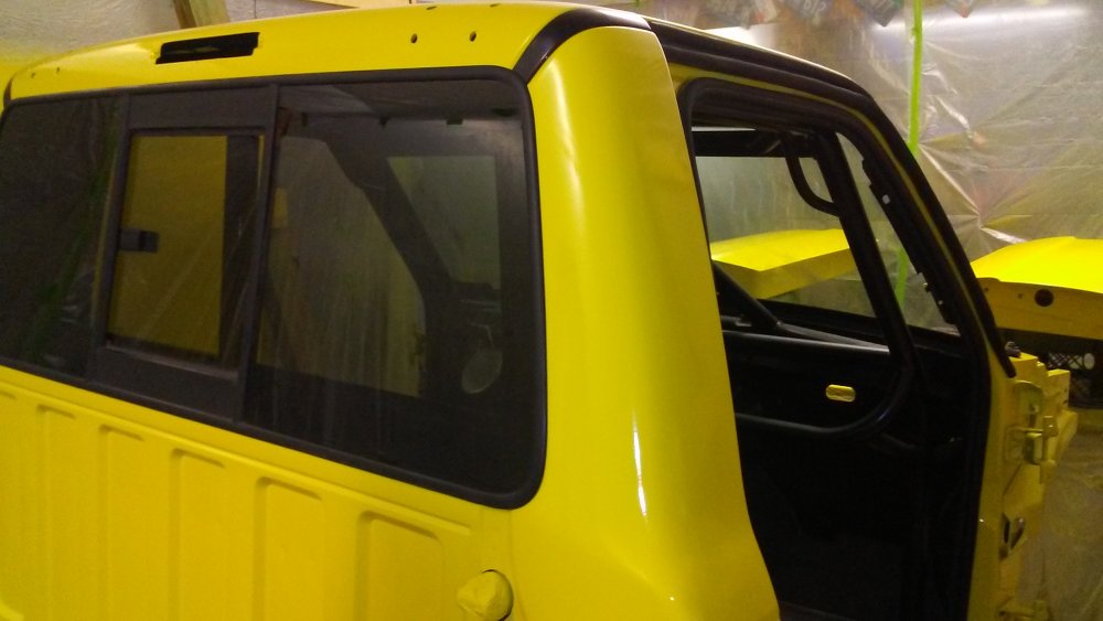

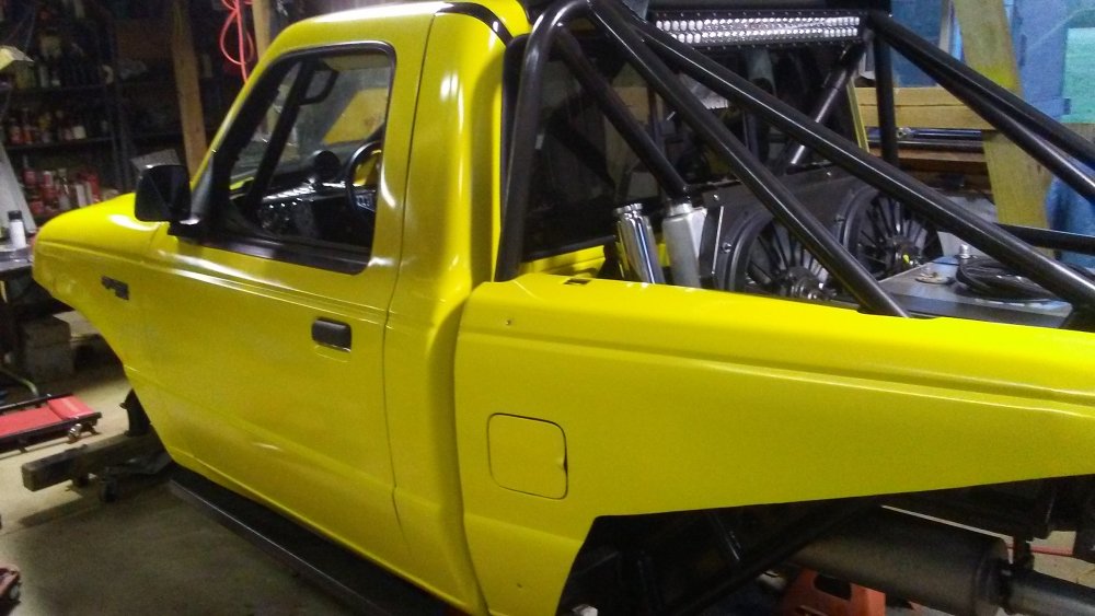

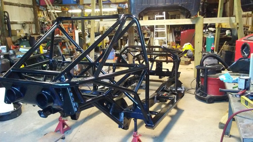

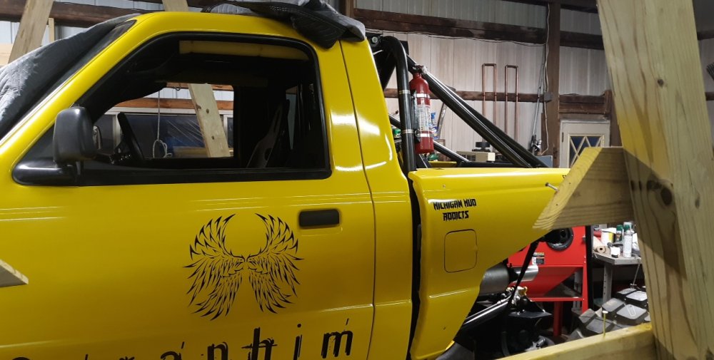

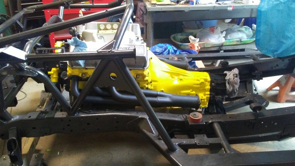

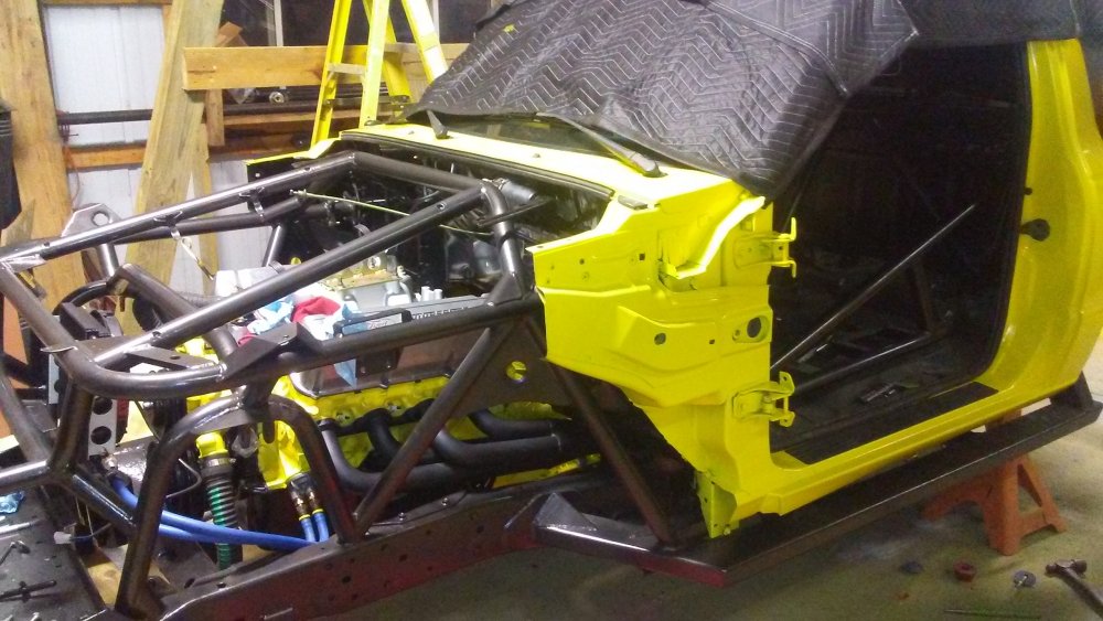

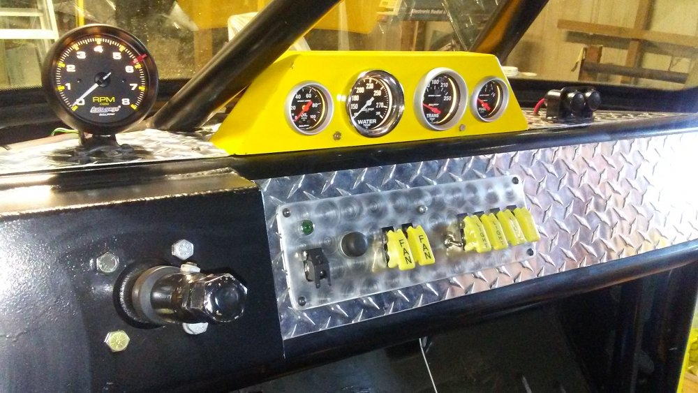

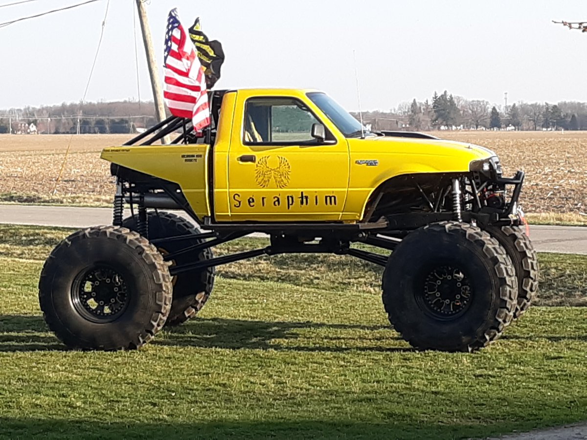

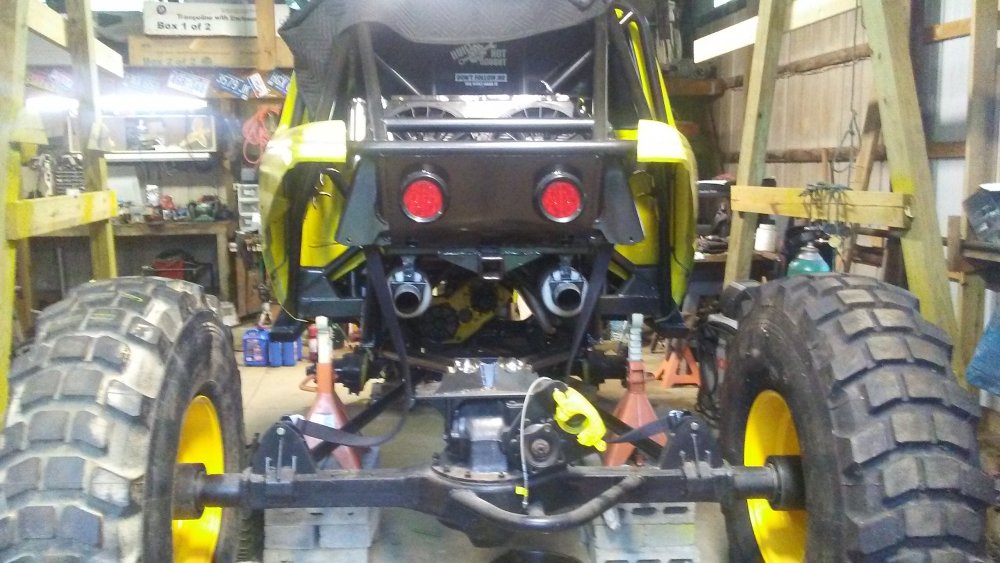

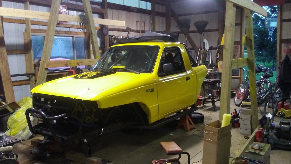

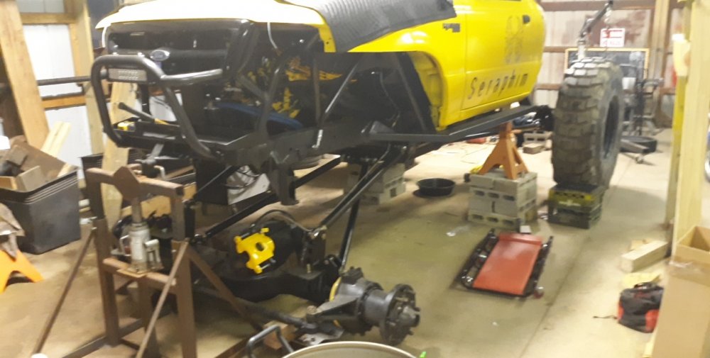

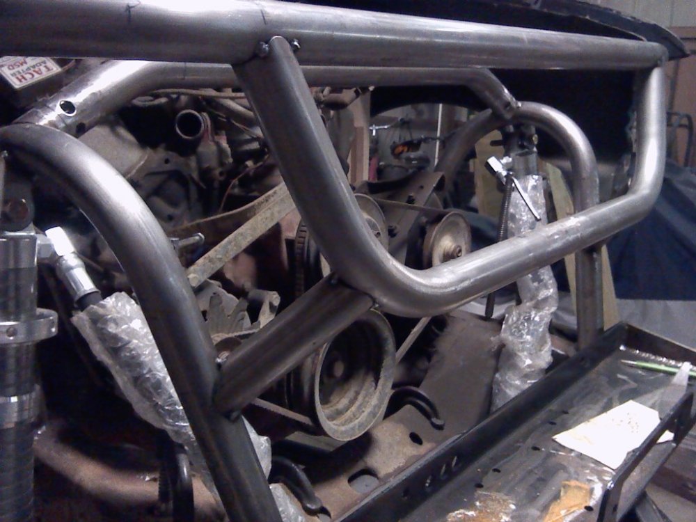

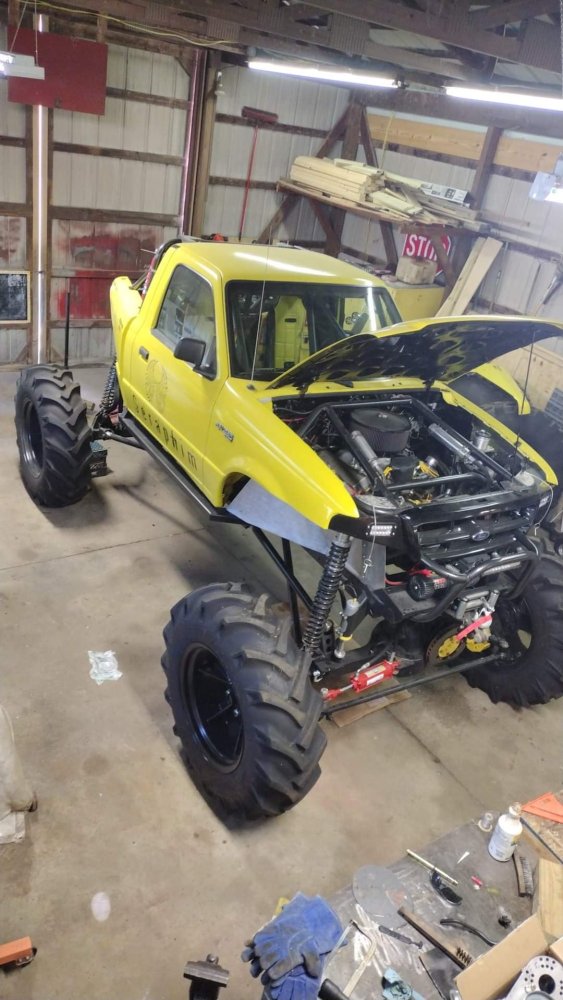

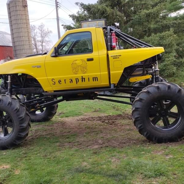

Started this build 11 years ago with my oldest son and now just about to finish it with my youngest son now it has come a long ways and it is truning out pretty cool we think. We have over 500 Pictures from the start. I post just a few.

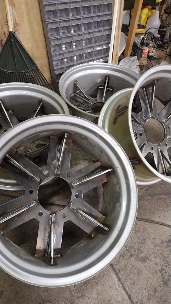

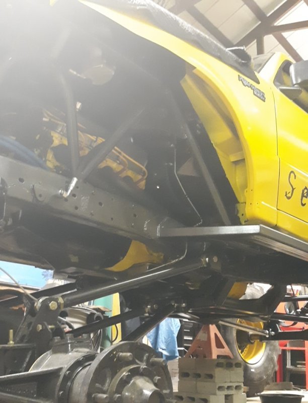

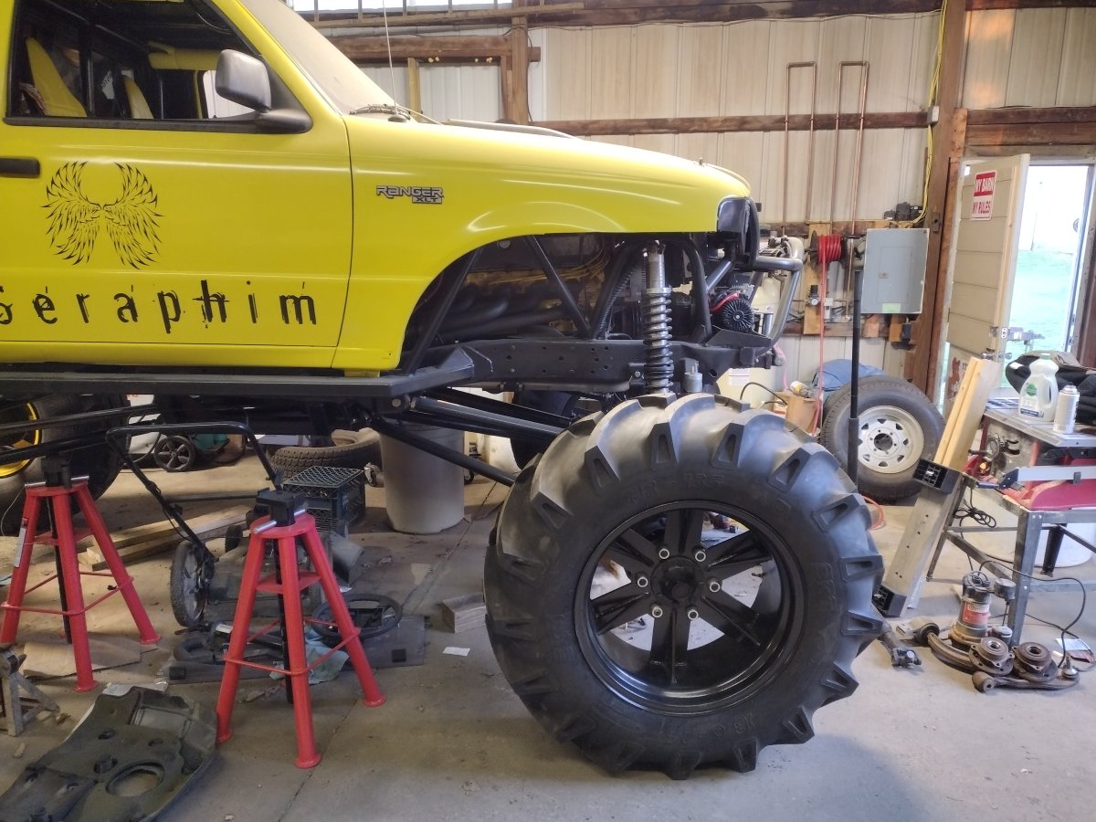

built new wheels and new tires

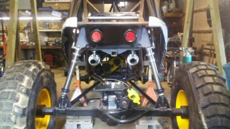

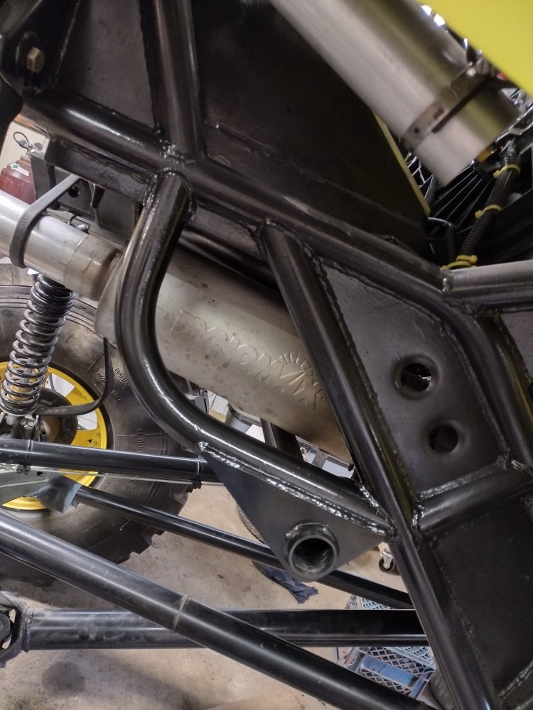

and we made up a rear sway bar set up, hopefully it won't be as tippy while driving,
One hell of a build man.
No escape boat?

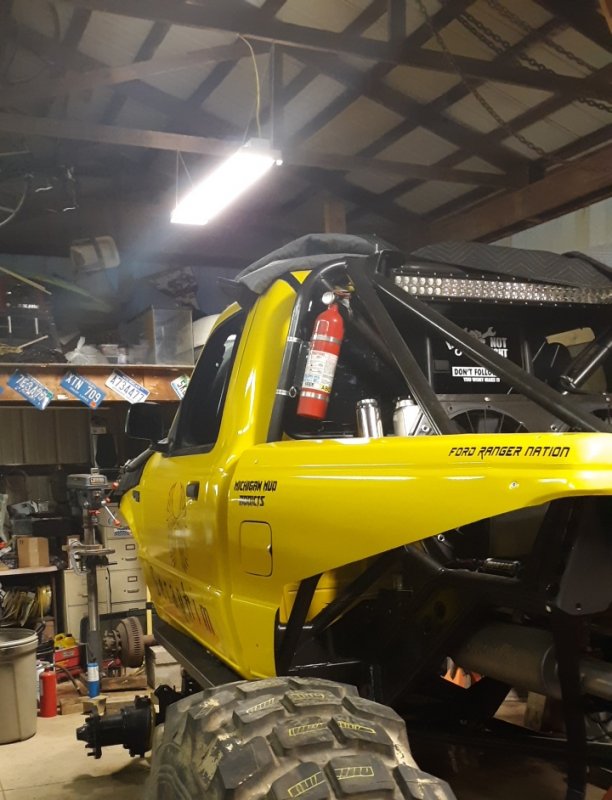

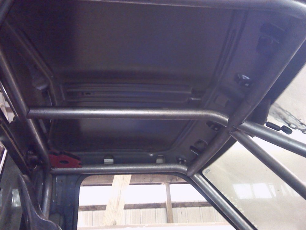

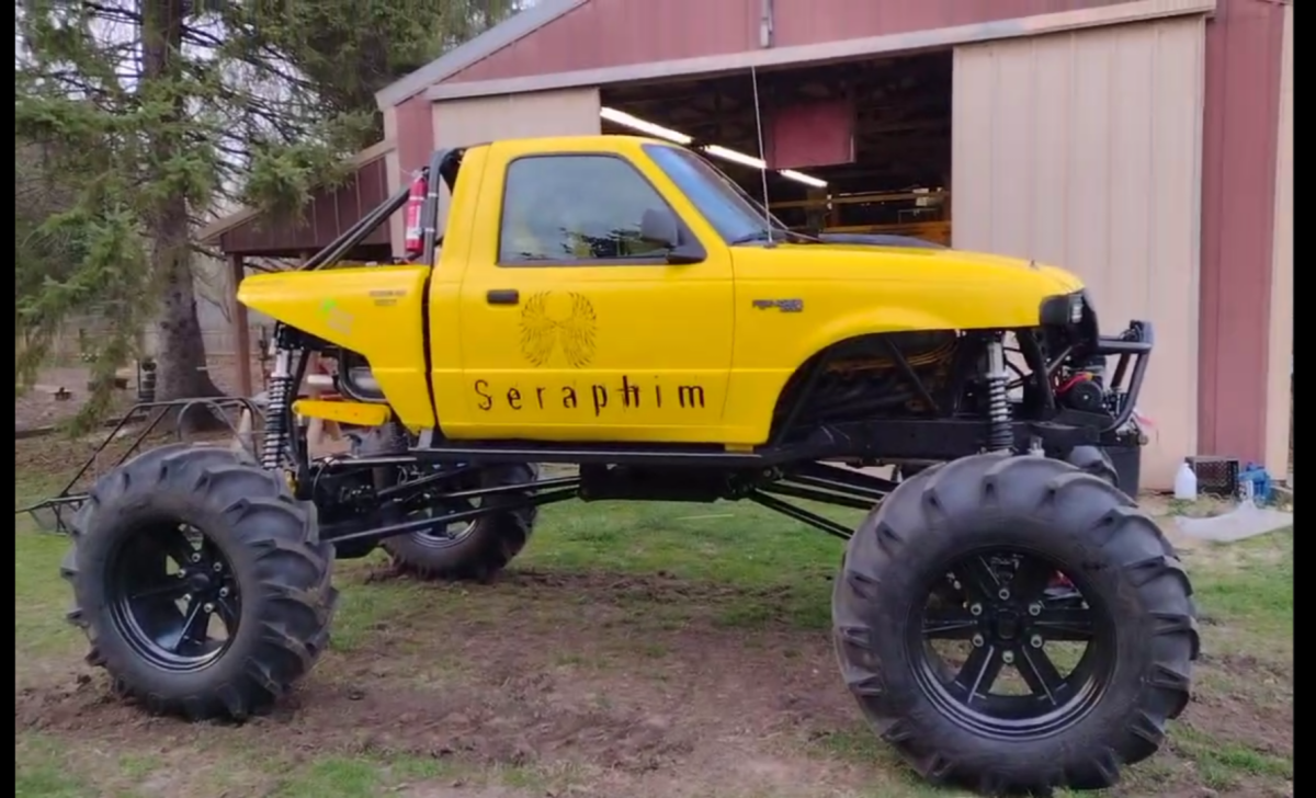

I probably should mention it has a 1972 BBF 460 .060 over 472ci. with Holley sniper EFI and ignition system to match, C-6 transmission, NP205 transfer case, 2.5t Rockwell axles full spool, FOA coilovers 16" travel full roll cage, 24 x 12 custom wheels 13.6-24 BKT tires. And a ton of other cool stuff, I built this with my 3 son's.
what a wonderful project....well done!
I don't think I've ever seen anyone make wheels before. It looks effective.
Do you have any updated photos? Any photos of it outside?

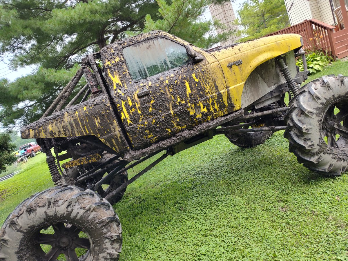

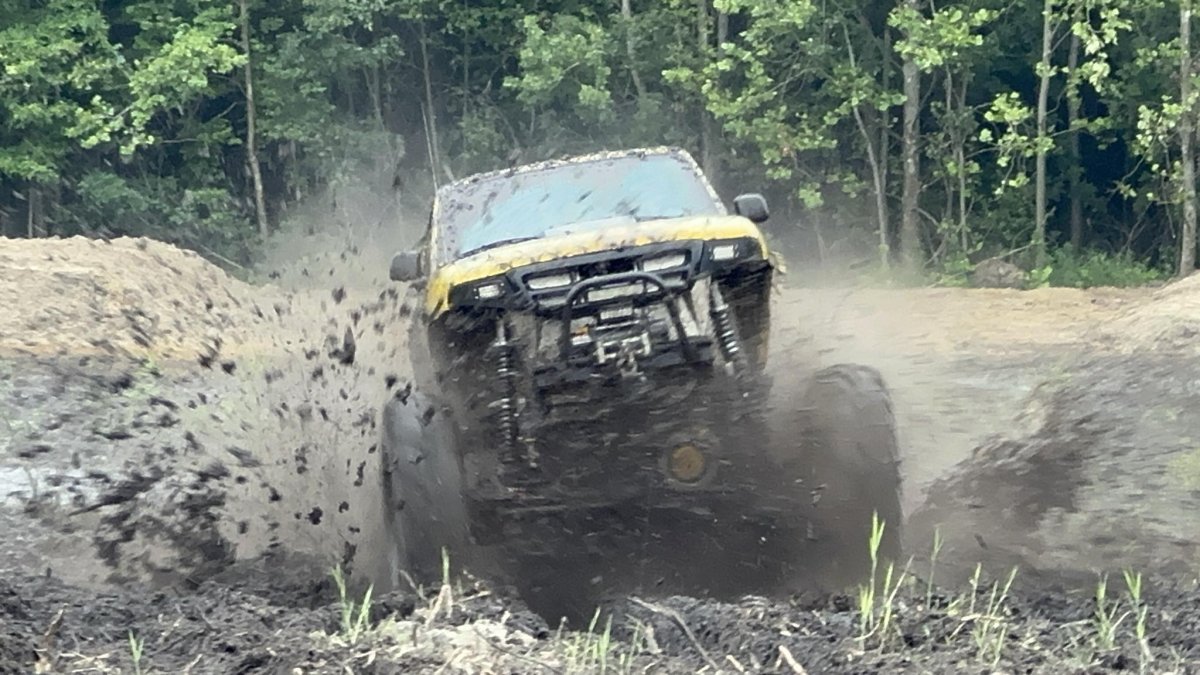

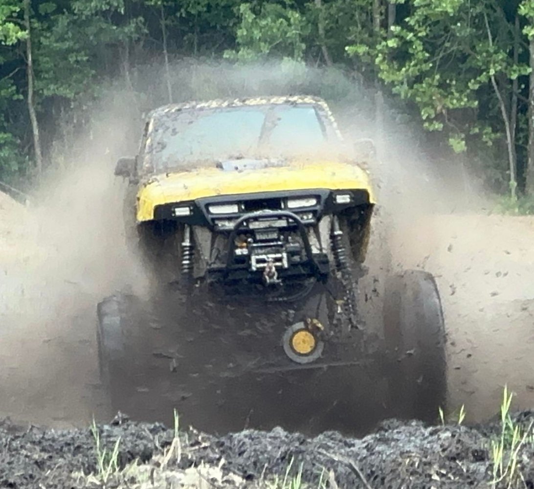

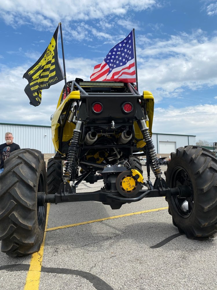

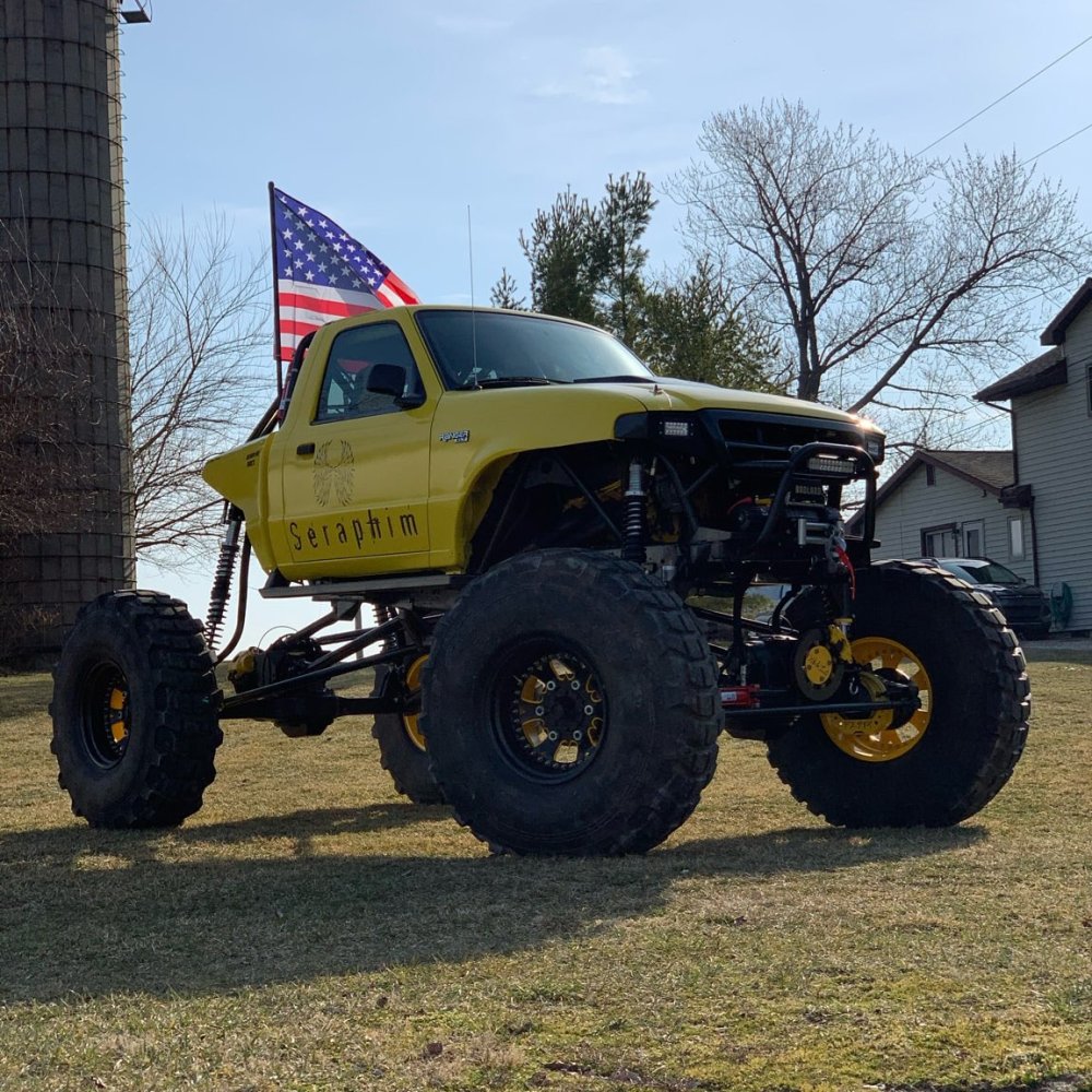

Went to a local mud bog today and had a blast the truck drove like a dream made about 15 passes in the pit it was great.
  • Mudtruggy 1999/1978
This was Friday at Milan mud jam 2024. Had a few bugs, but we got those worked out and it ran like a champ!!
