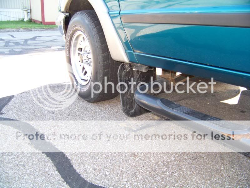

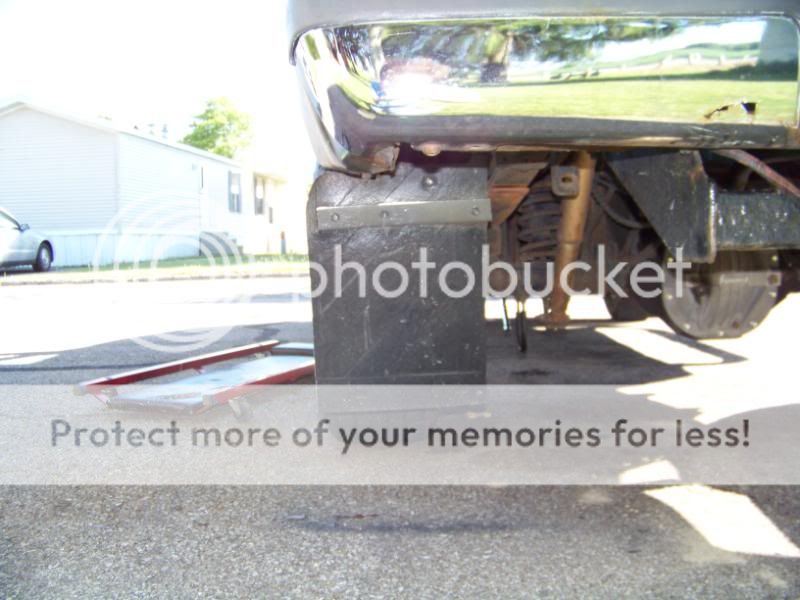

heres some i made out of a semi-trailer flap. rears are no longer on the truck but fronts are still there. only bad thing is i didnt take suspention compression into account when i made them, so when the whole family is in the truck the fronts drag at low speed. but the longer they are, the more effective. the rear flaps arent there anymore due to getting caught on a parking bumper when backing and breaking the the factory round-bar style mount. the fronts do more to protect the truck anyhow.
You know racsan, I was just going to mention about being careful with long mud flaps. My dad's 91 Ranger 4x4 had long mud flaps, till he got stuck and when he threw it into reverse, it tore one of the rear ones off. Luckily the mud flap gave and not the mounts, redrilled some new holes, good as new.
Most states have mud guard laws. Yes you can get a factory vehicle without them and be fine but there is a reason behind that. Here in PA and most others there is a formula to determine if you need mud guards. Draw a line 22.5 degrees upward from your axle centerline, if there is no body there you need mud guards to reach down to that line. One suggestion for eclipse though, trim that bracket back to the bodyline. If a cop wants to be picky he can nab you for a protrusion sticking out.
