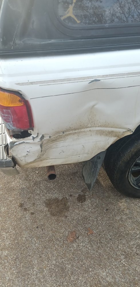

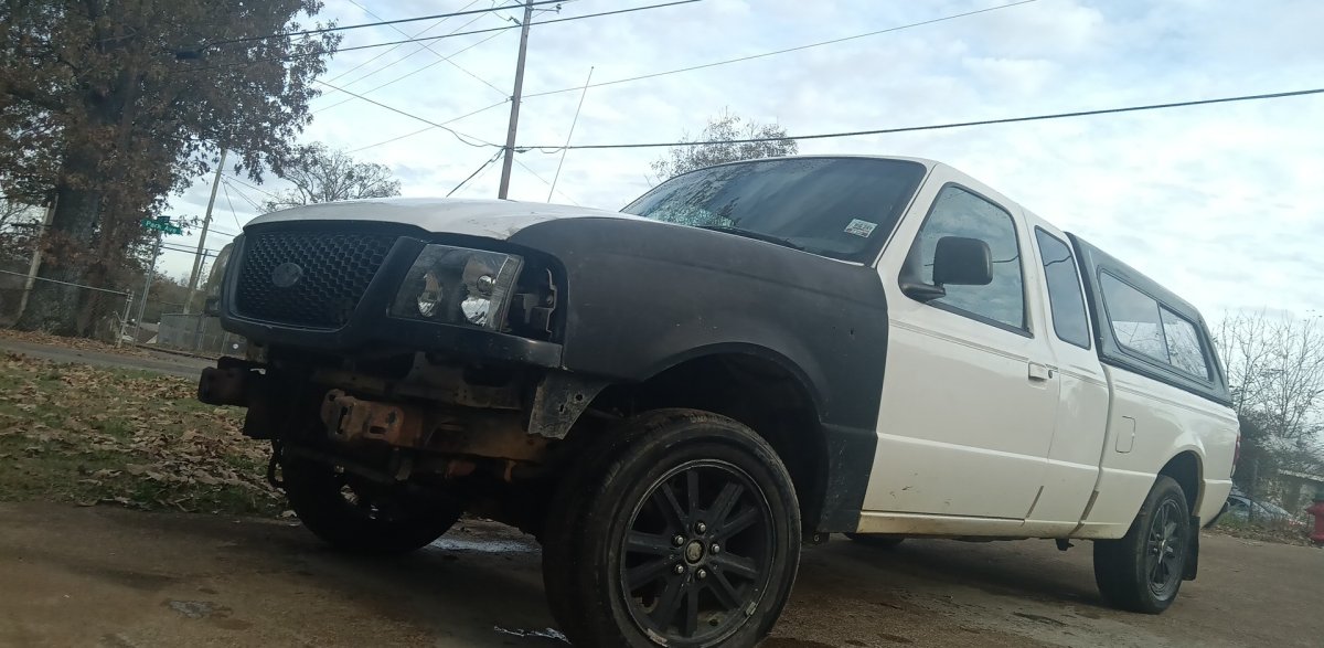

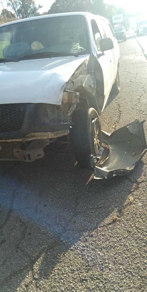

I've got a 97 ford ranger and a 99 Ford ranger.
The 97 runs and drives great but has major body damage, has been wrecked and has a warped frame, looking to swap the motor and transmission over into the 99, wanting to know if it's doable, and if so what will it take to do so. It's a 3.0 v6 motor so I know it's a good motor, looking to rebuild some parts when I swap just to make it stronger since it has almost 500k miles on it. Reason for swapping is because I don't have the money to buy a motor otherwise I would

Swaps are done all the time. The more that's similar between the two trucks, the easier it will be.
What engine and trans was in the 99 originally?

We can't tell you just how much work and money it will be with nothing but some exterior pics and very few details. If you can share more details about both trucks, then we can be more detailed in our responses. What I can tell you, is that the 3.0 has a unique bellhousing bolt pattern, so you'll need to take both the engine and trans from the 97. There were some significant changes to Rangers in general in 98 (new front frame sections) that could impact engine mounts, exhaust routing, and wiring.

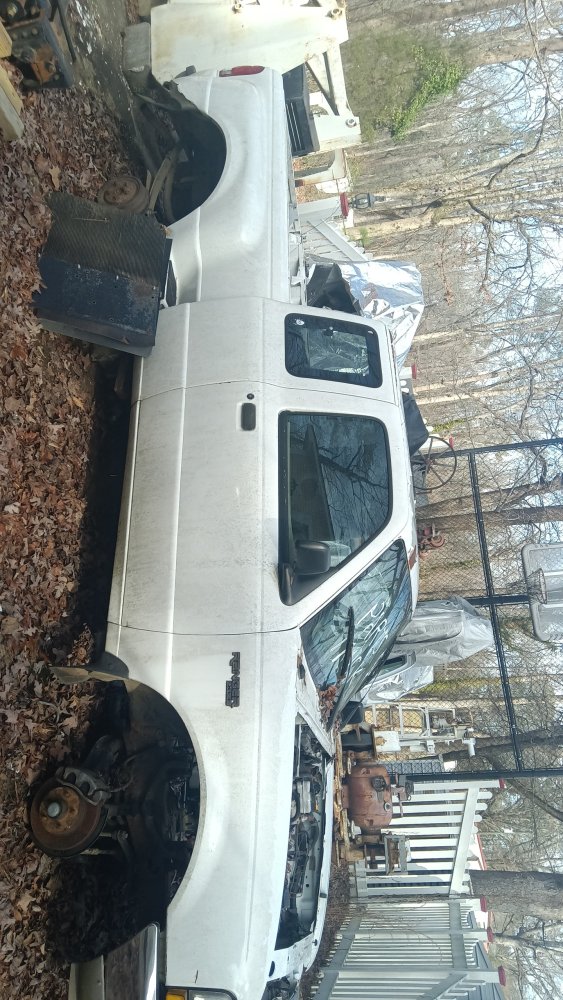

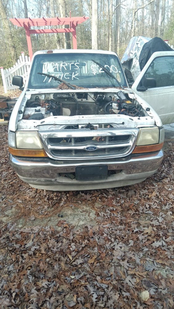

I'll take some more pictures including vin numbers and all for everyone to look at, but bottom line I'm more less trying to get the motor from the 97 since it's all worn out, warped frame and all. motor and transmission are still great and work like a dream just need a new body for them both which is why I bought the 99 hoping it would match up, but I feel the 99's bay is smaller than the 97's

Both transmissions were automatics luckily, and 2wd. Both trucks ran the same way pretty much, just idk about what size motor or trans was in the 99, if there's a easy way of finding out for both I'm open to listening as I've never actually owned or worked on a ranger before.

Take pictures of the door (federal) sticker. We can decipher them for you in matter of moments.
The size of the engine bays should be nearly identical. They put the 3.0 in Rangers until 2009. There won't be any issues with physical size.
There's a pretty decent chance that the 99 had a 3.0 or 4.0 originally (extended cab 4 cylinders were uncommon).
Ideally, the 99 would've had a 3.0. Then you can keep the 99 PCM and wiring in place and just switch over the engine. Things will get a bit more involved if the 99 wasn't originally a 3.0, but still doable.
