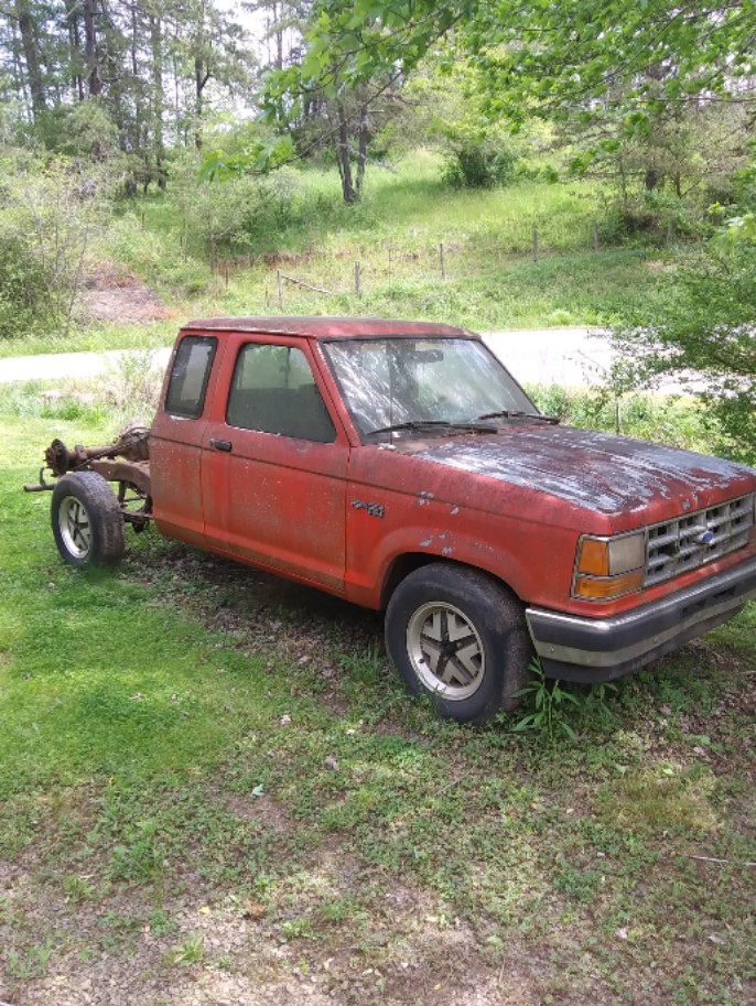

Thanks. I have a '90 parts truck. It's an ext cab, 2.9, auto, ps, pb, a/c and cruise. It sits very high off the ground and still has room left with 235/75/15 tires. I can't imagine my standard cab, base model truck with no options weighs more than the '90, even with the V8. I want the front to be stiff but I don't want the truck to sit higher in the front than the back. But I only have 165/15s on the front and they almost rub the fenders so i have to pick something. The best I can find, my 2.0 springs are rated just under 1000lbs.

Most likely the original coils in the '90. Everyone thinks it's a 4x4 with all the ground clearance it has. I may just use those coils. I think I'll have to take my front sway bar off on the '87 to get the beam down far enough and it was a mother to put on.
