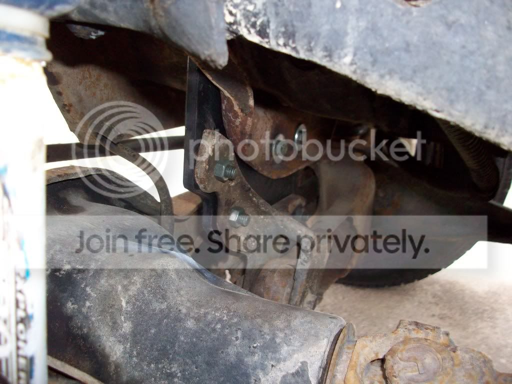

Has any one been able to modify the Rough Country Plate Drop bracket so that it doesnt puncture the diff?...any pics also...wondering if there is a way to make it work instead of buying a different bracket by cutting/welding/fabing

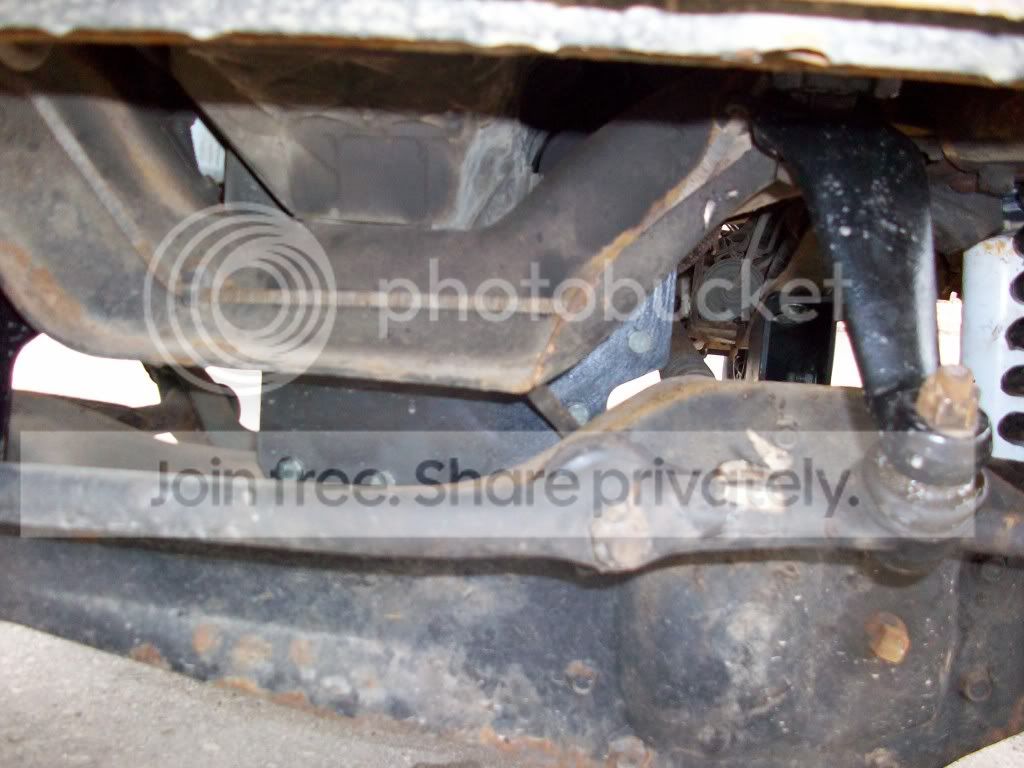

i think its the older one...ill get some pics tomorrow but i have about 2-3" inbetween the bracket and the diff sitting on flat ground....
heres my bracket...
Old plate used at template to make new plate from 3/8”. Used old bracket as large “washer”. Also added a few reinforcements as I thought needed.
