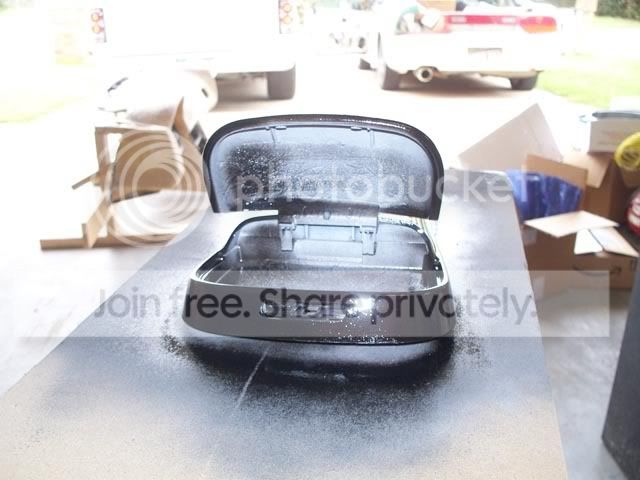

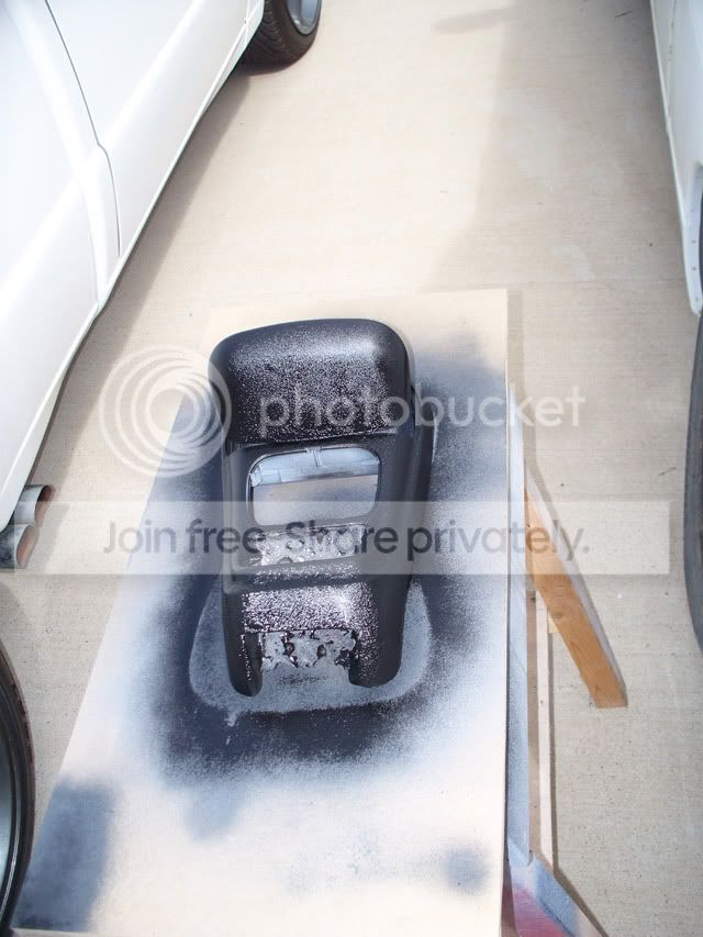

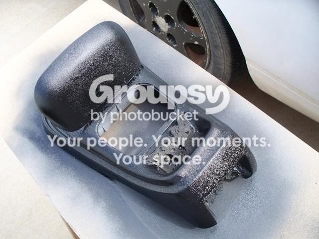

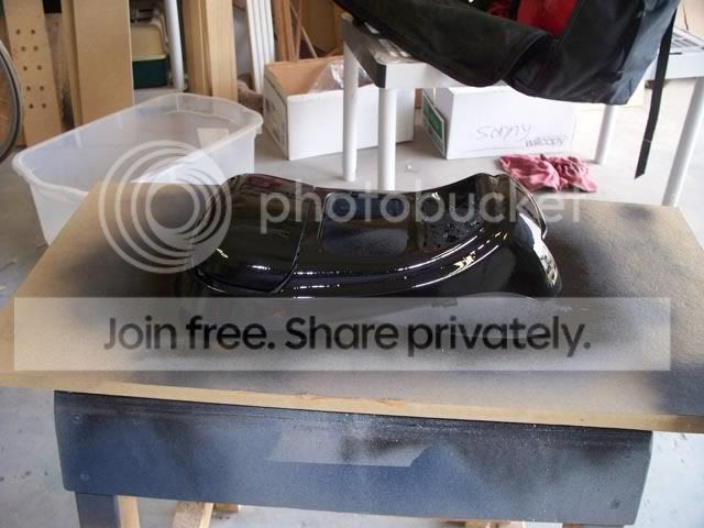

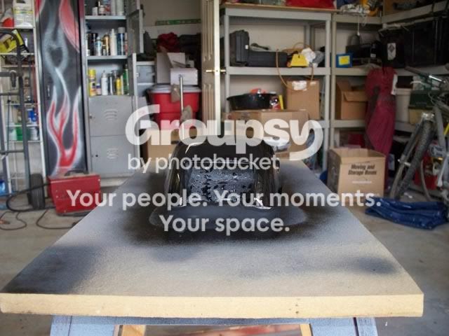

The remote pocket was also modified, I removed the remote actuator button and FG'd it smooth. Here are the final pics after I sanded, primed and painted with VHT Wrinkle Finish paint.
First coats are still glossy - not wrinkled yet.

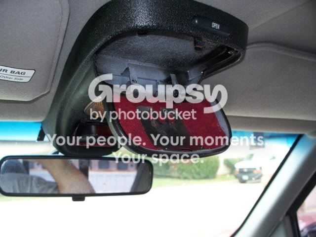

Inside the Remote Pocket
Dried and Wrinkled

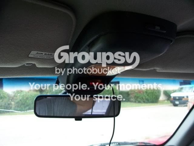

The detector pocket and the remote pocket will both get lined with a soft material like felt to protect their contents. The detector will just slide in with a little push (sleeve holds it snug) and the power cord will be run directly to the fuse box, I ordered a special straight cord from the mfr.
Now no one can see my detector when it is on tempting them to follow me on the highway instead of buying their own damn detector - LOL.
