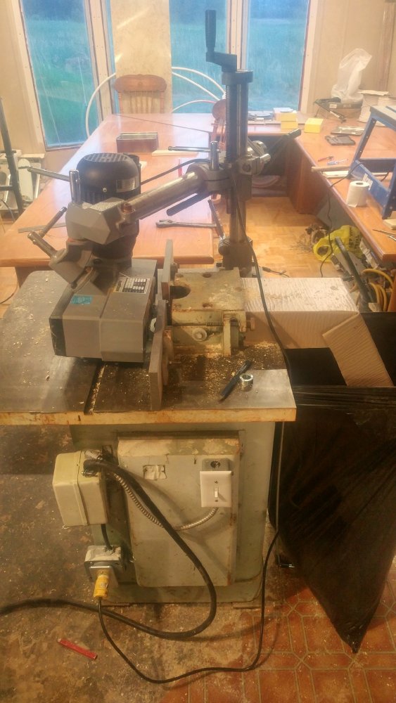

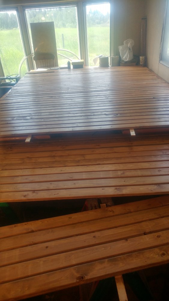

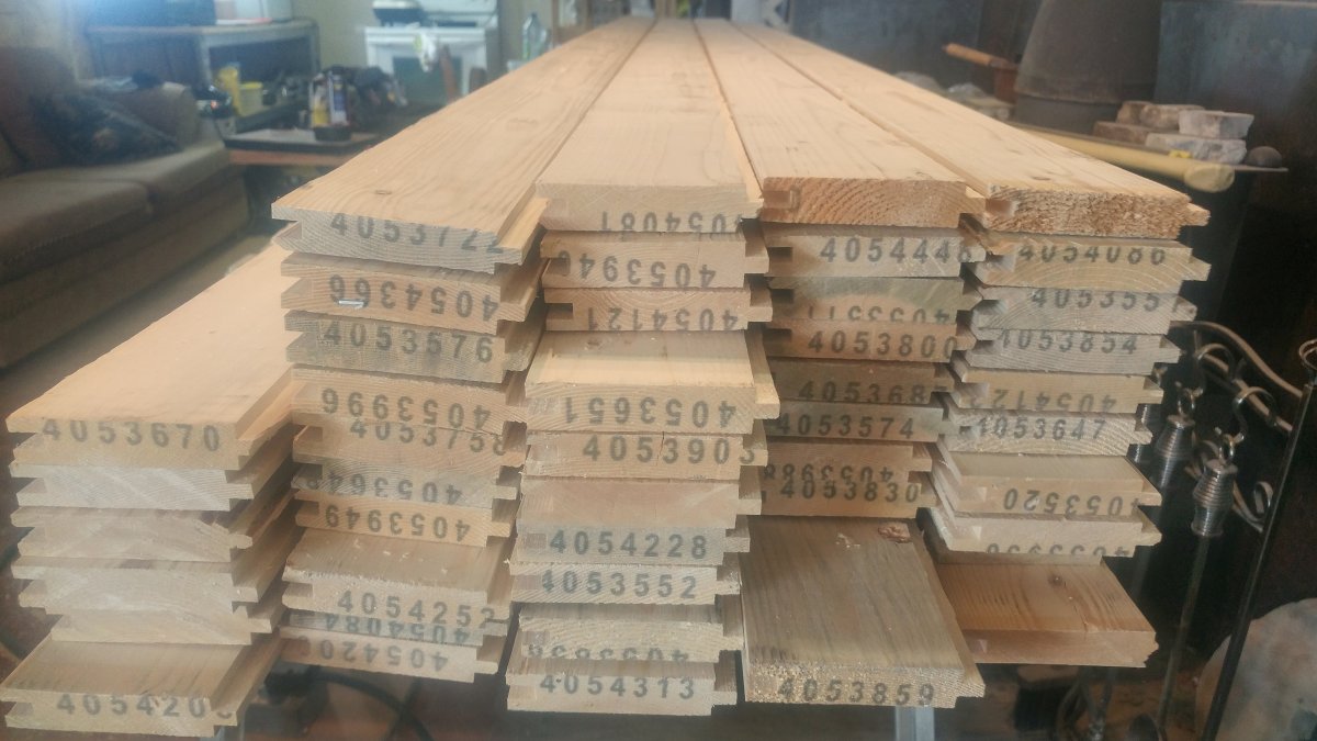

I bought a used industrial router table and a new power feed for making tongue and groove. The table came with several bits that added up to more than the cost of the machine itself. Iirc i paid $750 for the table and $1,200 for the power feed. Paid for itself the first job matching siding on a 1905 house.
